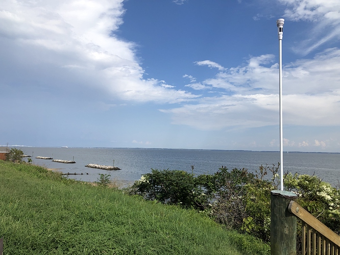

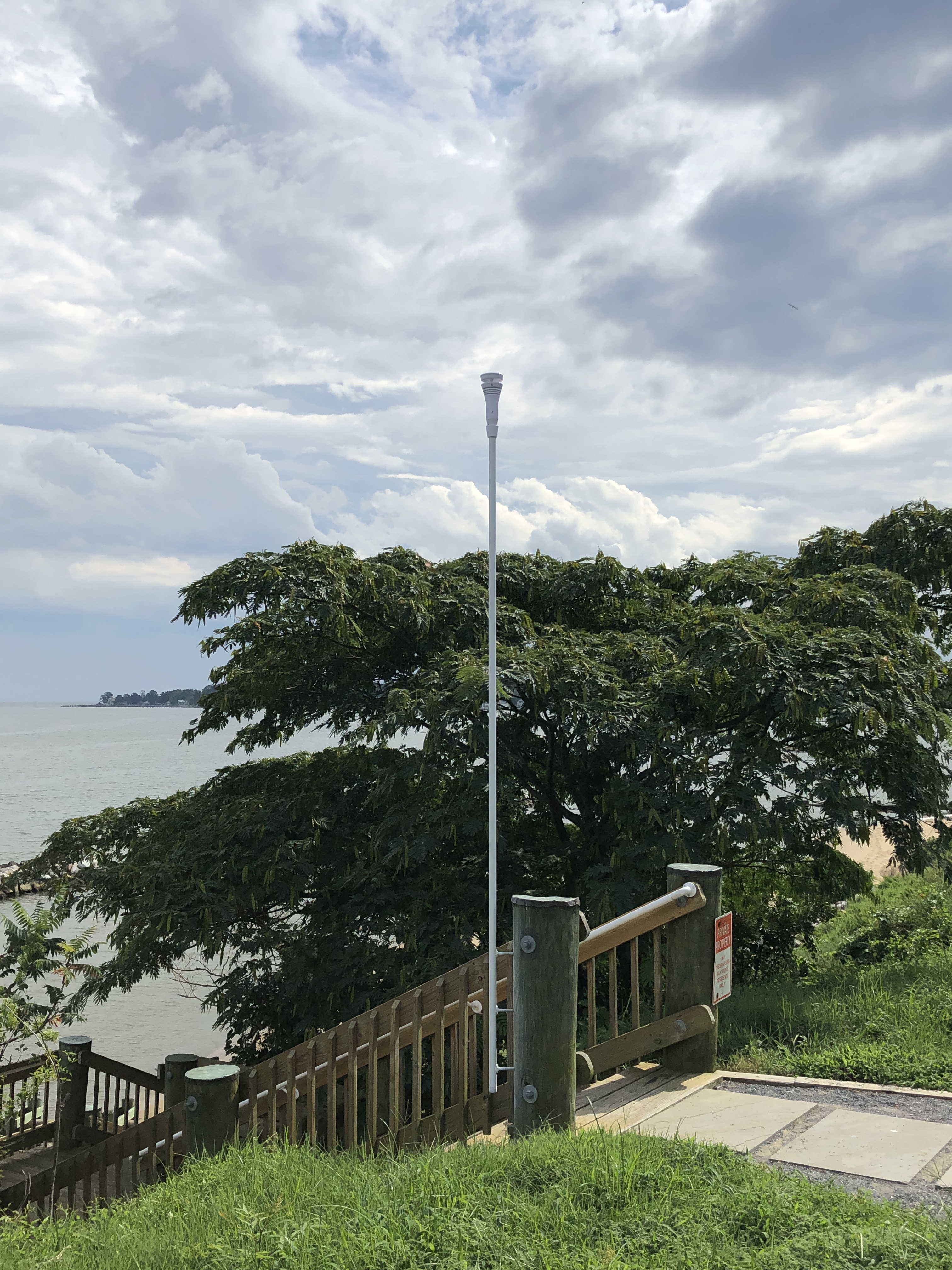

Current AIR and SKY owner with a new Tempest installed now as well. I placed the Tempest near the beach in a different microclimate than my backyard SKY and AIR devices. I expect cleaner wind, less humidity, and fewer “heat island” effects in this location, but am looking forward to comparing the data between these two sites that are only a few hundred feet apart but feel vastly different.
The tempest is mounted to a 1" x 10’ SCH 40 galvanized steel pipe welded to a series of lag bolts embedded in a large wood piling. This arrangement allowed me to get the pipe perfectly plumb and discourages tampering, since this is in a semi-public area. Time will tell how this arrangement works.
Station ID for this one is 27083. My back yard station is 2554.
