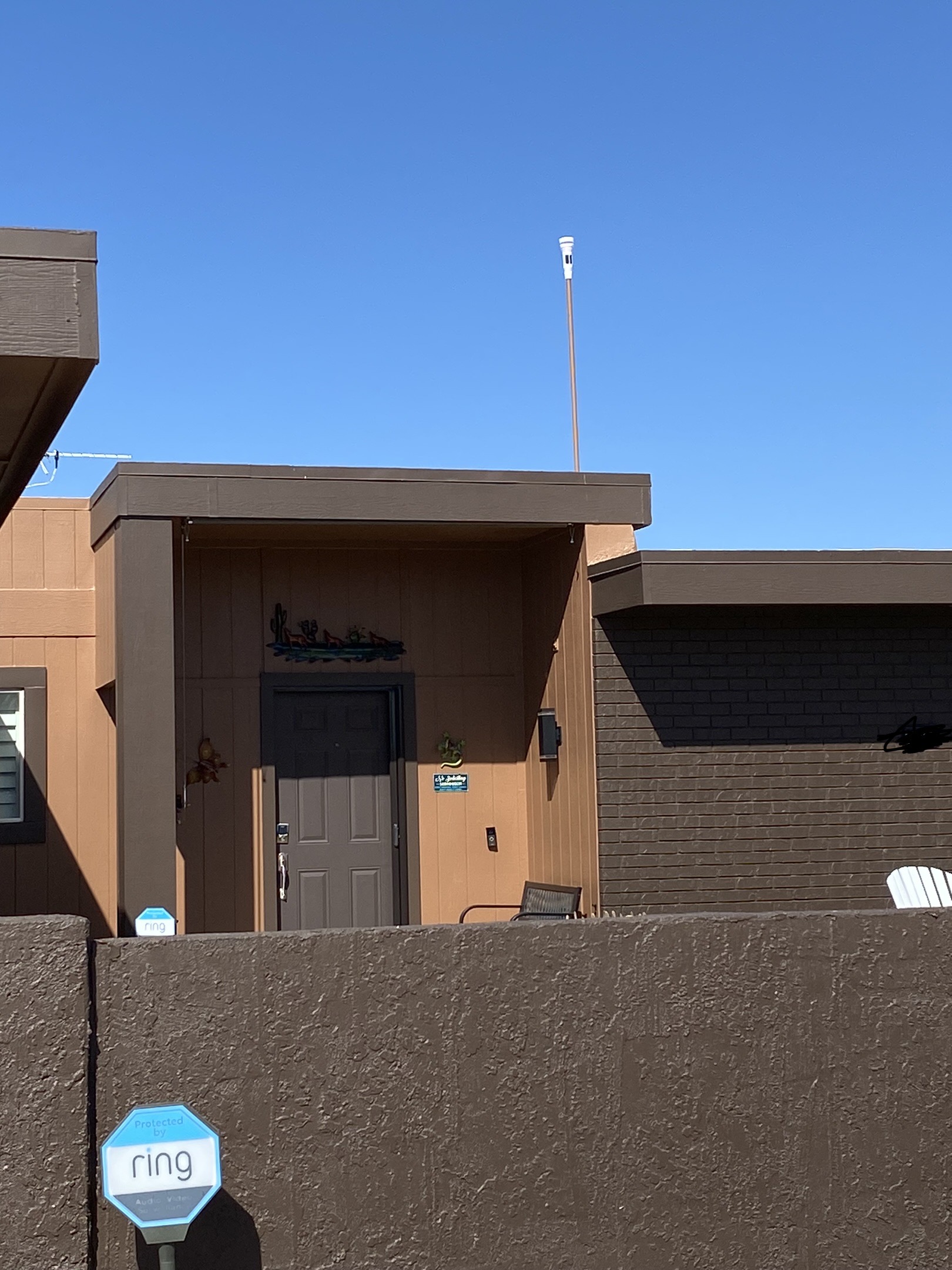

Got my Tempest today. I’m an over zealous researcher on anything I purchase, I’ve been wanting and looking for weather stations for years(high end) and finally decided it was time. After narrowing it down to Davis, Acurite, Ambient, or Tempest and expecting to pay $500-$700 I obviously decided on Tempest.
I love how easy it was to get up and running. I purchased the recommended schedule 80 pvc, expensive and hard to find around here. I filled it with sand for stability and mounted it on my roof approx 6’ above roof surface, flat roof home. Used three metal u brackets and screwed into a raised portion on the roof. I’m still a bit concerned about vibration issues but guess time will tell if this is an issue.

Update: due to the pole movement I sandwiched the pvc between two 2X4’s no more movement issues.
