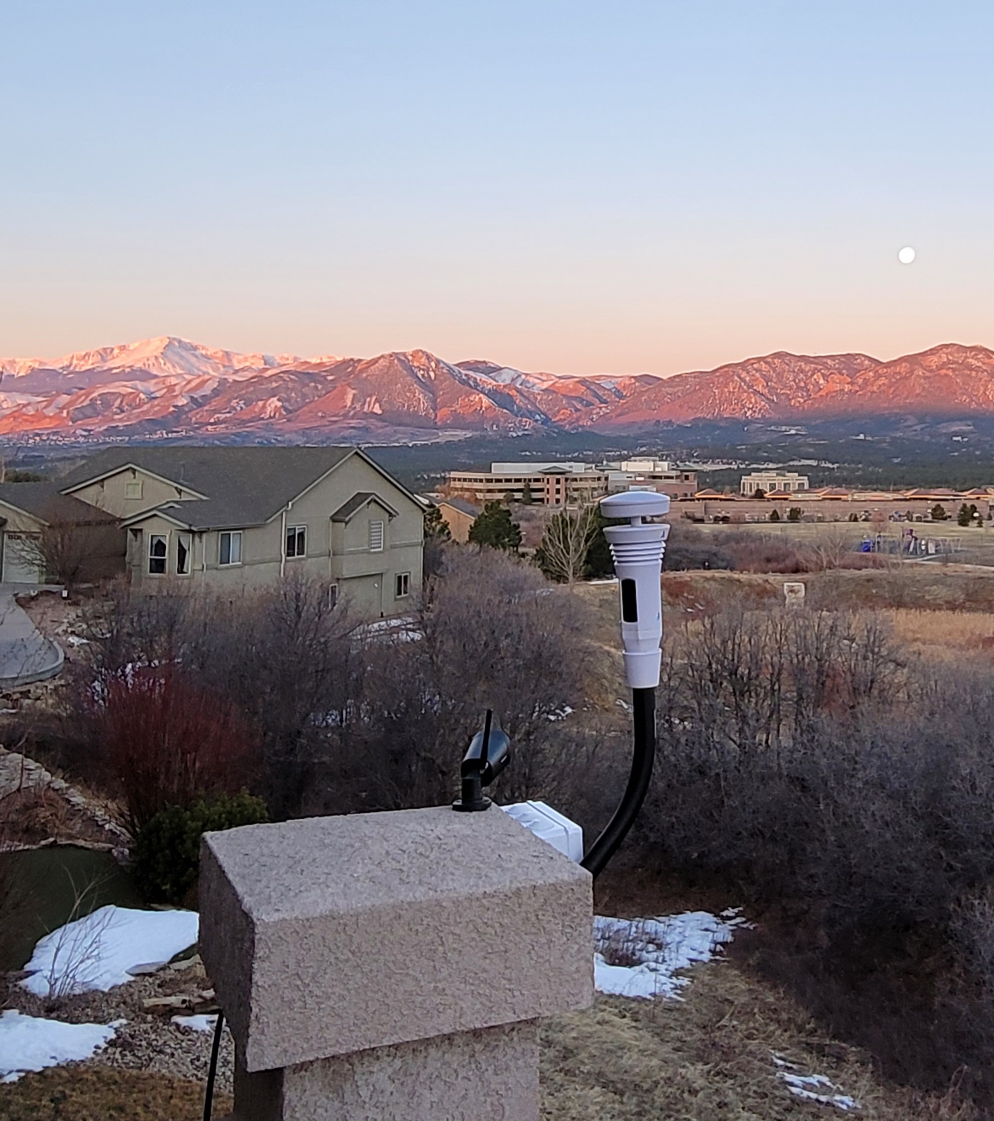

Colorado Springs, CO. Pikes Peak to the southwest. Foscam G4 for the weather cam linked to Weather Underground.
Weather cam view (sometimes you get a “moonset” over the front range):

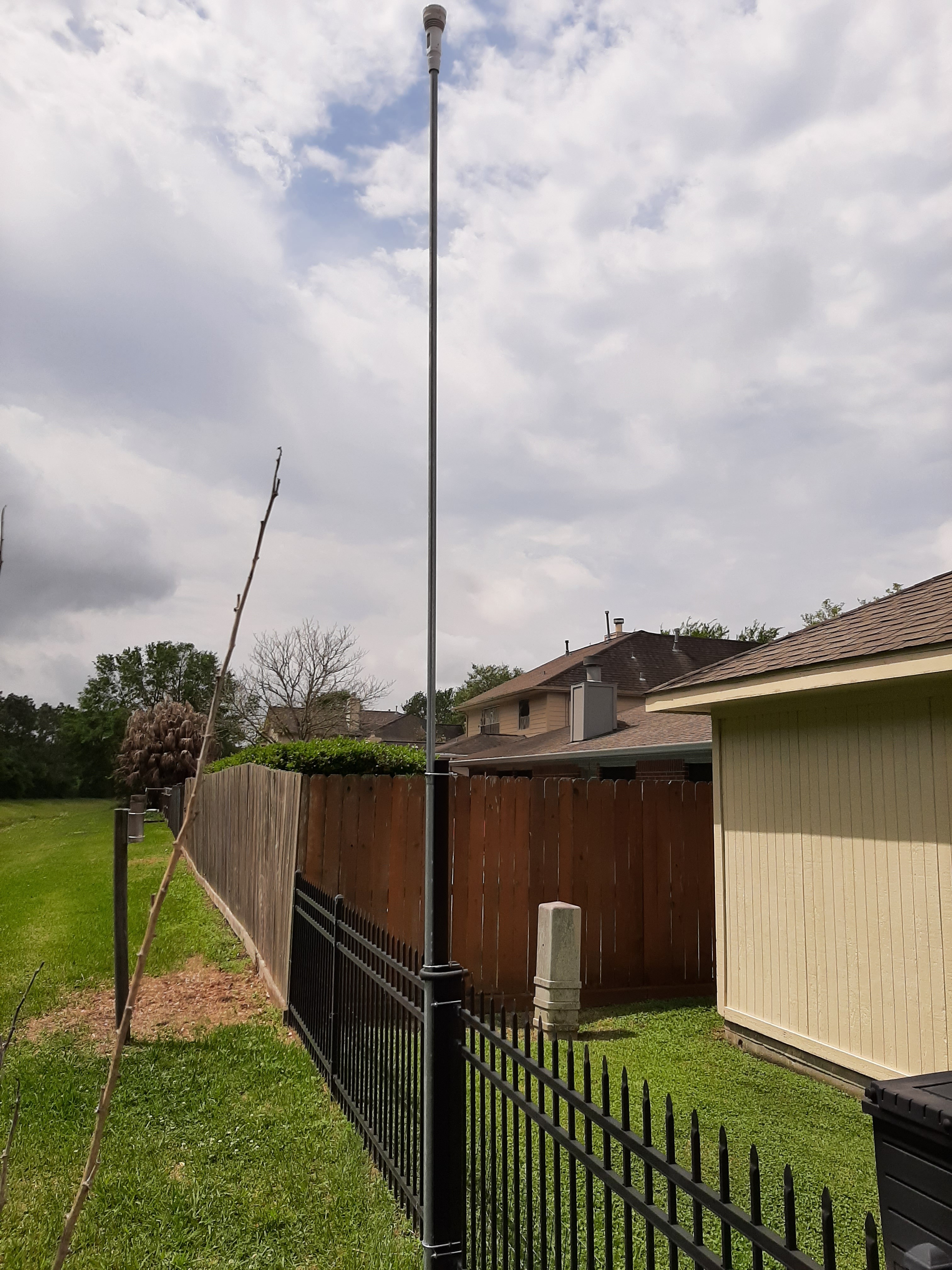

Current temporary location of my new Tempest and proposed final location once I decide what type of pole to use. Considering either 8’ vinyl covered closet rod or 10’ 6” chain link fence top rail. The fence I am attaching to is mine. Neighbor’s garage is on the other side. This is not a good location for accurate wind reading but it is the best spot I have for any rainfall measurement. Planning to simply zip tie the new pole to existing fence pole. Would either pole option be more susceptible to false rain detection and more importantly require grounding. I wasn’t planning to bury the new pole but could if necessary. Thanks.
The fencing might induce vibrations into the pole causing false rain. I don’t think you’ll need to worry about grounding.

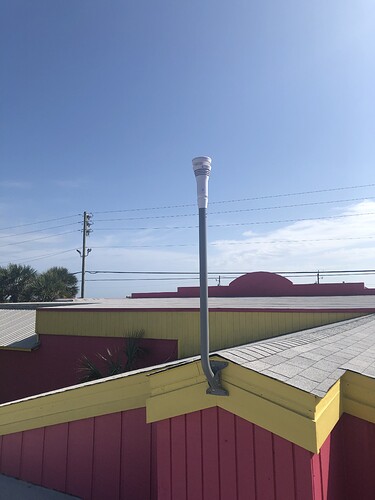

Got my replacement unit installed yesterday at PCB. Also mounted it on a sturdier mount and away from possible turbulence caused by the roof’s shape.

Our tempest installation yesterday, working perfectly and installed easily.
What is the flat piece under the Tempest for?
I’m going with…bird perch so they don’t sit on the Tempest…
Flat base mount because the pole didn’t fit?
Just to provide another possible reason…A sound absorbing product to reduce vibrations to the Tempest :wink:
My mount is similar using a horizontal timber plank which allows multiple Tempest and cameras to be mounted and also reduces the vibrations from a very noisy pole.
