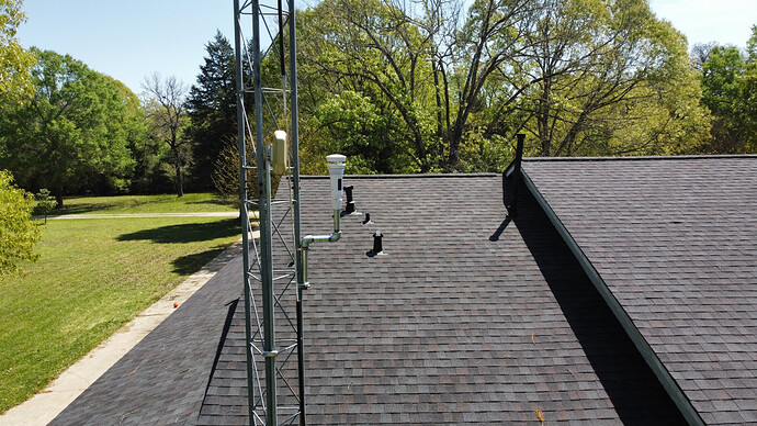

Similar hardware setup on both stations except one is on a pergola(in MS) and other on a antenna tower(In TX). Mounted on a 1" galvanized pipe about halfway up a 50ft tower. Sticks out about 8" from the tower and about 4 feet above the roof peak. I feel I may need to have it stick a little further out from the tower but so far have not noticed any wind direction issues. Have bird perch deterrent for both just have not installed on tower one yet.

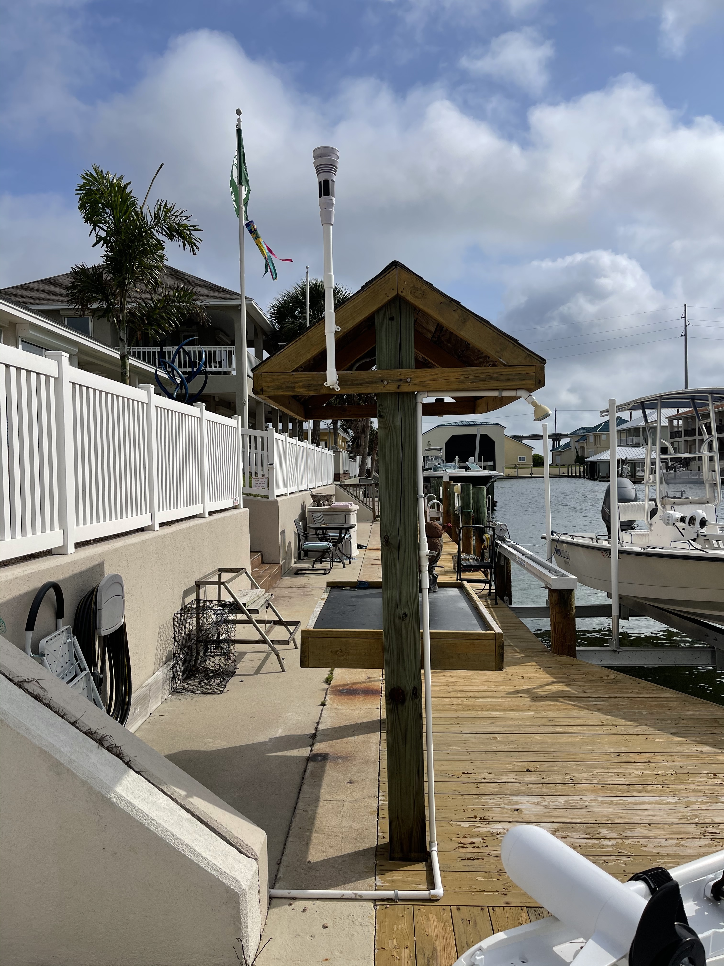

Brand new to Tempest!
Here’s my install, on our fish cleaning station. I suspect proximity to the canal might influence humidity, but humidity is a fact of life on the Texas gulf coast…
https://tempestwx.com/station/48708
Welcome! Looks Great! :+1:

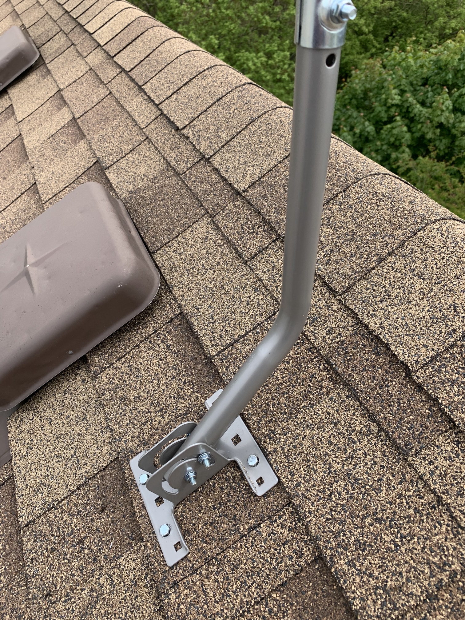

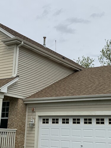

I finally moved my station from a 10 foot pole on my patio to the roof at 31 feet. It is now on a modified antenna/weather station mount. This should give me much better wind data because there are much less things blocking the wind. It should be far enough from the roof to not impact the air temperature.
Looks great. FWIW, my son, who is a roofer, said you are going to have a leak under that bracket after a while. It needs to have sealant under it and then bolted down so the sealant squished out from under it.
Thanks for letting me know. I plan on putting the sealer there in a few day. I was reading the container and it said it needs a few days to set. Rain is on the way for the next day and half.
