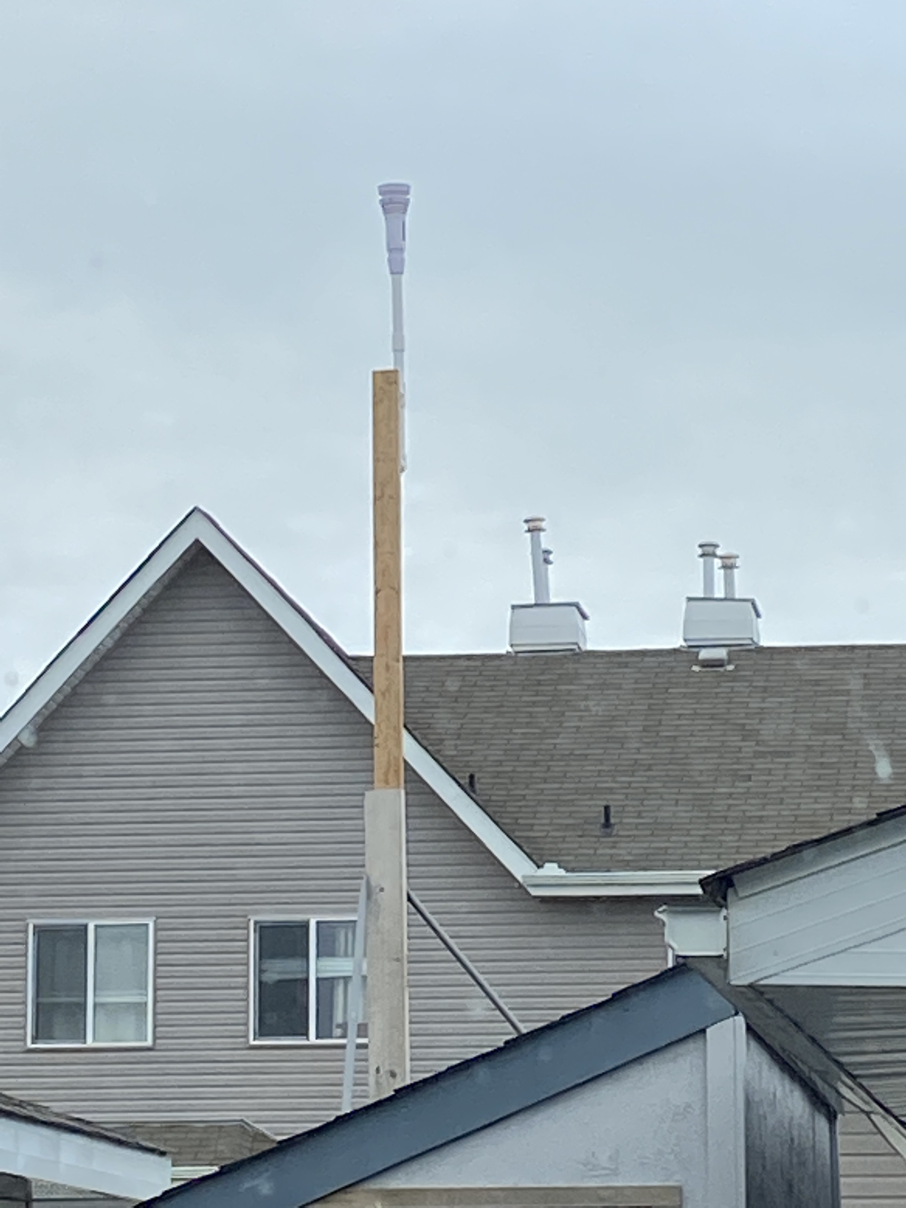

Good morning all, I have a question about my set up, it’s great, good wind/temp. However in the 30-50km/h hour days it reports false rain due to the vibrations.
My question is, is there anything I can do to reduce the vibrations in the pole?
weird as it is mostly wooden beams and those pretty much don’t produce any vibration, so most probably the upper pipe. Is it hollow ? material ?? maybe try like other to fill it with fine white sand … this has also a dampening effect and worked for several.
Yes that is what I am assuming that is causing it. Yes it is hollow as it’s the one from the Weatherflow we site. I will look into the fine white sand and might be able to fix it today. Now we just need WF to give us the the ability to fix the false rain haha.
Thanks @eric
Making it too rigid will cause short stroke vibrations that can excite the piezoelectric element. It should sway gently, the swaying produces much lower frequencies and you won’t get false rain events.

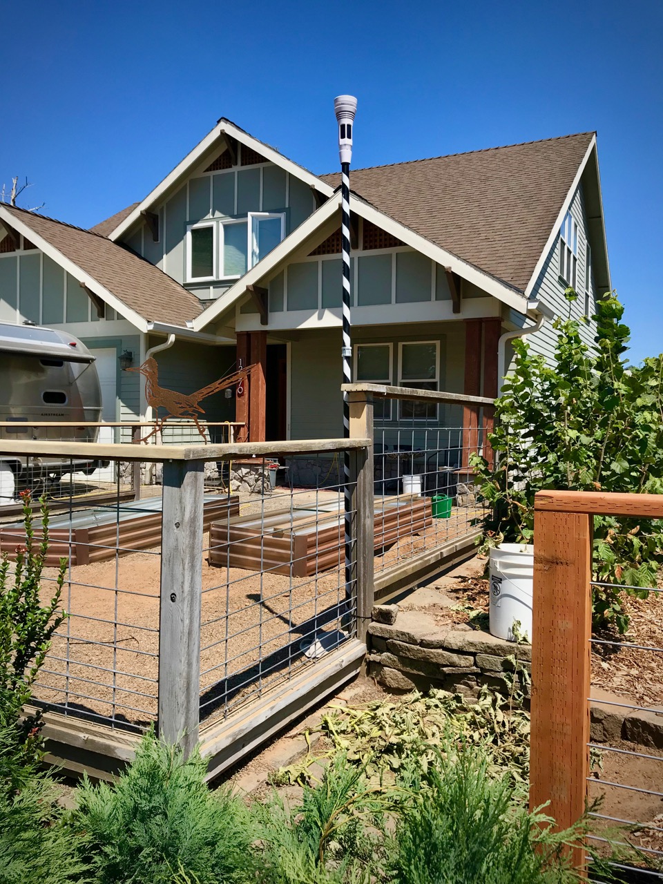

I struggled with how to paint the mast, but then east coast lighthouse inspiration struck!
Pretty close to Cape Hatteras Light Station / Cape Hatteras National Seashore – Buxton, NC. Oh, and your Tempest location is Excellent, too!
