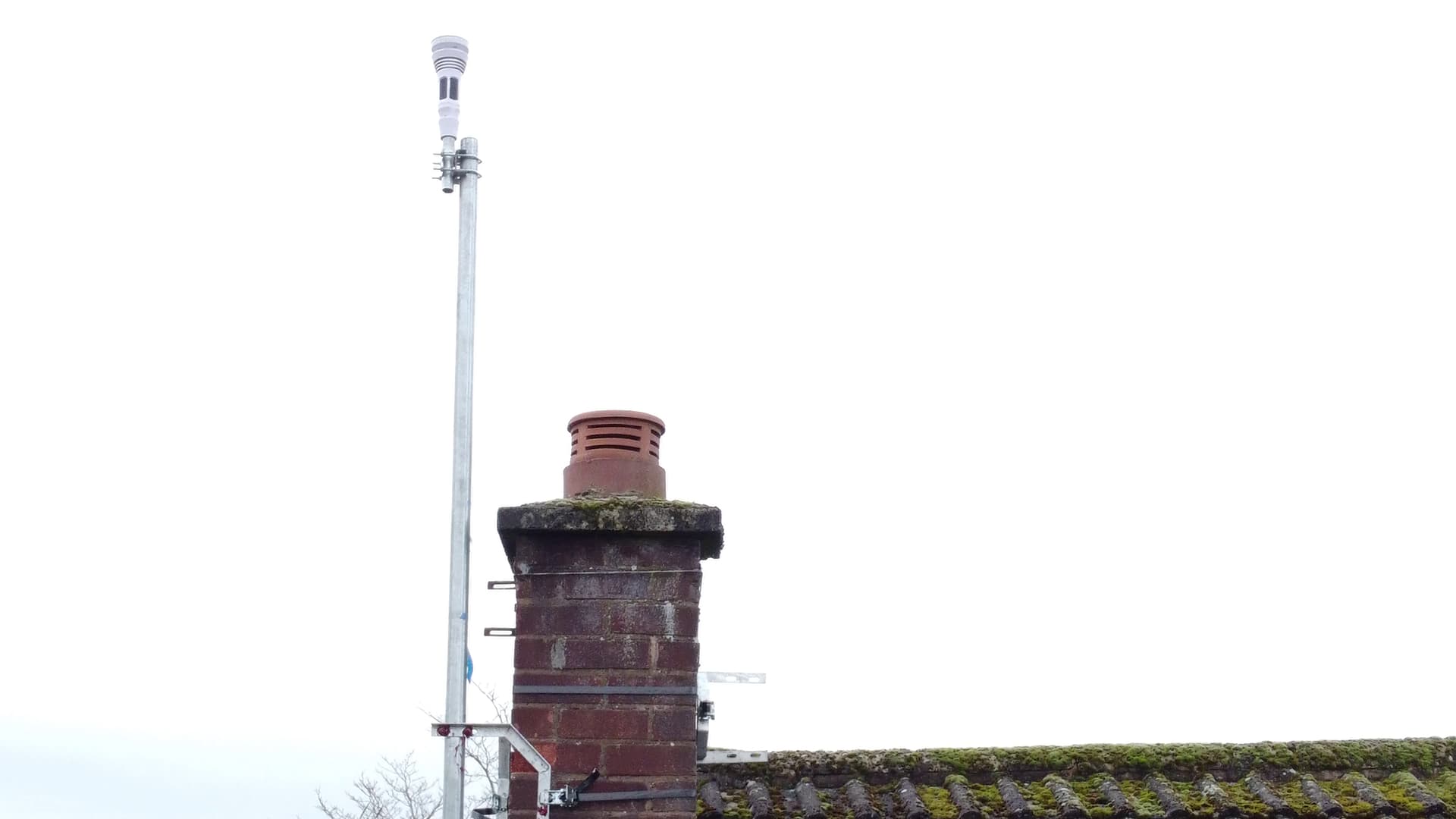

Right…hundreds of channels and nothing on (TV…57 it used to be), so I took the TV mast down and used it for the Tempest
Okay wind…bring it!!!
The pole is 2" wide 18G 2mtrs
I’ve put the TV aerial on the previously used pole for the Tempest and when I’d finished I took a look and noticed some swaying with ā€˜Dipstick’ (my Weather station’s handle) but it’s been hit with 20MPH gusts today and no false rain so a big improvement.
I don’t know why anybody didn’t make the suggestion of using a clamp around a more substantional pole with it on!!!

I’ve now taken the TV aerial back down and it’s still getting false rain as if it’s detecting it before it reaches the vicinity and records the amount
I’m in the center of the 30m radius with the black dot
I can only think of the sound through the louvres causing this as mentioned before somewhere here
It now seems my TV aerial shaking is causing false rain![headphone warning](https://btcloud.bt.com/web/app/share/invite/d8tjFukvxX
Try replacing the metal pole with a wooden rod. I have had very good luck using a vinyl wrapped closet rod. Here in the USA they are available at home improvement stores such as Home Depot and Lowe’s. The resonant frequency of the metal pole is likely the issue. Wood will likely have a lower frequency and not trigger the haptic rain sensor.

I’ve remounted it again with some rubber between the pole and chimney clamp also lowering it a good few inches…It seems to have improved but I’m still not convinced. Shall give the next few days of changeable weather a close look at how it copes
Here is a picture of a SKY and Tempest right after installing the prototype PBA.
The mounts to the chimney are about 50cm apart, the poles are 8 feet so about 2.4m in length. They wiggle in the wind but rarely, if ever, give false rain for me.
