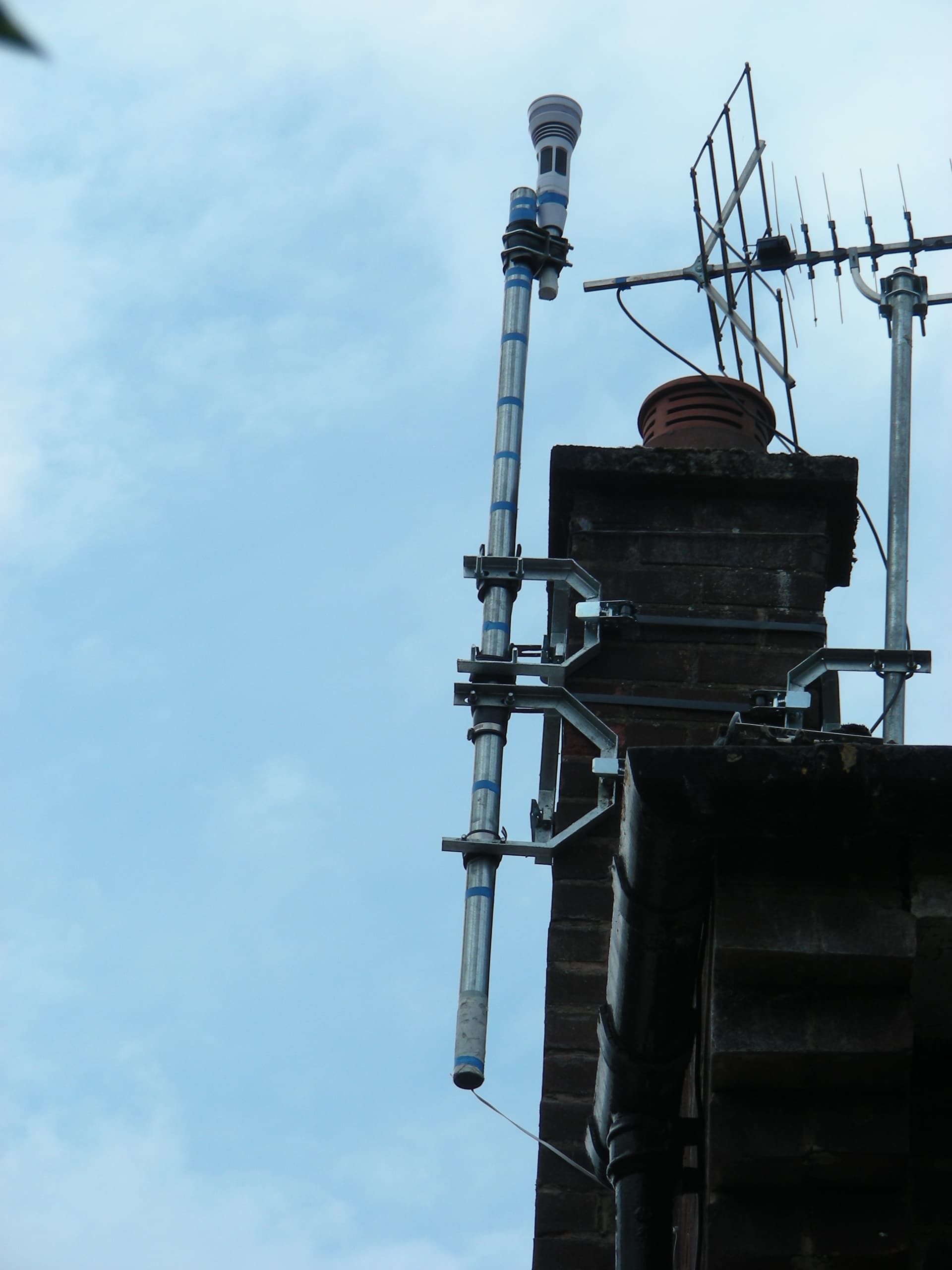

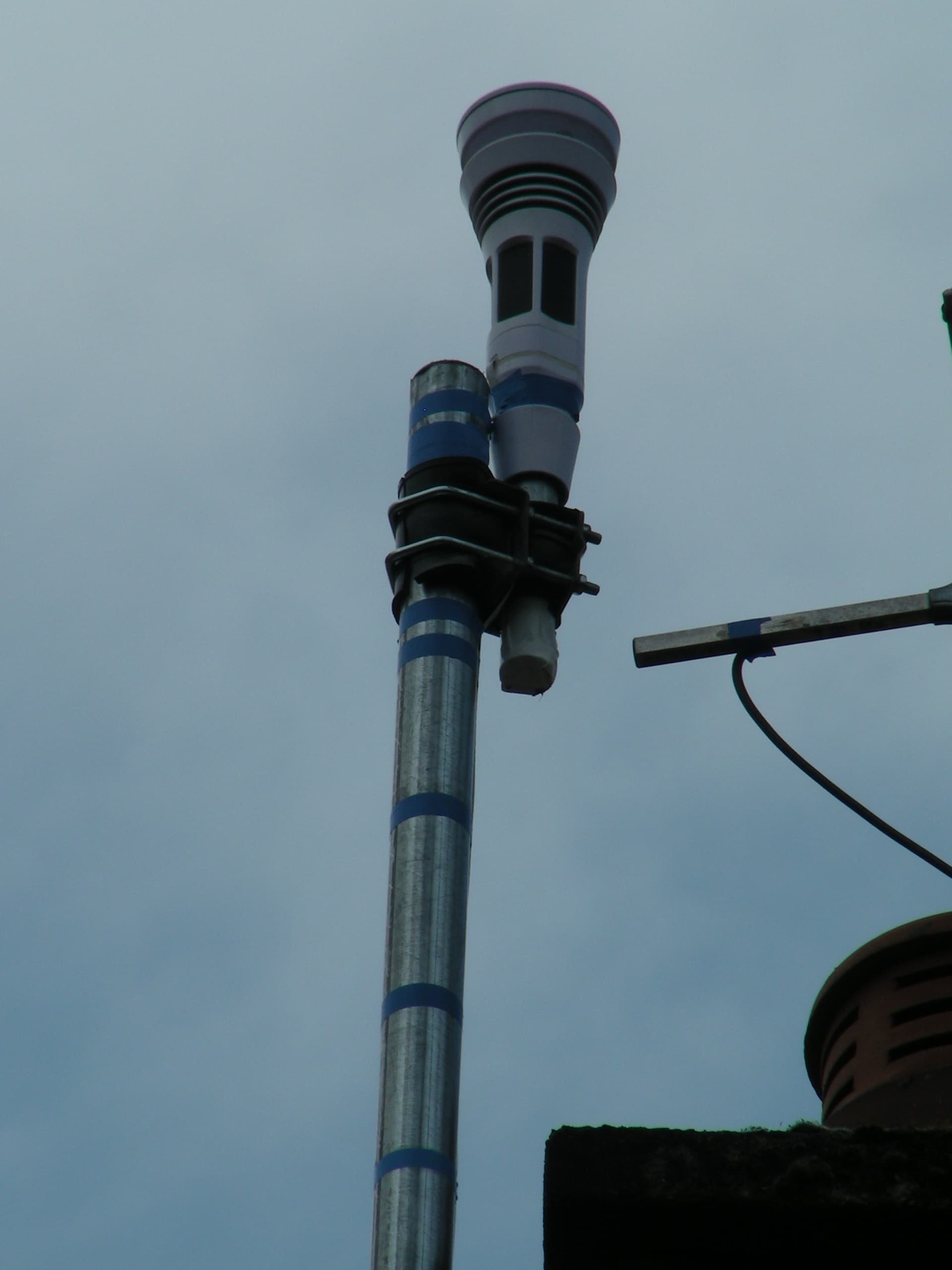

Anyways, got over 20MPH gust today with not a sniff from the rain sensor. I’m guessing just filling and blocking the ends of the small pole actually holding my Tempest has done well

The other bracket is on the way just in case increased gusts cause it again to happen

I need to be getting up the ladder again to put this up for extra support due to wind causing trigger today…once it’s triggered it keeps reporting!
Right, I’ve put the other smaller chimney clamp up and fitted the PBA back inline…come on wind, bring it! (not the false readings I hope)
EDIT;
It’s worse than ever!
Edit, Edit;
Found a strap was twisted.
Straightened it out and tightened it up properly now!!! let’s see!
UPDATE!
FAIL!
I’ve removed the bolts from the middle (the top of the bigger bracket and lower of the smaller bracket), one ‘U’ bolt is still firmly wedged and held in place by rubber ( not easy to remove standing on a ladder-it doesn’t move at all) this seems to have made a difference for the better!!! (wait and see)
