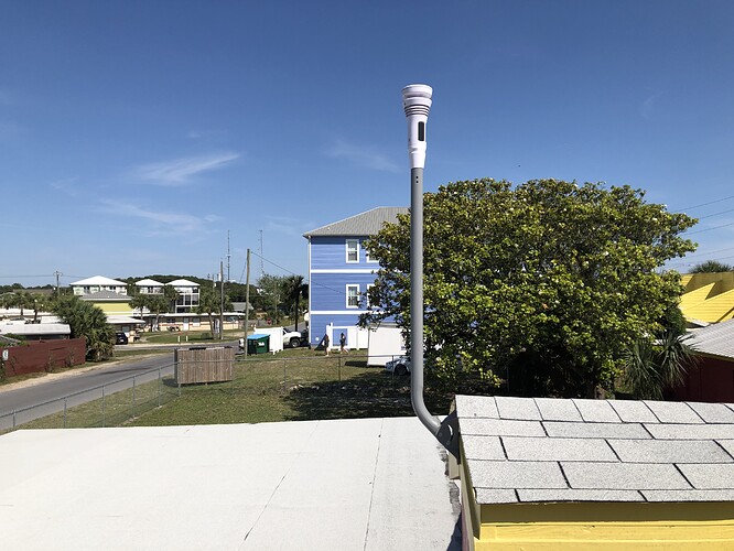

I’m curious to how long will the PVC last in a coastal environment? I currently have a j pole mount at my Panama City Beach, FL location, but the top part vibrates during high winds and causes the haptic to report rain when there isn’t any rain. The Tempest is located just across the road at the beach. @dsj @tony.mcgee @WFsupport
The salt air should not impact the PVC at all. The only effect is from UV light and that is a slight reduction in impact strength; tensile strength and stiffness are unaffected.
Thanks! I’ll probably end up getting the installation kit then.
