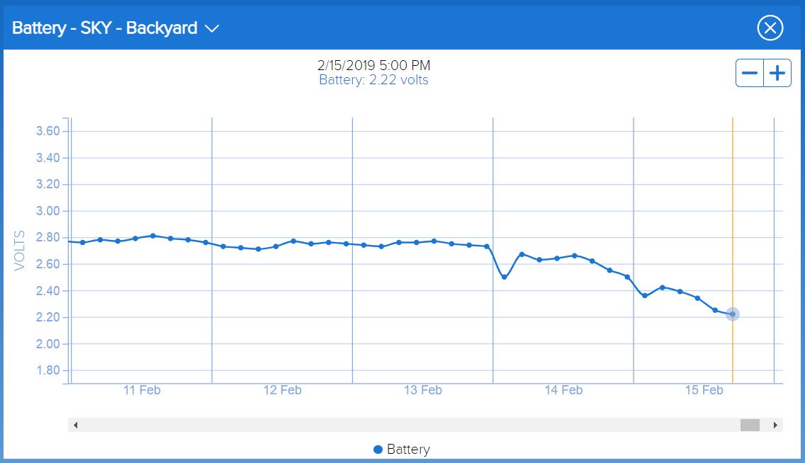

The Sky died because the cells died. The last reading was 2.22 vdc.
Capture
I figured that might be the issue, but the battery indicator still said ā€œgoodā€ when it was at 2.22 volts. So something seems to be off with the battery card if that’s the case. Thanks for looking into it.
The replace value on the Sky is 2.1 so it is working correctly. We have discovered that the very cold is causing the cells to fail quicker once they fall below 2.7 vdc.

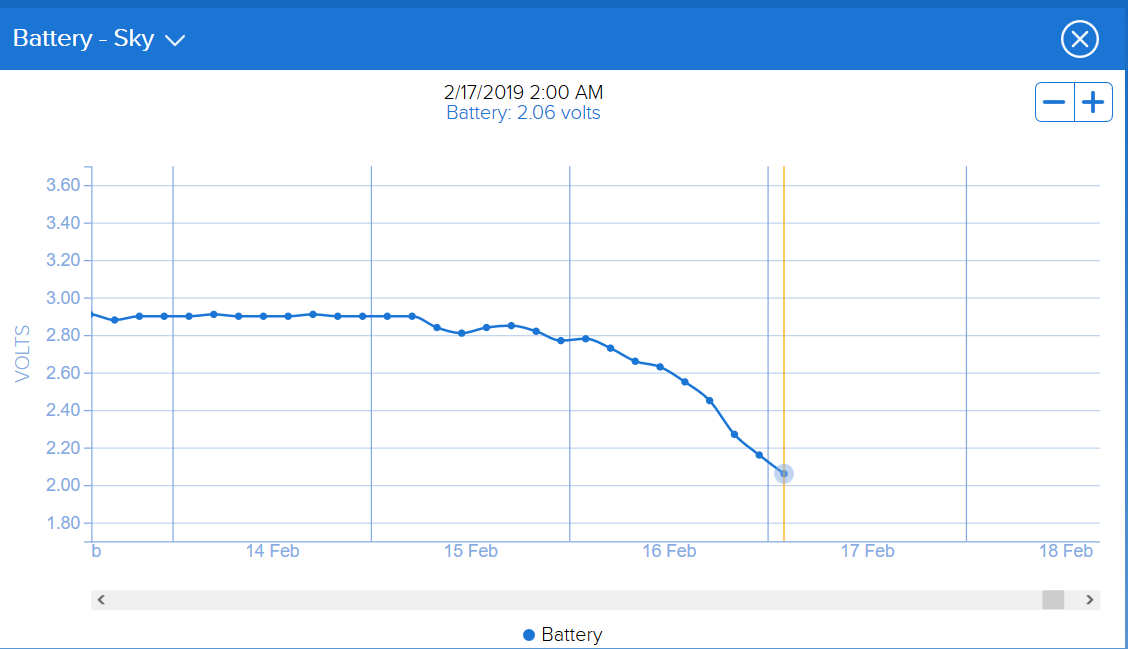

Same happened to me too. Sky suddenly stopped working as batteries are empty now. New ones are ordered, but it should have warn it a bit earlier and it’s not fun to replace them in winter.

I only noticed today but if you check the web portal ( screenshot of mine) you will see the "replace " notification at the bottom of the battery card for my SKY ( currently using eneloops). The app will be updated in the next incarnation to reset the warning to 2.7VDC, so for most situations that should be ok. sky_battery_card_20feb19
