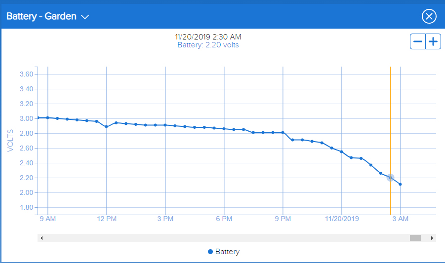

The solar charger has been working fine for about six months.
Last night my Sky crashed due to low battery voltage.
This followed our first real winter night where it got to -4 F.
A screen shot of the battery voltage is attached.
WTF?
same questions/options as for rocket289k I’m afraid

UPDATE: The sun came again today and the system came back to life. I inspected the unit around 8:30 am. Between 6:30 pm yesterday and 3:30 pm today there are no battery strength readings at all. Then suddenly at 3:30 the readings reappeared (see attached screenshot)
Sounds like a bad SPA. Solar panel works but either the battery or the charge controller is bad.
