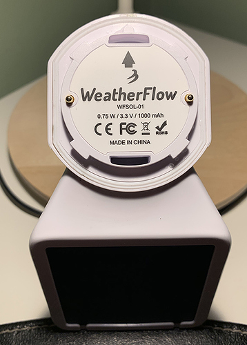

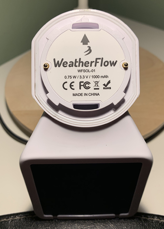

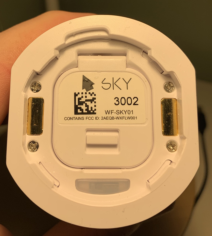

I finally also got around to bringing down my Sky unit…
No signs of water, no corrosion or anything… Everything is looking good I think… I also removed my batteries prior to installing the solar unit… :frowning:
indeed looks pretty clean though I see some drop on sky …
And if you assemble it again, push the reset button trough the whole several seconds, it comes live ?
Have you gotten the ticket @WFstaff opened for you ? If nothing wants to work, reply there as he will assist you from there on.
Thanks
Yes, I have a support ticket :
“WeatherFlow’s support team has created this request for you: 975196”
But I don’t get any signs of life when pressing the reset button, but that’s due to the battery in the solar unit is depleted so its empty… I guess… Should I remove the solar unit and try and get it going using standard AA-batteries and do the reset from there?
if you have a set spare batteries yep, at least it will confirm if it is the SPA that is dead or the sky… I suspect the SPA though
Got it thanks… will chase up some packs of AA’s … 8 of them :open_mouth::smiley: and try from there…
just test with any available … energizers is you’re sure it works … none left in a drawer somewhere that still have some juice left ?
Yeah its live now… and got a notification on my phone Sky is back online… do I need to perform a reset still?
