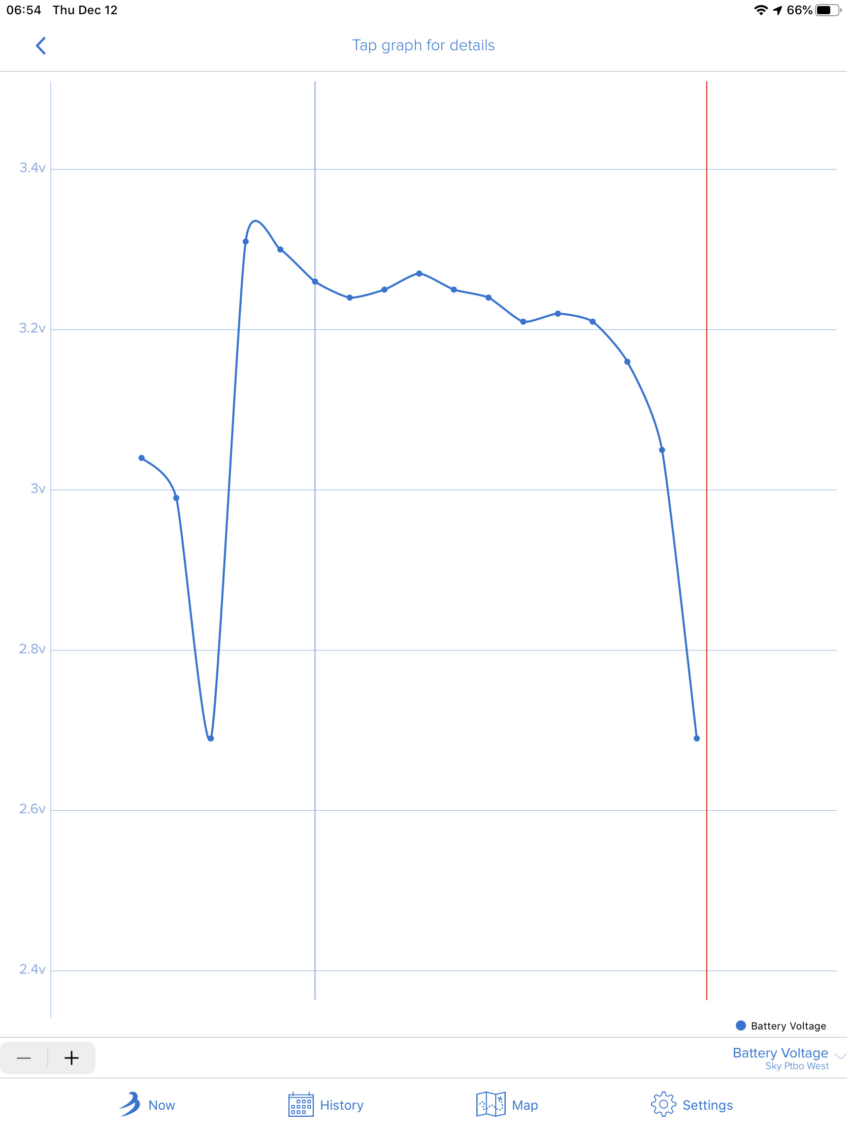

Voltage
Not enough light in Finland, this is a month old Solar panel that I got as an exchange because the old one had batteries that leaked (i guess water had penetrated the panel)
Station ID 5245
Micke
indeed almost 6 weeks with hardly enough light to charge … there is an end to everything … except use batteries till spring arrives …
just had a look at a few station around you, most show same symptoms … winter night is to long for the solar panel … back to batteries if you can get to the sky.
