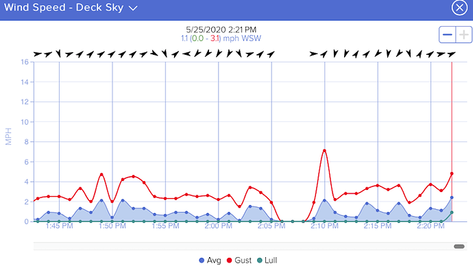

Again 2 charts of both your stations and again, I don’t see such great differences. What you can see, wind directions are all over the place indicating or bouncing or swirling due to nearby objects (walls, trees …). Also sampling between 2 stations isn’t on the exact same moment, you can have 1 or 2 seconds between them and that can be largely enough to have other readings and bearings.
Eric, it seems average wind speeds are very similar but the consistency is the Sky usually records higher peak gusts than the Tempest. A 9mph gust on the Tempest usually shows up as something like a 11-12mph gust on the Sky. I’m not sure how this will translate to much higher wind gusts during more windy conditions. It’s probably more by anal. personality than anything.
