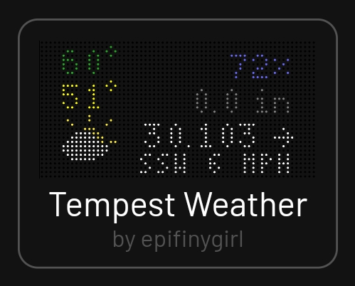

Did you ever figure out why station pressure is displayed rather than sea-level pressure? If not, maybe someone here in the forum can spot what the fix is.
Someone actually figured it out and already submitted a fix!
Awesome, and it has now shown up correctly on both of my Tidbyts. :smiley:
Unfortunately getting the temperature to display with the actual decimal point would require a changes to the Tempest API.
The Tidbyt integration uses the /better_forecast REST endpoint as that returns current conditions (Clear, Foggy, etc) as well as the temperature, pressure, wind values converted to the units (mph/kph) of the stations location. The forecast call unfortunately returns a rounded whole number temperature so the decimal point is lost and will always display zero.
Ideally they could add /observations/station/{station_id} a param to this call to include current conditions which would include the the current conditions from the forecast call converted to the known station units (and returned as a decimal value)
That is unfortunate. Is it easy to edit the Tidbyt app to not display the .0 until the code is rewritten to get the decimal value?
Should just be a matter of changing the %g° to %d° here community/tempest.star at main · tidbyt/community · GitHub
@gizmoev The Tidbyt should be showing without the ZERO now.
Great! Now it won’t give the impression that there is an extra digit of precision. Hopefully at some point someone has the time to modify the code to get the decimal value and not just an integer.

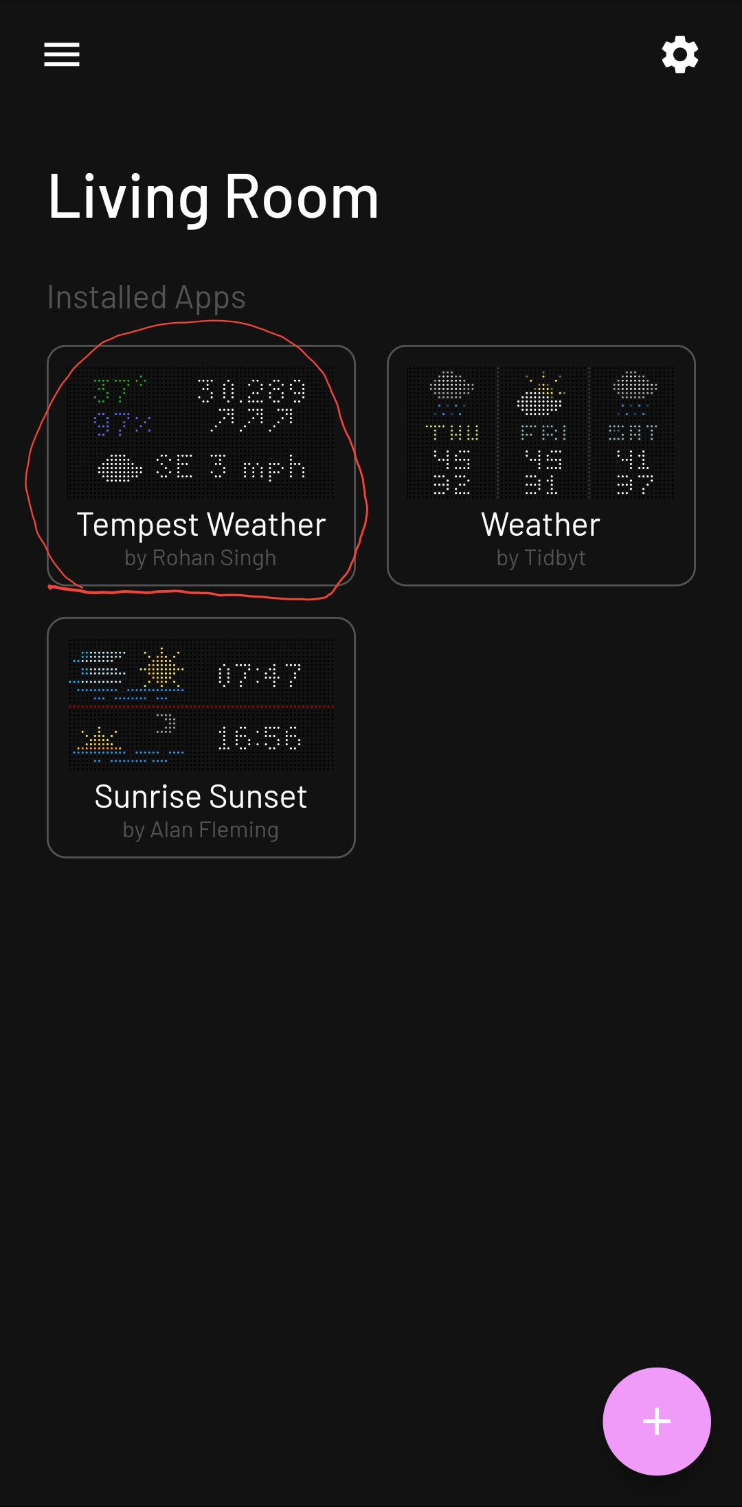

I too would like to know if there is an integration.
I’m a weather enthusiast and know the bare basics of API. I do not own a Tidbyt but I’m very interested on investing in one. There is other data I would like included on the Tidbyt but it would require multiple screens or perhaps a rolling ticker. The example shown here appears as if it’s just one screen
It has been updated but is still only a single display.
Screenshot_20240513_120958
You can write your own programs for the Tidbyt.
Thank you! That display is much better. The previous version had pressure and underneath had 3 arrows representing the pressure trend. I thought that was a waste of space and could put another variable to replace the 3 arrows.
