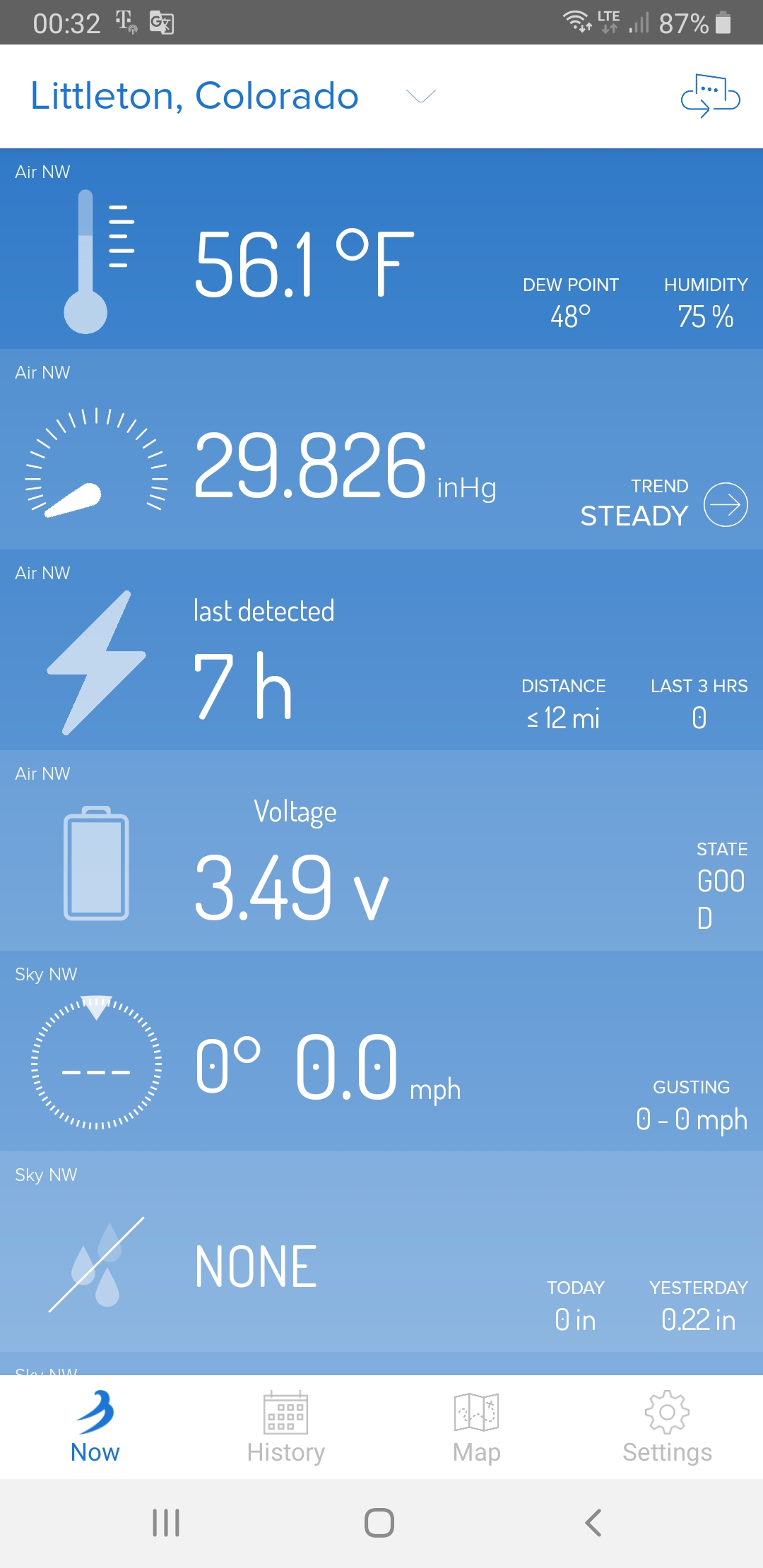

  1. Jump on the 10" for Belchertown. The 7" does not have enough screen real estate for the skin, and the 8" isn’t much better. The only thing that I would use a 7" for is running the WF Android app, as seen below.

  3. This is an early beta of Belchertown on the 10" tablet, with the 7" above it running the WF app. I did a few custom HTML tweaks to strip the banner headers for tablet use, since I know where :wink: I live and need that precious screen real estate for weather data:
