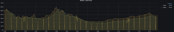

Solar power in W/m2 and compare it against the W that my panels are producing. My panels are exactly 1m2 and 170W, or 170W/m2 per panel, of which I have (9). I’ve made sure my load will pull as much solar as possible (drawing from battery too) and noticed that the panels and the tempest are almost the same. I would think that if the Tempest is reporting 500W/m2 and I had (3) panels perfectly oriented I would be seeing 1.5Kw power, correct? Green line is Tempest, Yellow is solar panels.

Yeah, I understand this is a lot more complicated with time of year, shading, panel orientation, panel efficiency etc. My panels are 18% efficient and I have see 1.5kW near Death Valley in July (was running the A/C via solar)
My goal is to see if I could use the Tempest to say “your potential is 500W/m2” and I see 400Wm2 that I could say that I’m leaving 1.1kW on the table due to shading, bad orientation etc. Ultimately I want to use some ML to build a forecaster based on the APIs from Solcast to tell me something like “at the current consumption rate you will not have enough solar today to meet your demand, you will need shore power to offset demand based on historical usage” kind of thing… I am currently logging all my Victron data and Tempest data to rPI with influxDB.
For example, I turned on a 2kW load and you can see my (9) panels were not able to produce more than what the Tempest was using and drawing from battery.

Understood. The efficiency is already baked in through, I can (and have) see 170W from my 170W panel. The wattage being read from the panels is directly from the panels (Victron MPPT) not after AC inverting (10% loss off the top). Thoughts?
ok, so what you basically see is that the tempest shows at some point 500W/m2 and your 9 panels together also do approximately 500W? (which is 55W/m2)

Yup, Tempest shows 500W/m2 at some point and the (9) panels show 500W. The MPPT dips down to 0 every minute for the MPPT tracking algorithm is my understanding.
what is the max solar radiation tempest recorded in the past? 1.5kW/m2? That would create 165W/m2 on the panels, close to the expected max.
I’ve see as high as 1kW/m2 but only had it logging for the last 2 days and didn’t have a load on at that time. I see, so 1500/9 = 166W/m2
only because your graph showed that 500W/m2 on tempest happens to create 500W on all 9 panels (which is kind of coincidence, having 18 panels would have generated 1000W). So each panel creates about 11% of what tempest records.

Awesome, would love to understand this more. Note the slightly elevated panel production than Tempest. Now, the Tempest could be un-optimal orientation as well. Thanks for the conversation, this is great!
