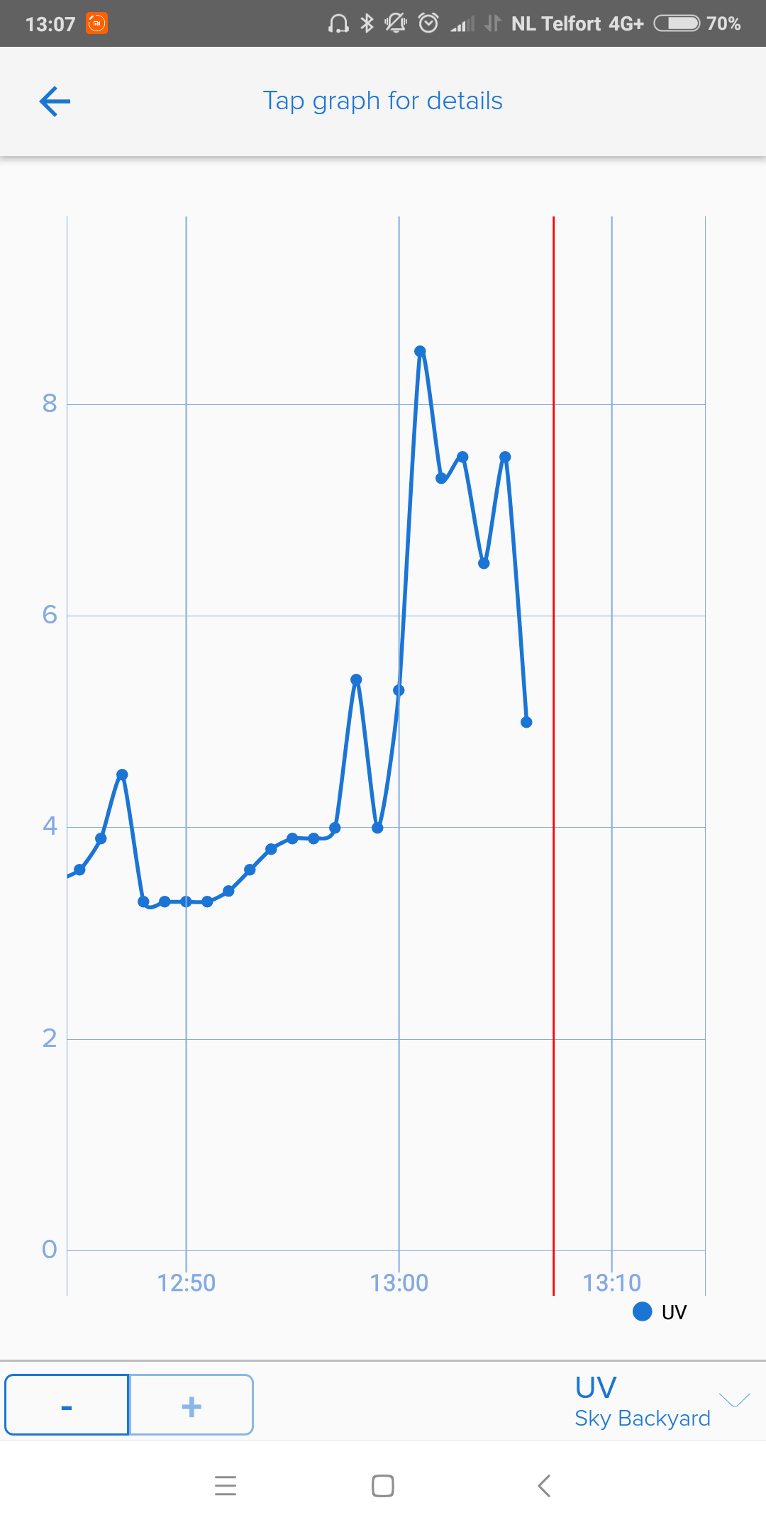

Mine spiked above 8. And I’m much more in the North of Europe.
Will wait a few days… Got some sunny days comming.

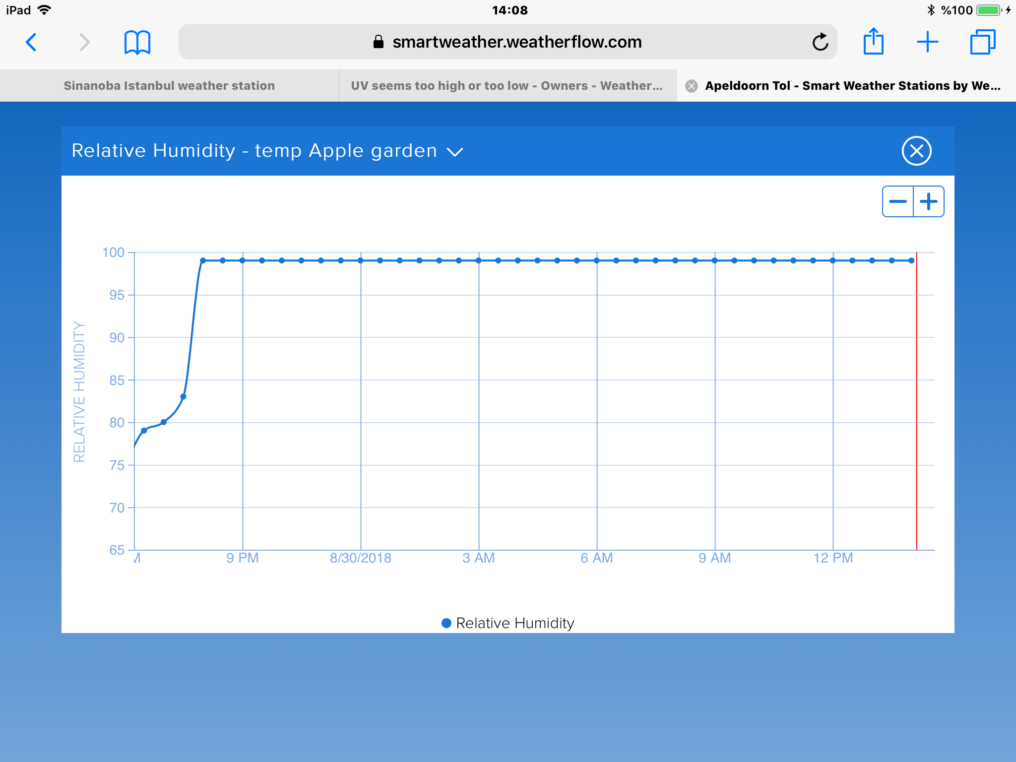

your welcome ron anytime… ps mention the humidity unless you are actually at 100% or near
Yep noticed that, but the air isnt right in good position I ve to find a good ventilated spot working on it. My other station (a cheap WH1080) gives 75 % thats more in line. I keep an eye on it too

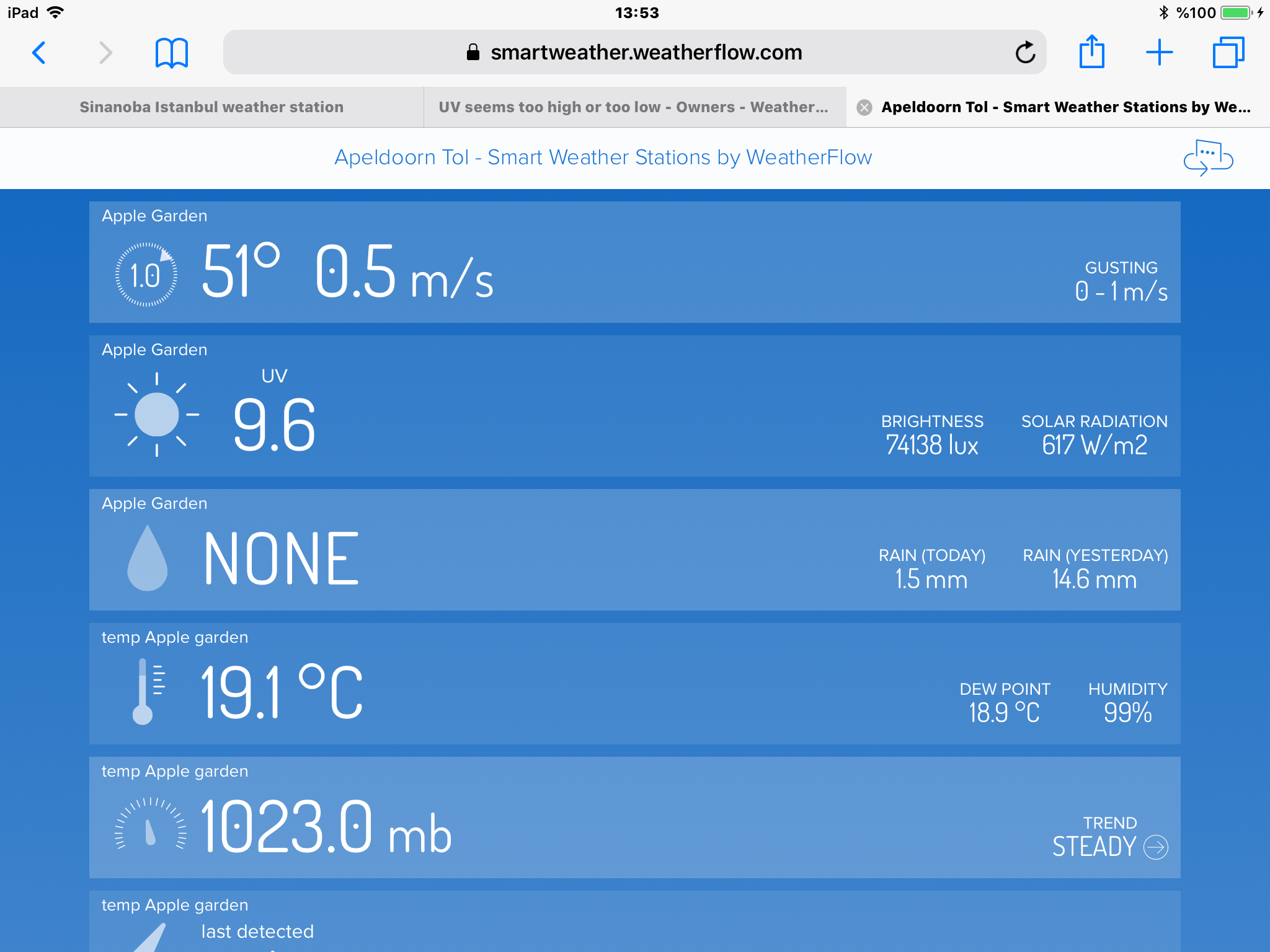

Had some UV readings above 10 today. We never get an index of 10 over here.
Maybe dsj could take a look at my Sky? :blush:
Put sunglasses over the sensor at best two polaroids and crossed I’m sure you get it lower :wink:

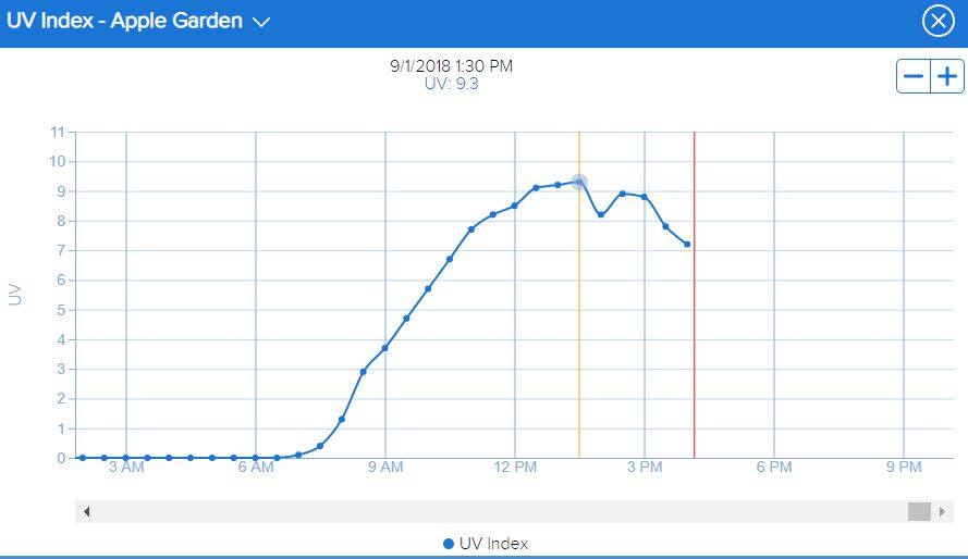

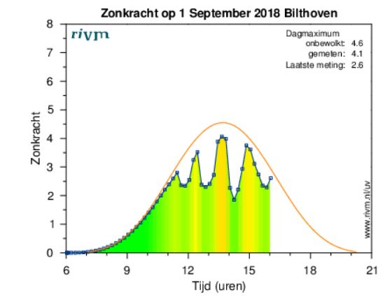

@dsj FYI today we had a rather bright day so here are the results of my Sky and of the official TEMIS and dutch RIVM this give you an idea about the UVI measure on lat 52.2 and longitude 6.00
http://www.temis.nl/uvradiation/nrt/uvindex.php?lon=6.0006&lat=52.22 added screenshots
uvsky nl
