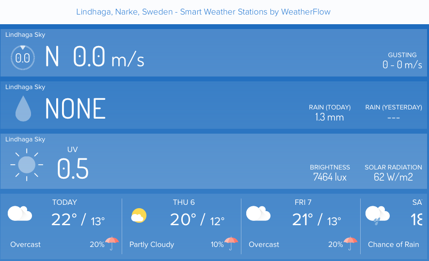

And here are my results 90 km north of spacesnow his location.
Although we have some more clouds today over here.

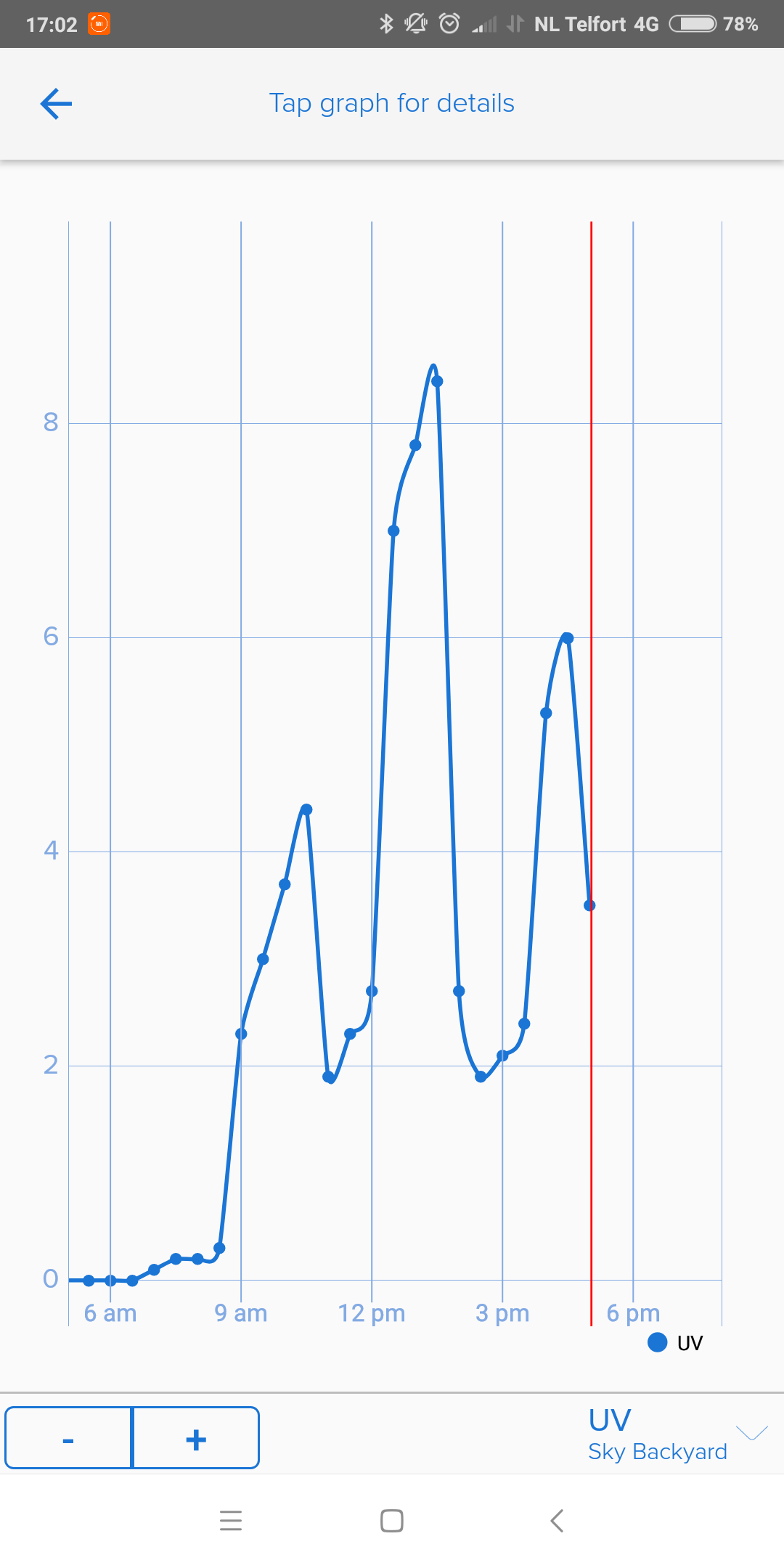

Today I registered an unexpected spike (approx 20 min before solar noon) at 8.4 .
Now this was after a very light shower (cloudy at the time) then the clouds parted , opening to a very bright clear sky.
My question is - could small droplets on the UV sensor cause focussing and increase the reading?

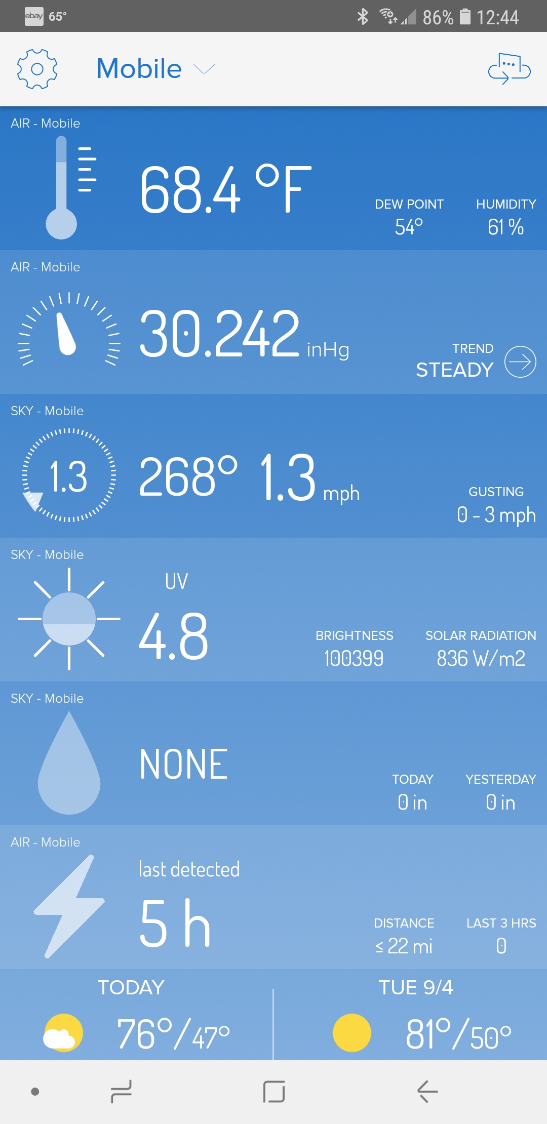

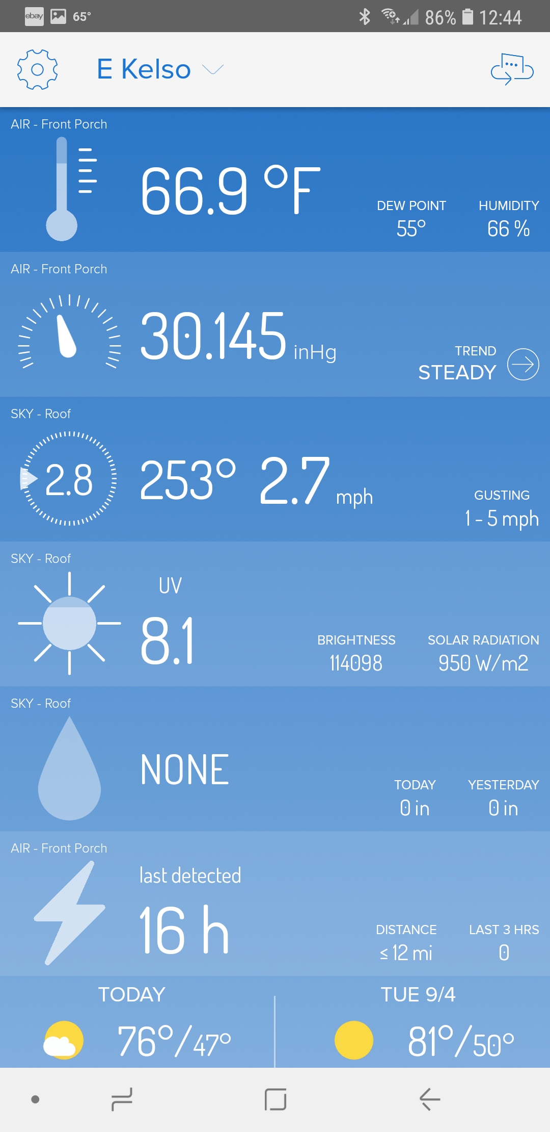

I have two stations (5075 and 5080) which are right close to each other at the moment. I set up the one on the roof first (5075) and then mounted it. I set up the second one a little later and set it on my front porch until I had the pole on my RV installed a couple of days later. After getting it up on the pole I cleared the SKY’s data.
20180903_122444-p
What I am seeing is that the UV/Brightness/SR values quite different even though they are in close proximity and are only about 6’ different in elevation. The one on the RV is at the height of the peak of the roof.
Roof mounted:

Is this related to the UV calibration or something else?
with this kind of differences of a factor 2 (3 in my case) one starts wondering if there was any factory calibration at all.
But I’m not sure you have a problem with brightness or solar radiation. The sensor is supposedly very diffuse so it sees almost 180 degrees of the sky. Imagine taking a picture with a 180 degree fisheye lens pointed straight up, wouldn’t the sensor attached to your caravan see about 10-15% more trees instead of sky?
I didn’t think of the diffuse nature of the sensor. That would make sense on why it is a lower value. Maybe I should take it up and hold it beside my other one and see what happens. It is sunny now so I may do that.

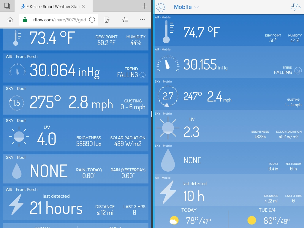

I moved the “Mobile” station to the side yard where it is farther from any trees and has a similar view of the sky as the roof mounted SKY. The top is within a foot of the same height that it was on the RV so the house roof is unlikely having an impact on the reading. I may leave it there or a couple of days and see what happens. I may have to swap locations to rule out view of the sky as the reason.

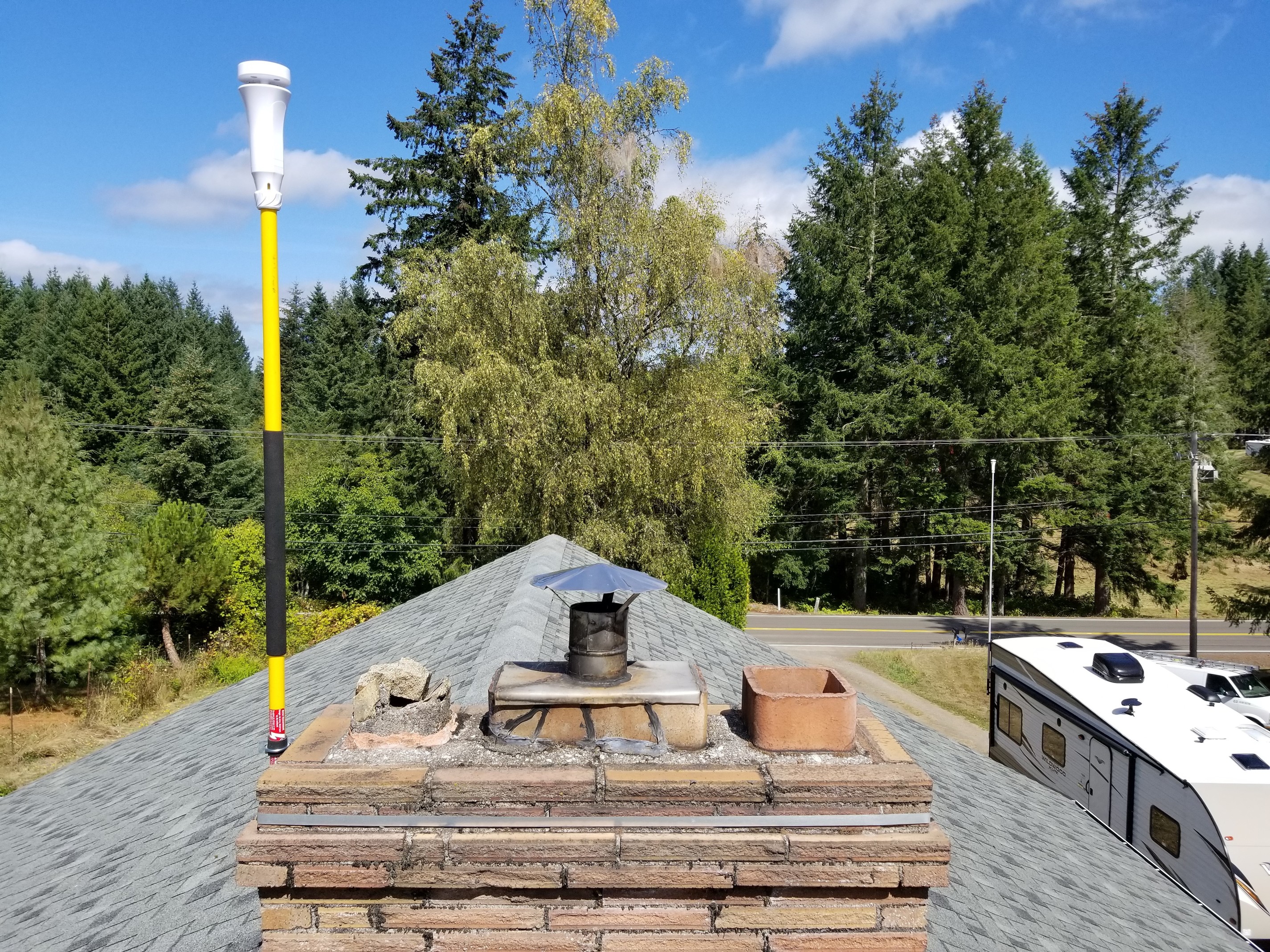

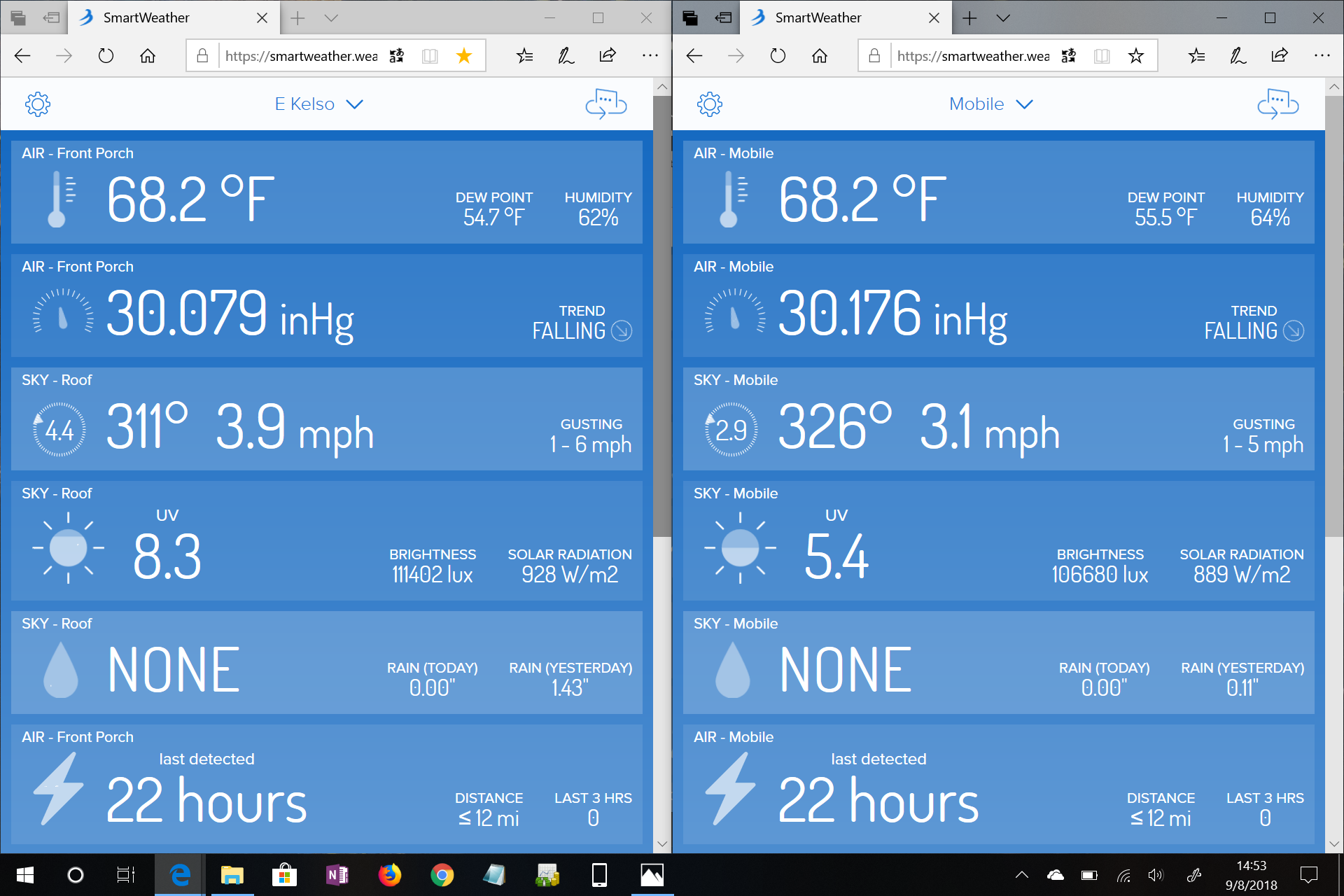

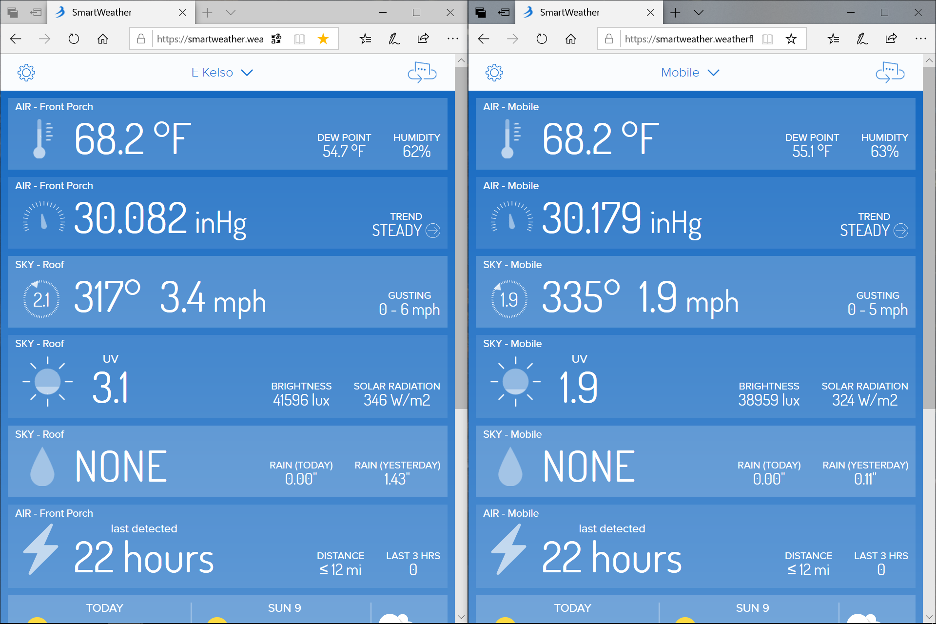

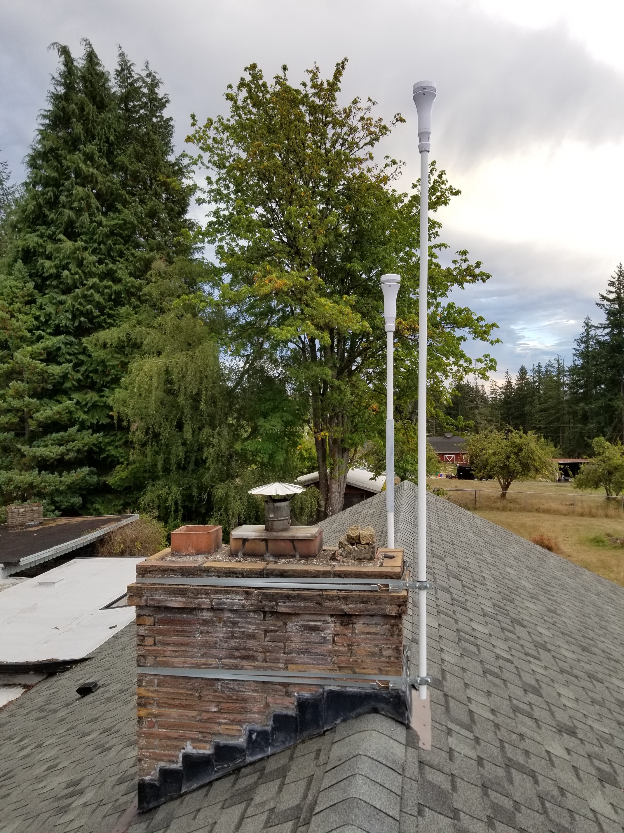

Well, I decided to mount my two stations right near each other while I’m not RVing somewhere so I bought an eight foot vinyl wrapped closet hanger pole and another chimney mount and mounted both SKYs to my chimney. The E Kelso one (5075) is mounted on the taller pole, ~2’ above the Mobile one (5080) mounted on the shorter pole. The closest trees are shown in this picture of them. Below are two screen grabs of both stations after the brightness levels had stabilized.
20180907_185320
WeatherFlow%20SKY%20units%20discrepancy
WeatherFlow%20SKY%20units%20discrepancy-2
This seems like a calibration issue.
David @dsj, if you want to do some beta/alpha testing on these two stations feel free. I’ll let you know when Mobile (5080) gets moved so you know what data to compare, if that helps.
