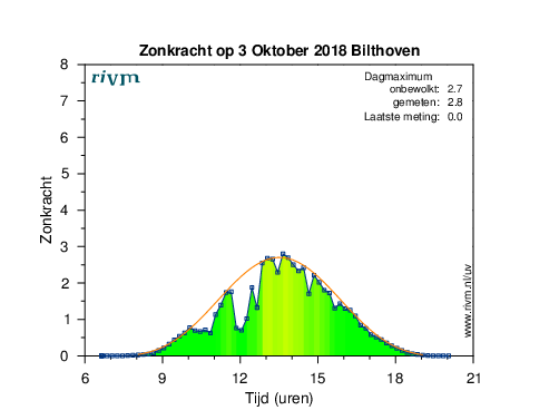

Could you also take a look at my UV data?
UV should be around a maximum of 3 with a clear sky.
This is the RIVM official measurement.
05-54-46-UVI_NL
smartweather
And this is my station
https://smartweather.weatherflow.com/share/4950/grid
Sometimes the UV almost goes to 7. That is what we normally have around the longest day in high summer.
Yes, I’ll add your SKY to the CL beta group for UV. We are very close to deploying a UV update to the CL process for all SKY in the network.
