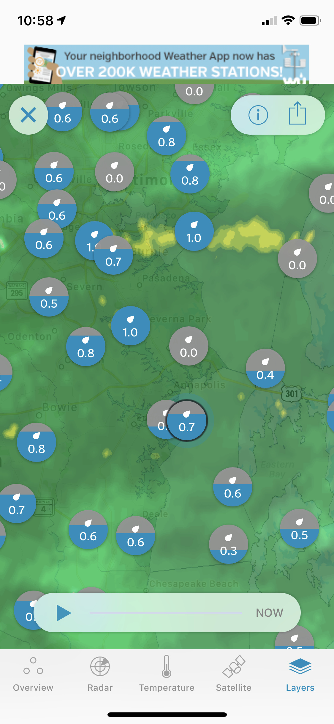

Mind is matching neighboring stations well for this event, which is presumably a similar system that you guys saw in the northeast?
Yup, same event that you had.
