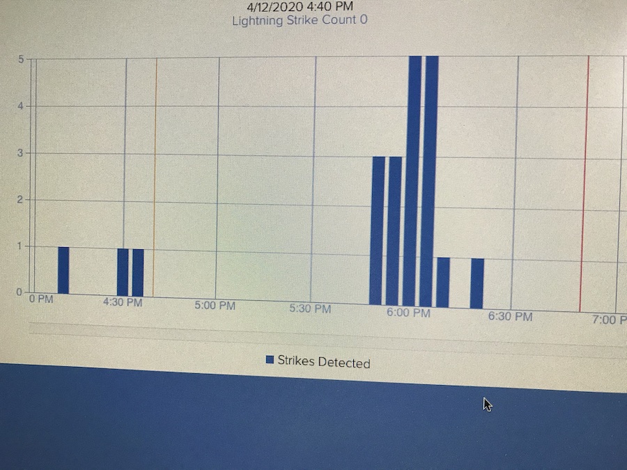

#Peter first rain / a few lightnings since we upped to this version and definitively something fishy
As you know I’m using the Tempest. And is indeed like frozen, no more wind, no pressure update etc …
want me to patch ?
edit : weewx that’s running on the same pi is still running ok
