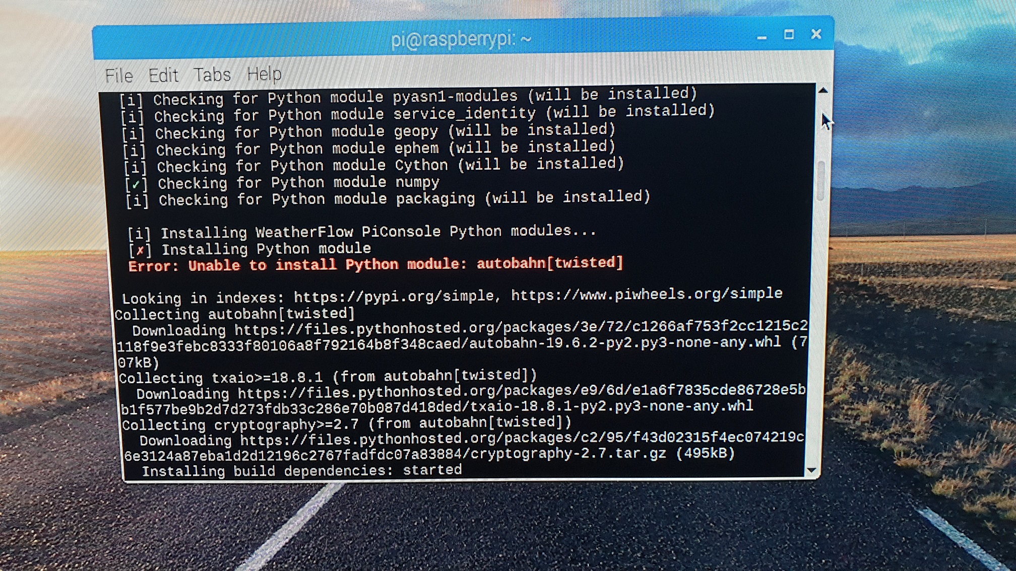

Is there anyway you can show me all the text that is printed after the Error statement? Unfortunately the picture youâve shared doesnât show me what caused the install to stop. Sorry youâre having problems!
Great!

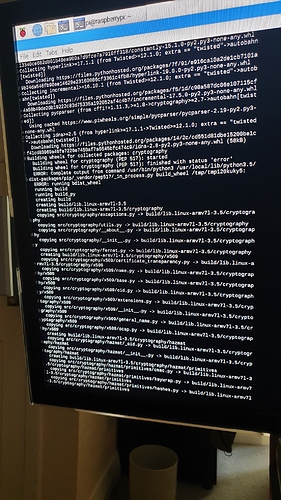

Tried what you said and it appears to have got further, but stills stops with error.

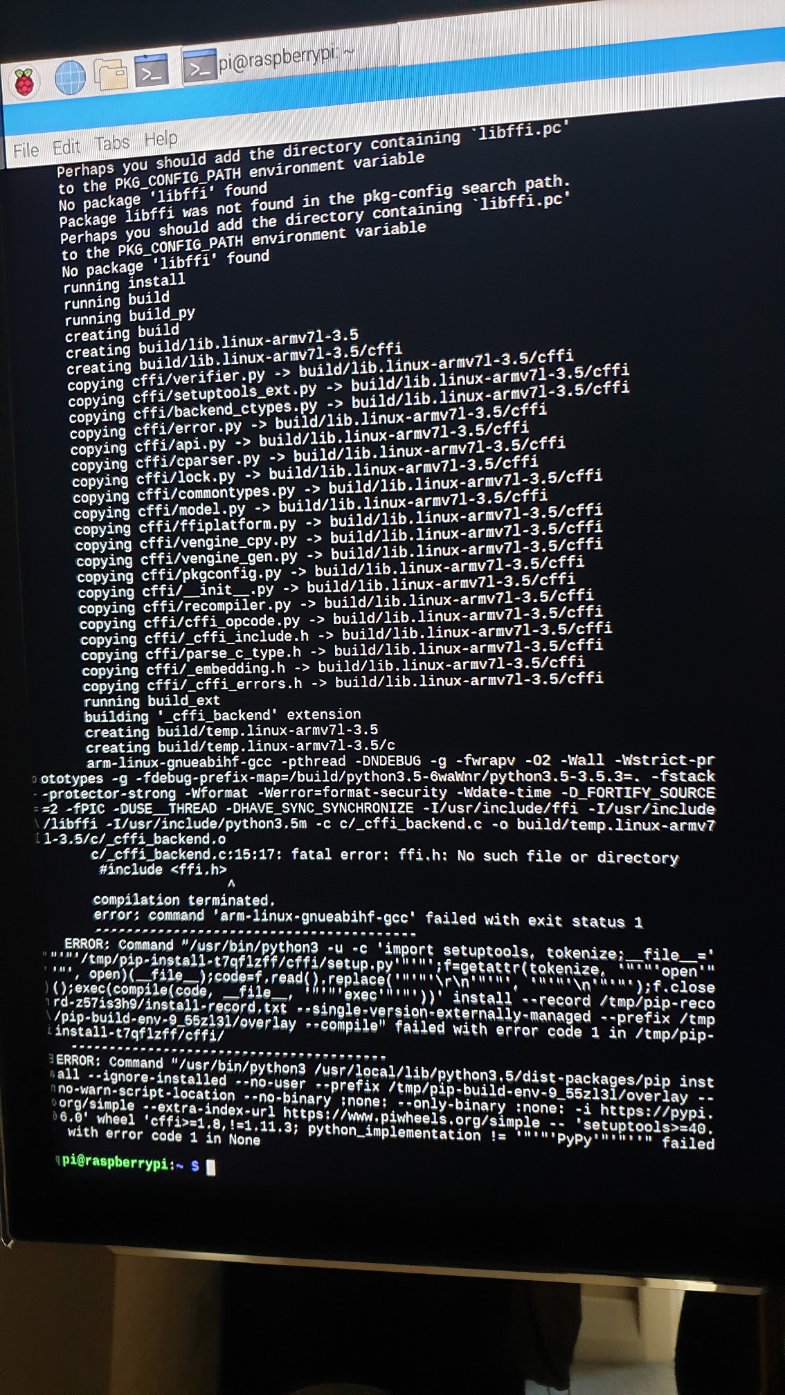

I have attached photo of where things seem to go wrong.
Hmmmm. Are you using a brand new version of Rasbian?
Also I need to be a pain - can you show me images of all the text since the Error statement? I donât think the root cause of the issue is in the picture you sent me.
Hmmm OK. I may need to look at this in more detail. One last try though - can you run this command
sudo apt-get install build-essential libssl-dev libffi-dev python-dev
And then try the install again. If it doesnât work, Iâll try and look into it in more detail later.
Thanks very much for your time and patience, that last command line worked.
