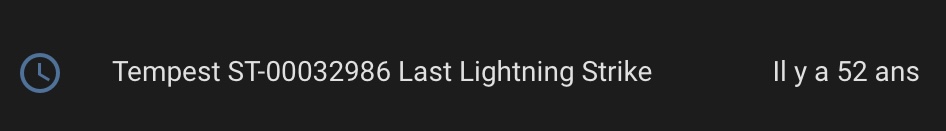

Ok, can you also check the sensor that indicates the last time there was lightning? It indicates, 52 years ago (il y a 52 ans)
Was this a different value before? I’m aware of the issue on new instances where lightning has never been recorded. But otherwise it should try to pull from the sqlite database.
I didn’t notice before the update. My station tells me 1156 lightning this year.
Because this uses the local UDP data from the sensor directly and not the rest/websocket API from WeatherFlow, only data captured while it is running will be available. So even though you can see there has been lightning this year on WeatherFlow, it won’t show up here unless the addon was running during a lightning strike event. This addon writes the data to a local sqlite database to help store and retrieve data that was captured while it was running to try and handle this. But until an event happens, it won’t have the data.
