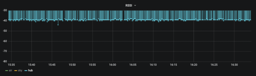

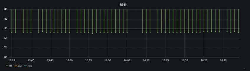

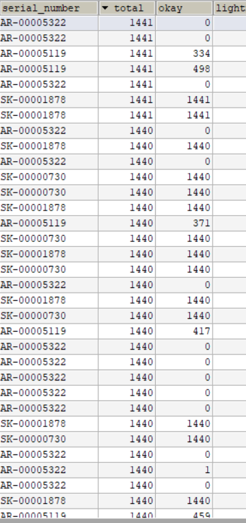

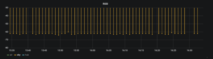

I know my UDP listener has drop-outs all the time with the hub specifically. Here’s some matching RSSI plots from a random time today. Note that the air+sky seem to disappear differently, but seeing ‘any’ observation tells me the hub sent ‘something’ it seems…today looks clean from a weewx standpoint but that might be just luck when the driver saw something on the wifi…
#----------- update - corrected errors in my original reply ------
This data is:
  • from influxdb, collected via telegraf by a pi3 with a SSD disk
  • the pi3 listens for MQTT data from a ‘different’ pi3
  • and ‘that’ pi3 gets its MQTT data from my UDP listener running on a pi zero
  • and ‘that’ zero also runs weewx using your driver
So it’s probably a bit convoluted to say the least. Uncertain if my hacked up setup that feeds influxdb can cause the end-to-end to miss messages or not. I could probably clean things up to have more powerful gear and less gear involved I suppose…

Anyway, the plots:
58%20PM
22%20PM
05%20PM

Anywhere you see || is a missing element in the archive record. If it’s right after the decoded timestamp it’s a missing outTemp (air missing), and if it’s right before the dateTime at the end it’s a missing windSpeed (sky missing).
A quick glance shows a lot of missing Air, and just a few missing Sky (but non-zero).
I would suspect network issues. I go days with not a single lost packet.
Most of the packets that I see missing are due to the Hub rebooting, which has been an issue for months
Definitely uncertain that there is a network problem involved in this at this point.
  • the half-dozen raspi and nodeMCU arduinos that I have on the same 2.4 GHz network send temperature data on 15-sec intervals through the same ‘publish to MQTT’ and ‘influxdb box subscribes to those topics’ mechanism and have 100% success getting all expected observations into influxdb through the various raspi involved.
  • at this time, I can’t explain why my UDP listener publishing to MQTT is resulting in missed observations in influxdb. I don’t have wireshark captures or independently saved time-series data to know for sure.
  • Weewx not recording anything for a 5-minute archive period while my listener data did ‘not’ disappear for the same 5-minute archive period makes me ‘lean’ toward it being a weewx driver issue related to how it deals with partial info when assembling the saved archive record, but I’m not absolutely certain there, nor do I have any logfile proof one way or the other.
But I’m willing to tear my existing bunch’o’raspi all down and set up a one-box gigabit-ethernet i5 NUC if it’ll help answer the question. @vreihen what did you think about the following as an approach ?
  • run weewx only on a hard-wired pi3+
  • run my listener and influxdb on a hard-wired i5 Intel NUC with 16 GB RAM and fast SSD

Quick check seems to show WF loses either air or sky for a one-minute measurement once a day perhaps, but I only checked a few days back.
Trying to take the mess’o’pi out of the equation, I put all the mqtt/telegraf/influxdb setup plus my UDP listener on a clean pi3+ this afternoon, so it’s now a one-pi3+ solution listening+saving the data to a time-series db.
I’ll let my listener do its thing for a few days as a first check to see if it catches everything expected from the Hub. If so, I’ll add weewx onto the same pi3+ and see what happens.
After 4-5 hours up, the pi3+ single-computer listen/mqtt/telegraf/influxdb setup is far better at catching everything, but comparing the two sets of results, I ‘do’ see at least one record captured on the multi-pi setup that was missed by the one-pi3+ setup for hub RSSI. Ugh.
I’ll have to do the i5 Intel NUC thing to throw some serious horsepower at the UDP listen+save compute load.
@GaryFunk - what hardware are you using to run your listen+save solution on that you’re saying isn’t missing any records ever basically ?
Just a RPi 3B+ with fast SDCard. I also use NodeJS as it runs in non-blocking mode and can write several packets at once. That’s the main reason I switched from Python to NodeJS.
I also use several scripts so as to distribute the work.
gary - can you run a quick test please ?
Tell me how many status messages you saved from the air/sky/hub in the last 1000 minutes ?

The image is form the database showing the number of packets received from each device. In a perfect world it is 1440 per day. But the device clocks are a little fast and sometimes send 1441
Capture
