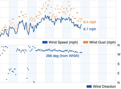

alright! This is looking much better, it’s not obvious which station is which after v133 was applied—didn’t see the higher wind speeds today but they did get over 5MPH which seemed to be the threshold at which v129 would start turning things northerly. The Tempest still likes to report a lower average velocity but what can you do.
Left edge is 11:00AM local time, plots from WU. WU station IDs are KWAWINTH11 (AcuRite) and KWAWINTH73 (Tempest).
Followup after a couple of days with the Tempest running v133. Again, the tendency to drift north when the wind goes above 5MPH is vastly improved, but it still shows some unexpected drift westward as the wind drops below 5MPH.
I broke down and put a 15° westward offset into the WF app for the Tempest, it probably needs to be 20° to agree with the AcuRite and neighboring stations. Again, I don’t know if that’s just my device or something related to tuning brand new firmware.
Both sets of charts are from WU (left is Tempest), I have the WF app uploading the Tempest data and the AcuRite app uploading its data (I believe AcuRite/WU is plotting the AcuRite peak/gust wind as the ‘wind speed’ which is why AcuRite seems to report higher velocity than WF).
