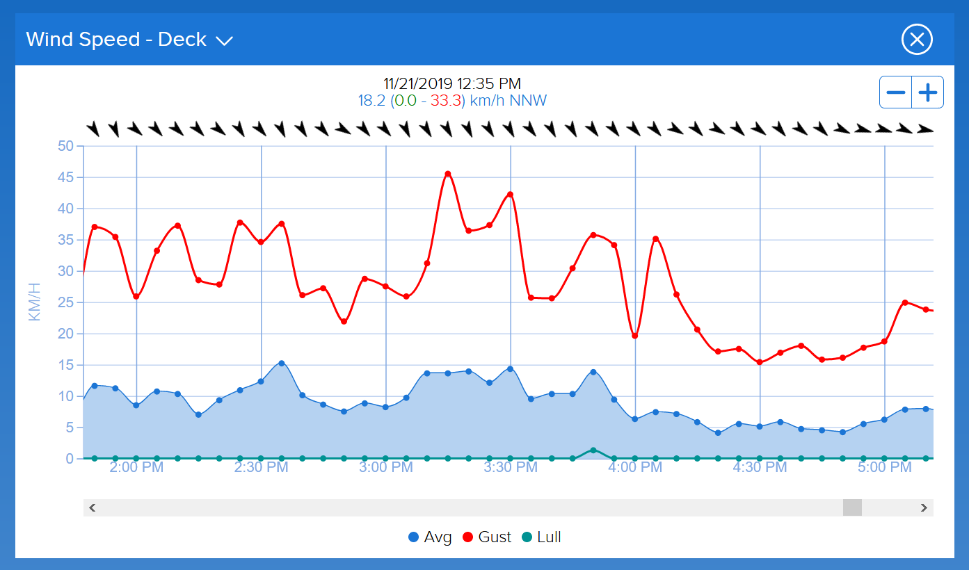

Please explain why ‘Lull’ measurement is nearly always 0.
Understand the 3 second sampling rate, but on a day of consistent high winds the lull doesn’t budge.
Hi @herne thanks for your inquiry. Where do you have your SKY sited? If you can share a few pictures that would be very helpful.

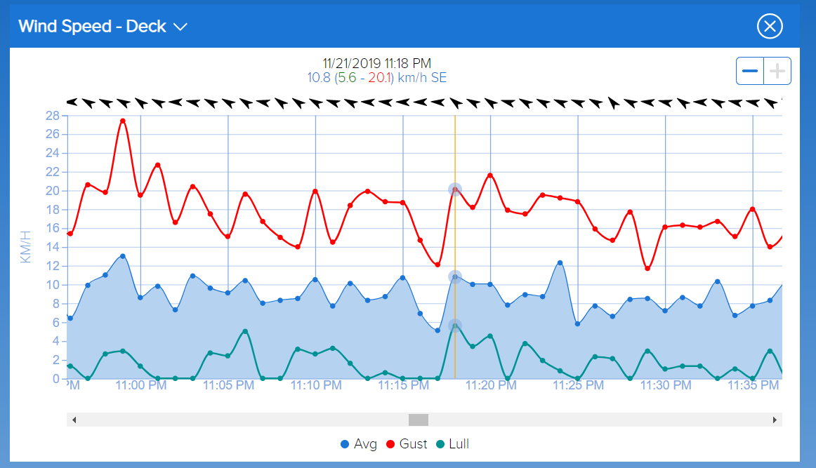

Most likely, this is due to turbulence. The lull will be the lowest 3 second reading within the one minute observation. If your SKY is in a turbulent environment, the winds could very well be going to 0 around the device. The ultrasonic sensor excels at measuring very light winds as it is not dependent on the momentum of moving air whereas a mechanical sensor has a higher ‘cut-in’ speed in order to move the bearings.
Also, zoom in further to see the 1 minute data. You are looking at 5 minute observation buckets which have some smoothing. Your lulls are not consistently 0.
https://smartweather.weatherflow.com/station/4549/graph/12456/wind/1
Wind lull, as used by weatherflow is the mininum windspeed over certain period of time. When zooming out, weatherflow decided to change the period. That is totally weird/wrong. If weatherflow would make a graph of wind lull over the last 10 years it would be almost guaranteed to be a flat zero everywhere.
It shouldn’t do that. It should define some fixed period (say one minute), and define wind lull as the minimum over that period. When zooming out it should average the values, instead of taking the minimum again.
