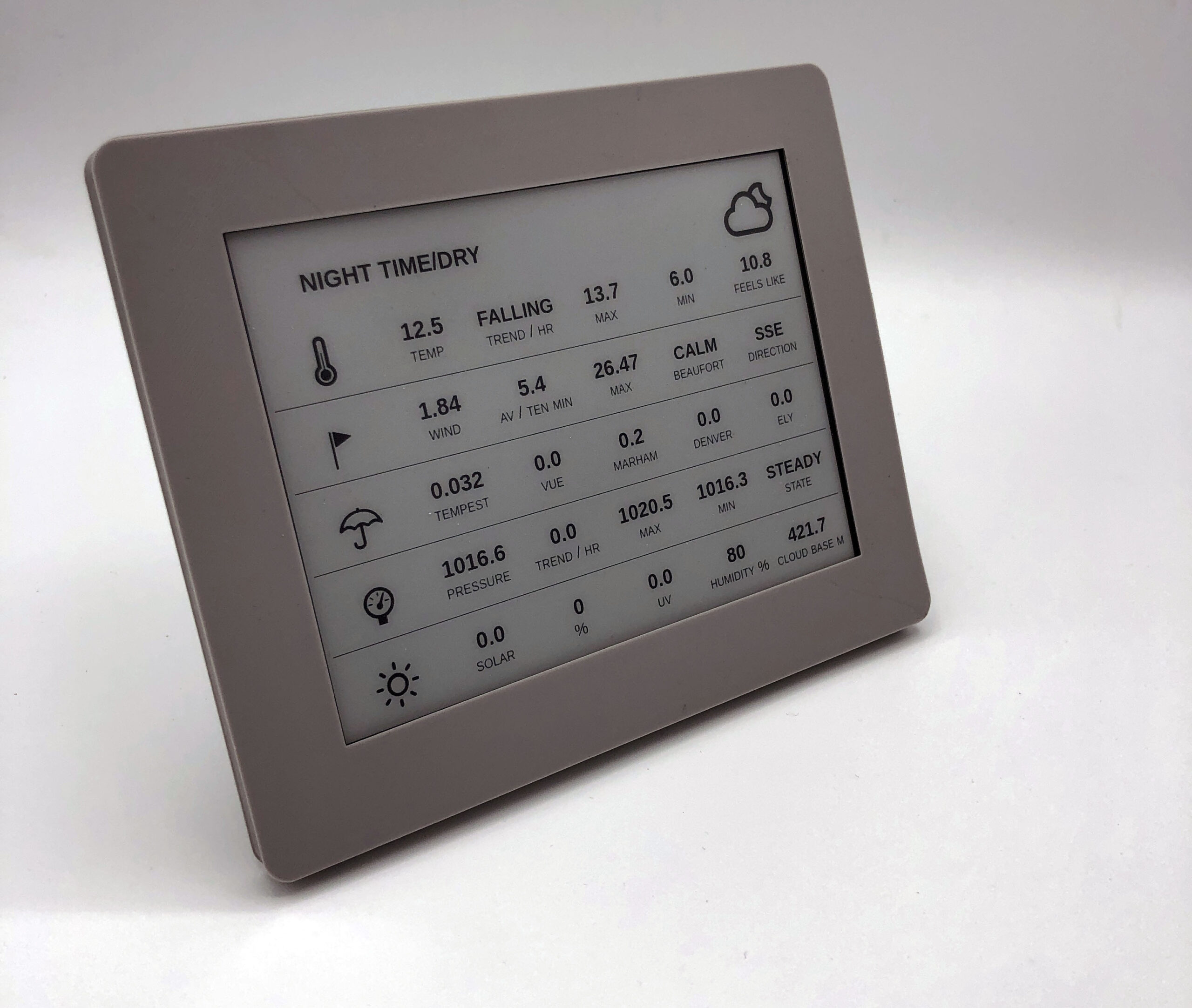

I have just set up a 2.9 inch ink display and I’m about to post a 4.5 inch example on the page, along with the 3d files and the code.
This is the 2.9 inch one -

Andy, That display is really awesome looking!
I love this!

The ink plate 6 is worth a look at - its much simpler to run, deep sleep works well and with a battery it can run for weeks…
this is an example I am using as an early test… The inkplate uses old Kindle screens
and there is a 10inch version currently being crowd funded…
