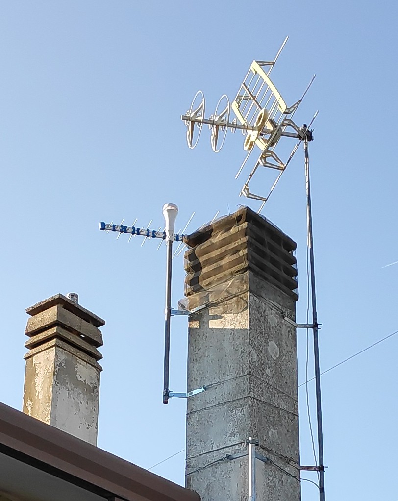

Picture taken looking Nord. No building around, no trees.
Possible your antenna is casting a shadow?
indeed. it could be the antenna is casting shadows. Assuming the satellite dish points south, the antenna is to the east of the sky sensor, causing shadows in the morning. perhaps use a slightly longer mast for the sky unit, so it is above the antenna.
Yes, antenna is placed to East cardinal and dish point to south. I would expect antenna may be causing some shadows in the morning only… not in other time of the day. need to investigate further

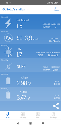

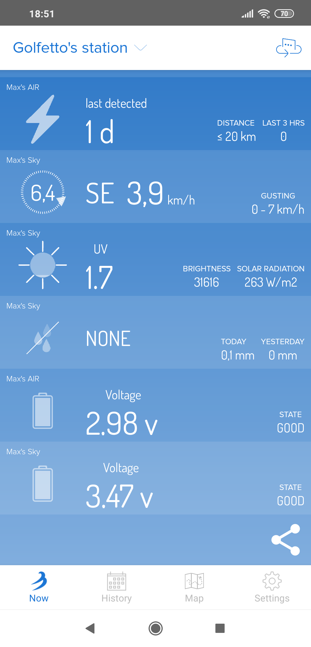

Seems strange. Now no shadows at all but:
We are at a similar latitude and I see similar values at the same times you do. All three of my SKY units show very similar values. I don’t see what the issue is.
So you’re seeing my same problem??
I hope @anon84912554 will give us an explanation or solution.

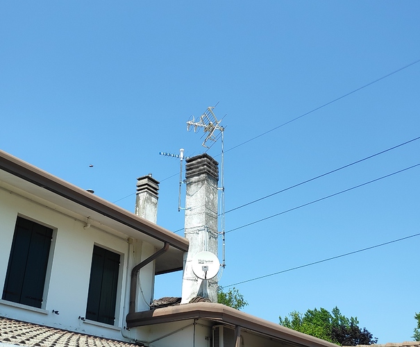

I put SKY on the south side because nothing should be made any kind of shadow. Picture I took shows SKY in full sunlight but APP had low values. I would assume the problems are not shadows.
my suggestion is first to move the unit above the antenna. that will get rid of the holes you see. Support can’t do anything about that. After that auto-calibration will kick in and that will try to make your UV measurements more perfect. (try, as mine are still not good, but I do see occasionally some calibration taken place)

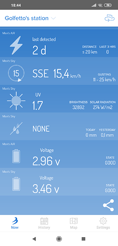

But it was at 18:44 according to the time in the screen shot. The sun is low in the sky so of course the value is low. Check the value at solar noon.
See how brief the dips are? It’s likely large, optically thick clouds passing overhead. You’d be surprised how much they can bring down the UV on a bright summer day.
