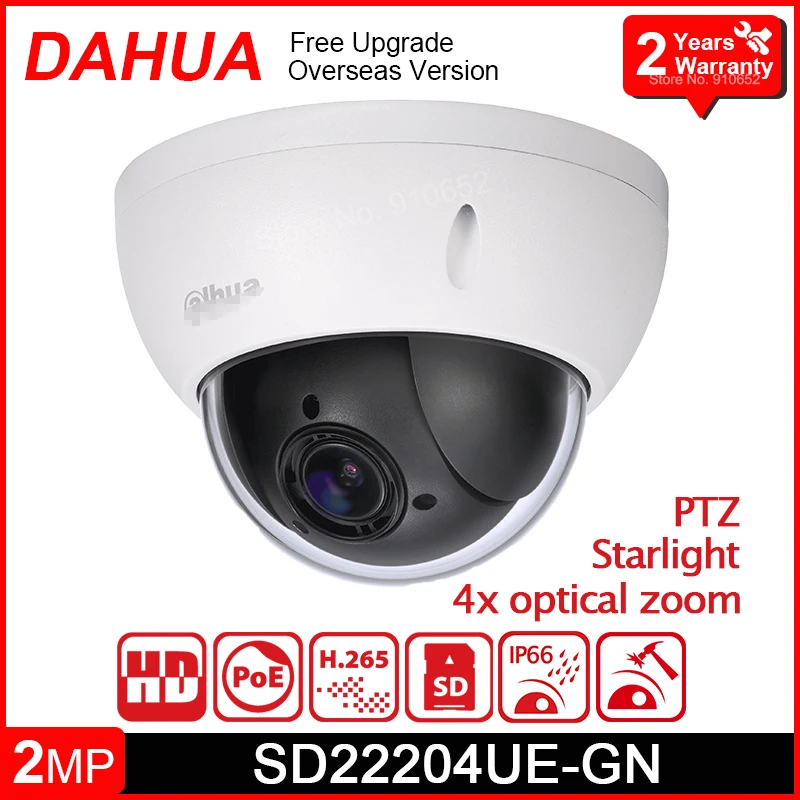

Next project… just arrived a few days ago. A new sensitive Pan/Tilt/Zoom camera for taking cloud pictures. It is sensitive enough that it can see clouds during the night without any problem.
The idea is to take the wind direction from the tempest and automatically point the camera in the direction the wind is coming from. Of course make the camera move very, very slowly, so the timelapse will still look beautiful.
Did someone already make that and want to share the how-to, or do I “invent” this from scratch?

Make and Model ? Wi-fi or ethernet or coax wired ? Cost ? Link to look into them ?
Sounds like a fun addition…
it has very low lux ratings (it is starlight version) and works even in color at night. Also it has relatively long shutter speeds.
As it operates 24/7 it needs too much power to be working from just a simple solar panel, so it needs a wire. I choose the Power-over-Ethernet version, so I needed only 1 cable, and no wifi. You could opt for a model with wifi, but you would still need to connect it with a cable for the power. But they have wifi versions as well.
Thanks. Careful with your network segmentation on this one. Dauha is on the list of companies banned for use in the US at government sites or contractors/suppliers because they gear tries incessantly to phone home to China. You might want to do a little network sniffing to your LAN and block the cam outbound at a minimum.
it isn’t a big issue, many things phone home, but I blocked it before it had a change to do so.
