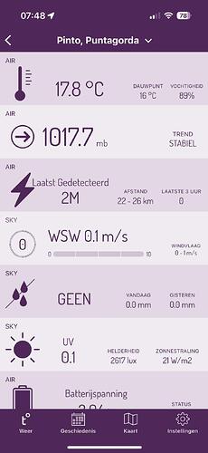

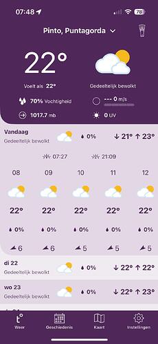

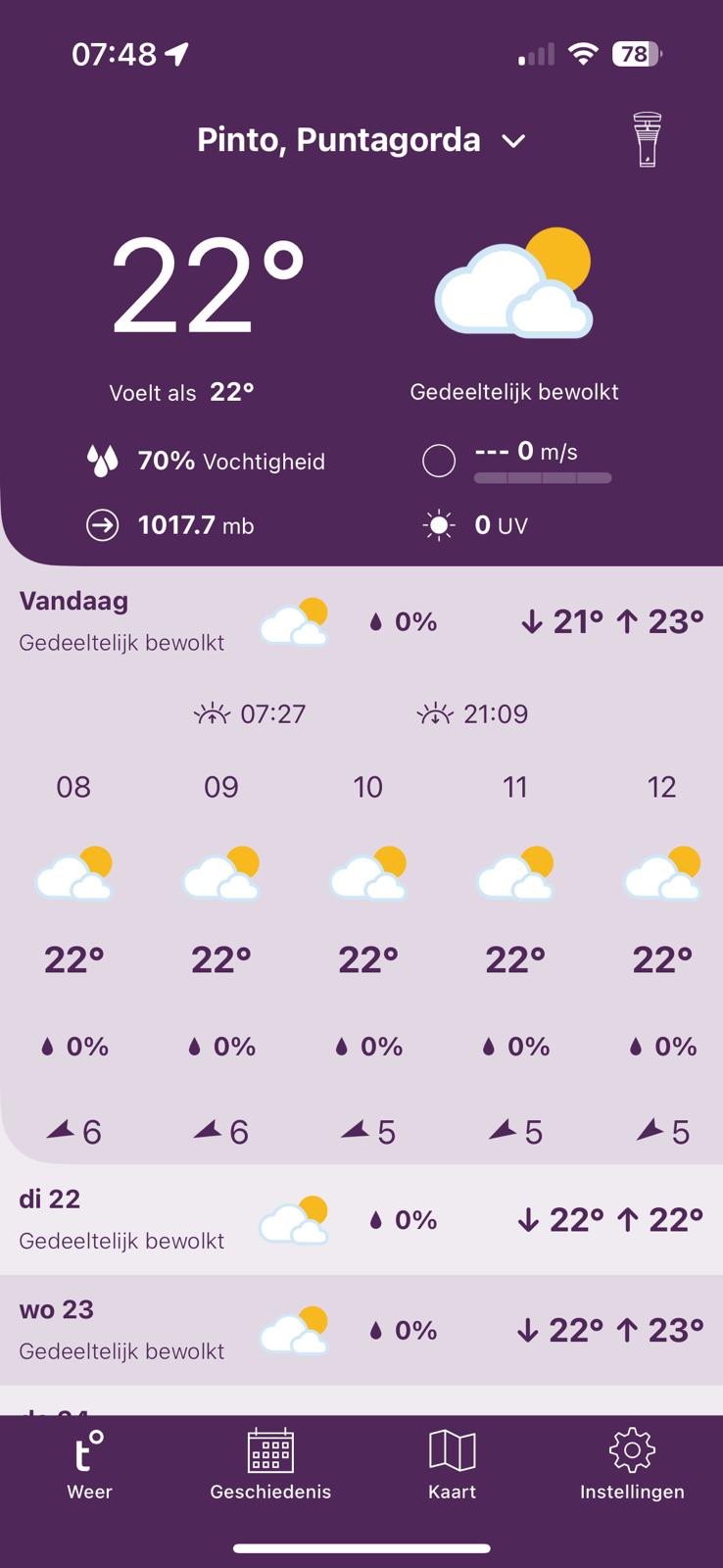

Having the same issue my weather notification is reporting temp on 22c when the actual tempest station is reported 28c
Same here. Station has been online all the time.
