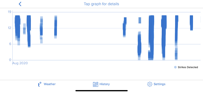

Gary, lightning detection works fine. I have attached my graph of lightning strikes.

but those strikes could be the ones not detected by your unit, but added by weatherflow’s servers.
Gary, so how does one determine whether they are locally detected or added by weatherflow? I see a flash of lightning and within seconds, I will get a warning on my mobile device that lightning was detected and how far away. I think it works. I guess the question is whether the wire cage diminishes the detection of the lightning strikes or not. Not sure how to determine that.
Michael
You’d have to listen to the UDP broadcasts on your LAN and look for strike events.
Unfortunately, you’d also probably need to baseline how well your unit detects strikes without (and with) your wire cage in order to compare the two, which is not too possible unless you have some artificial means to trigger a strike event (maybe a piezo fireplace starter or the like, I dunno). Coming up with a repeatable test to know one way or the other might be difficult.
