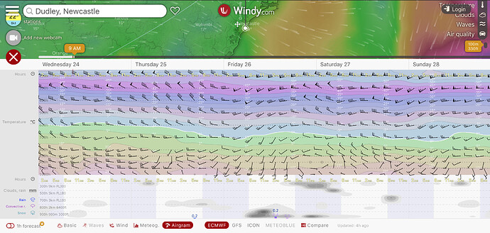

I use raspberry pi cameras looking in each direction which update their pictures every minute to a web page where I (anyone on the web) can see the clouds and who is flying.
Screen Shot 2021-03-24 at 9.20.17 AM
It is also possible to do a rough calculation to calculate the expected cloud base. Discussed here: https://groups.google.com/g/weewx-user/c/kQZvc6UpLtA
And for the layers at altitudes including the wind directions and temperatures of those layers I find the windy.com presentation very useful.
