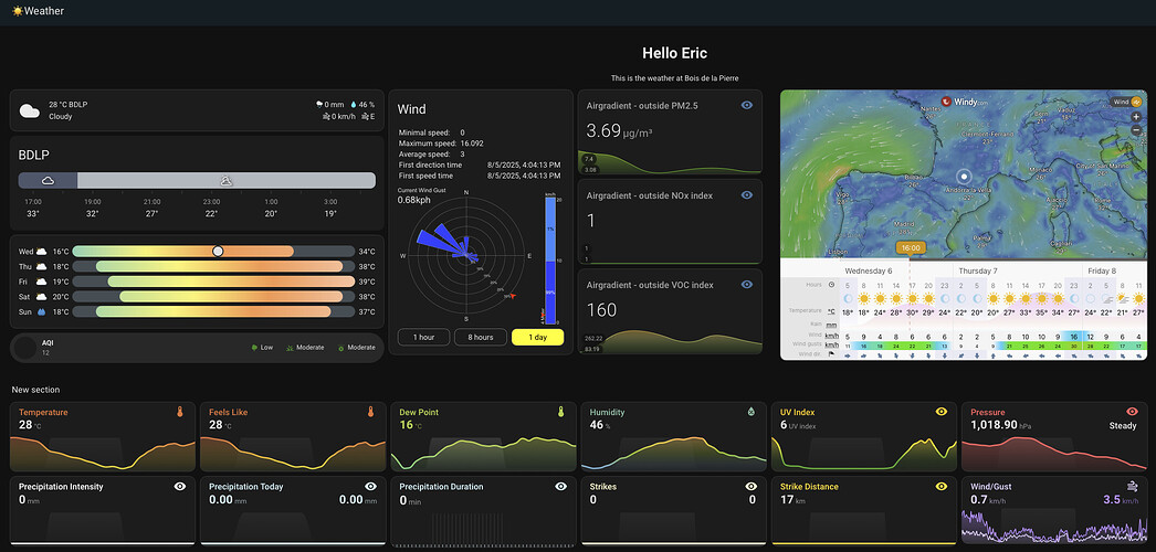

Cool. The HACS integration for WF would work great with this as a great Fully Kiosk Browser dashboard. I use a Kindle Fire 8.
(repeated thanks to @vreihen for the browser/kindle suggestions a while back)
The attached is my (non-WF) Davis VP2 MQTT + Davis AirLink REST + PurpleAir REST + Ecowitt MQTT + Zwave sensors shown via HA but the dashboard is weather station agnostic. Dropping in a WF station with the HACS integration should be trivial.
Tiles are ring-tile and button-card using decluttering card templates for clarity. The buttons turn red when the door/window is open. Pretty slick.

Hardest thing in HA for me is building a custom dashboard that isn’t too busy and passes my eye test. The one I did above is plenty good enough for displaying on a $40 Kindle Fire 8 tablet.
