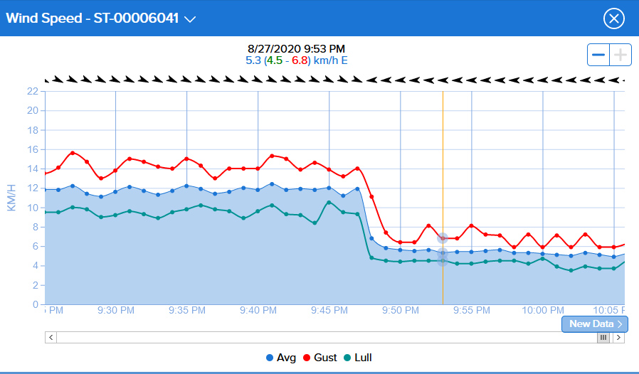

I got a tempest about 10 days ago. Wind measurements are still wrong. Today I had it in front of a fan blowing from the west (exact west). When I rotated the unit 180 degrees, the speeds drops 50% !! Is it still balancing the sensors? How long is that supposed to take? Or is it just a bad sensor.
Wind sensors should be even after a few seconds with wind from all directions. You seem to have an issue and I have forwarded it higher up :slight_smile: but a bigger wind issue is also keeping staff busy (Laura)
