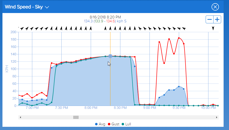

Insane Winds, that never happened
I’m not sure what happened here. Unless someone was pointing a leaf blower at my SKY. This wind event never happened.

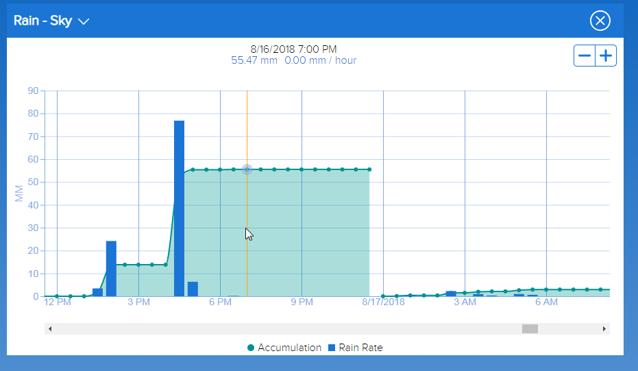

Was it raining heavily at the time? If water gets into the sonic paths of the anemometer, suspect rain readings can be created.
Not at the time this wind event happened.
Out of curiosity, are you running your Sky in battery-saver mode???
Yes I am. This is the first time I have seen this happen since my install in early June

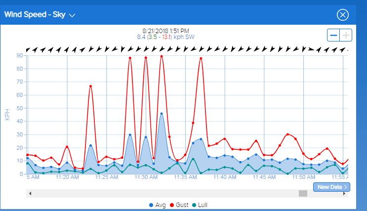

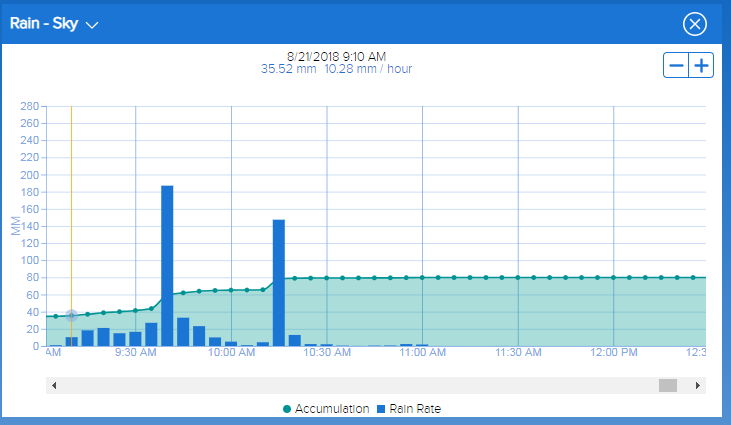

More weird spikes today with the winds… I thought maybe it was during the rain storm, but it wasn’t. Comparing to some other WU WS in the area and none reporting anything even remotely close to these speeds.
