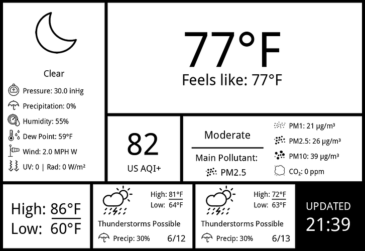

Here’s a sneak peek at the AQI screen!
After a lot of thought, I decided that I was going to combine weather and AQI into a single screen. That introduced a challenge as there just isn’t a lot of real estate on the 7.5" standard definition screen. For the 2.0 combined screen I settled on the 1200x825, 9.7inch E-Ink display from Waveshare. Much of the things I have been wanting to do with the original screen I have baked into the new.
A true Meme Mode is coded in to easily enable or disable memes based on preference. This includes IT HECKIN WIMDY, a vectored Ron Paul “IT’S HAPPENING” for Thundersnow, the Angry Sun from Mario Bros 3 world 2 when it’s miserably hot out, and a simple, yet straight forward skull and crossbones for dewpoints 76+ with a condition report of “Death”. In this global settings area, I have also simplified tokens and URL entries.
The error screen has been completely rebuilt from the ground up to be more fun. Sure, I could make that a Meme Mode item, but ideally you shouldn’t see it very often.
More importantly, there is more data. I’m a sucker for that. I now have solar metrics, 2 days of forecasts, AQI, and pollution counts (waiting on the CO2, that’s why it reads 0). Lightning, rainfall, and NWS alerts work the same as they did previously.

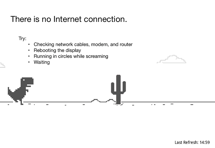

I’ve got the new version completed for the 7.5" screen. I’ve been running it for about a month to make sure I don’t run into any unforeseen issues. The new one will have a lot of the lessons learned from the 9.7" screen build integrated. Mainly, I’ve fixed quite a few logic items, the T-Rex error screen makes an appearance, easy toggle of meme-mode, and a much more clear setup at the top of the script.
