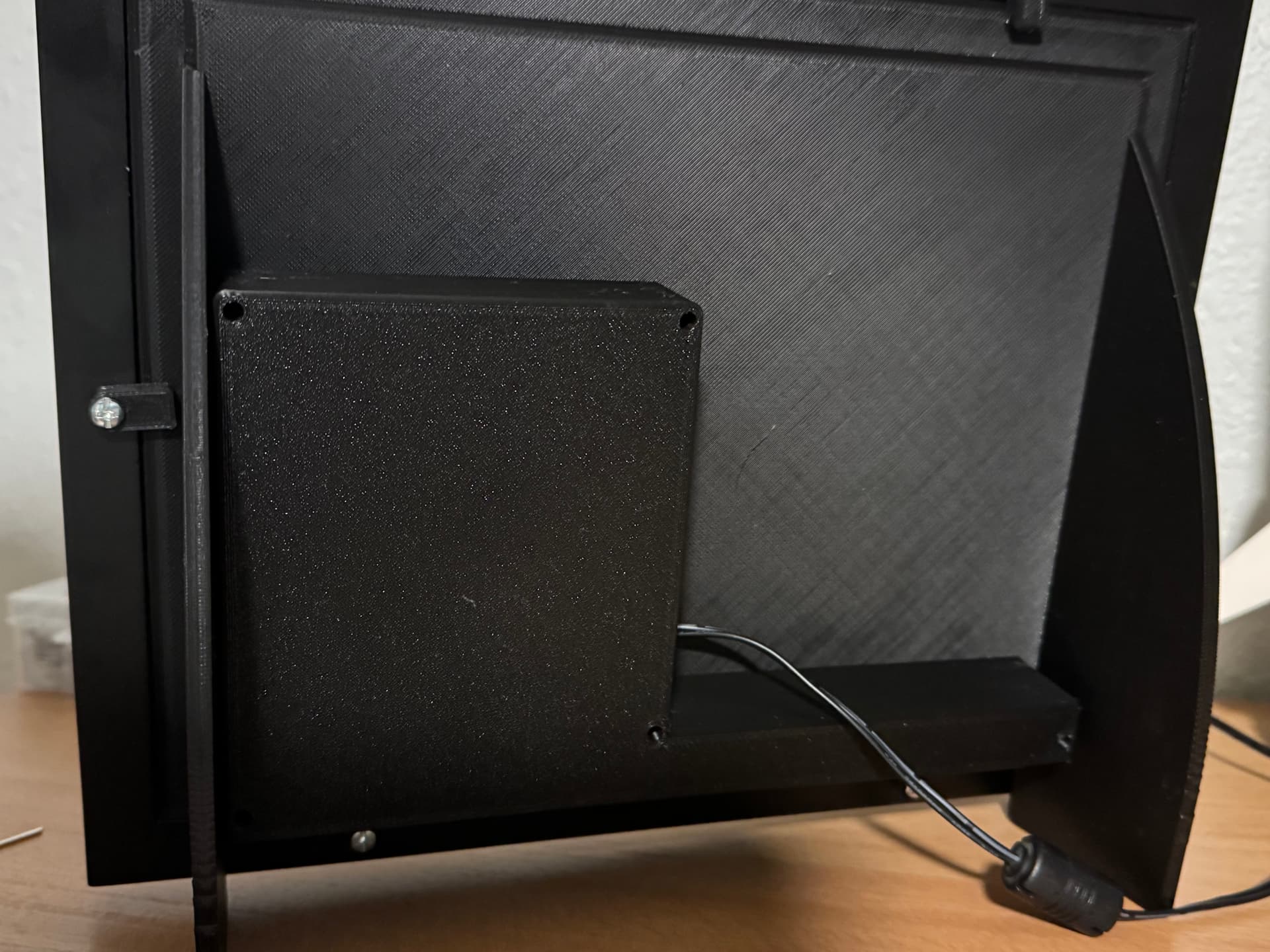

I don’t sell my work just for liability and stuff like that. However, I would definitely help answer questions along the way as I have done here. DM me and we can chat further as to not ping everyone on the thread. I’d be happy to help you through the process and provide you with an STL for the back of the frame - that STL can be printed at most libraries for a nominal fee if you do not have a 3D printer.

After months of sitting on the code, I’ve finally completed the 9.7” display that integrates IQAir AQI data. Going into this project, I expected a similar experience to the 7.5” Waveshare screen. Boy was I wrong. Challenges on this setup not only include the massive ribbon cable at the bottom of the screen, the screen offset, general fragility of the screen - but also that there are no provided Python drivers. Everything that operates this screen is in C. If any of you decide to go the route of an IT9851 driven screen, this is the key: GitHub - fittingIntelligence/IT8951_python_works: Driver for the IT8951 e-paper controller on Raspberry Pi
