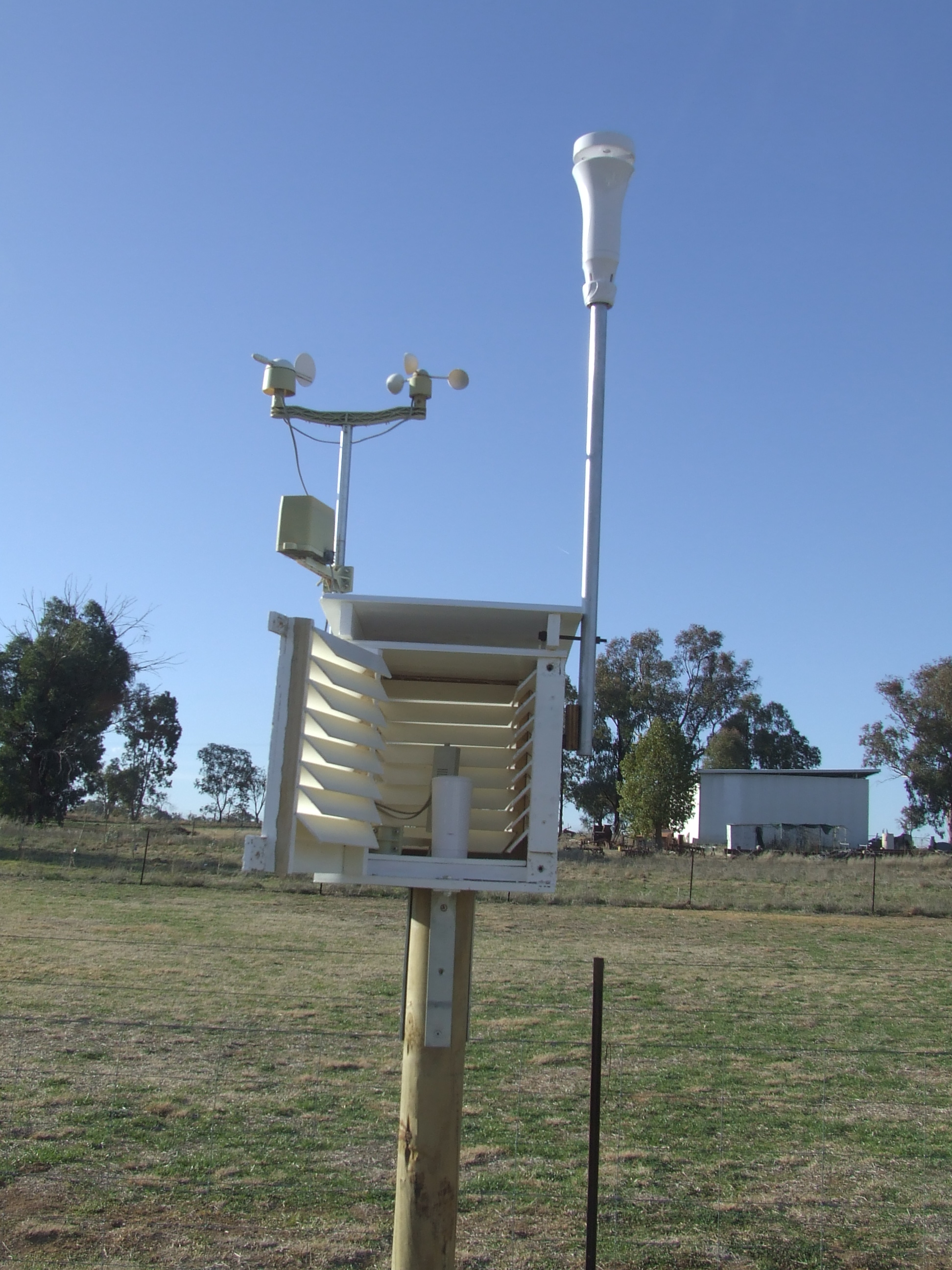

Just thought I’d post the photos of my home made Stevenson screen
Inside dimensions 30mm h x 270mm sq 1.7m off the ground
I already have a WH1080 working inside.I will be putting the Air inside and the Sky on the outside on a short pole.
scrap wood a few screws some high gloss paint, the only thing I bought was plastic angle 50mm to make the double louvers and the treated post, a few days work and its finshed.

Nice work mate!!! I am sure the AIR will be nice and comfy in there. Hope Huey sends some wet stuff your way (and ours) to test the SKY as well.

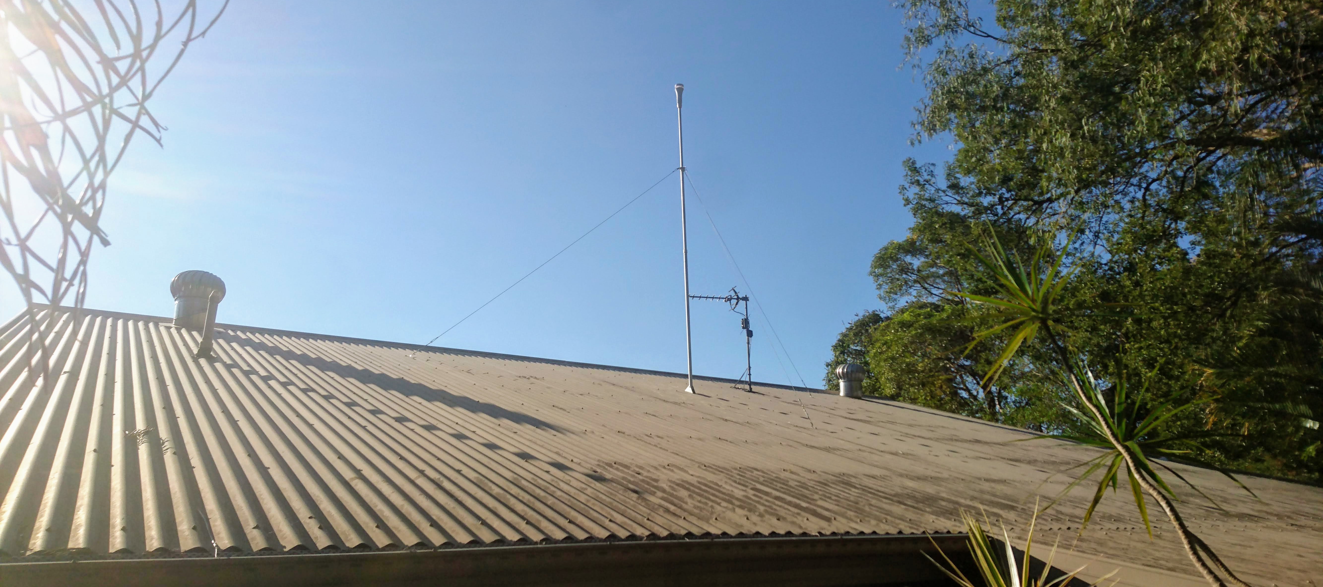

Found a 4.5m aluminium telescopic mast kit locally. I didn’t use the full height as I wanted it solid.
My equipment came this afternoon a day early. It’s now up and running. I went from unboxing to online in about 20 minutes. image image image
Before you put the ladder away, let me suggest removing the well-intentioned red streamer from the Sky’s mast. In the wind, anything flapping and connected to the mast has the potential to cause false precipitation measurements…
Thank you. I was wondering if there was a potential for it to effect my data. I just wanted a temporary visual indicator. Was planning on taking it down after a few days. Haven’t noticed any false readings as of yet.

image image image Streamer is now down. I ordered a wind sock from amazon for $7.94 which I am going to attach to my original Sky mounting location on my deck. Good thing I had to wait so long to get my Sky. I ended up constantly rethinking my mounting location and eventually went with the much better (albeit pain in the rear) location on my roof. I just like to have that visual indicator of wind activity when I look outside. image image image
Will that windsock cause vibrations and false raining detcions??
No, it won’t. Why would it?
Heres an update of the air and sky sited on the Stevenson screen alongside the WH1080
comparing the two theres not much difference except for the temperature which the 1080 is registering a higher temperature +1c. not real worried because I had a ws2310 running alongside the 1080 and the temp diff was also 1c higherDSCF2832 DSCF2834 DSCF2833 BTW Sky is 3m above ground

Thanks mate its a bit rough but I intend to do some tidying up once the weather is more sociable
