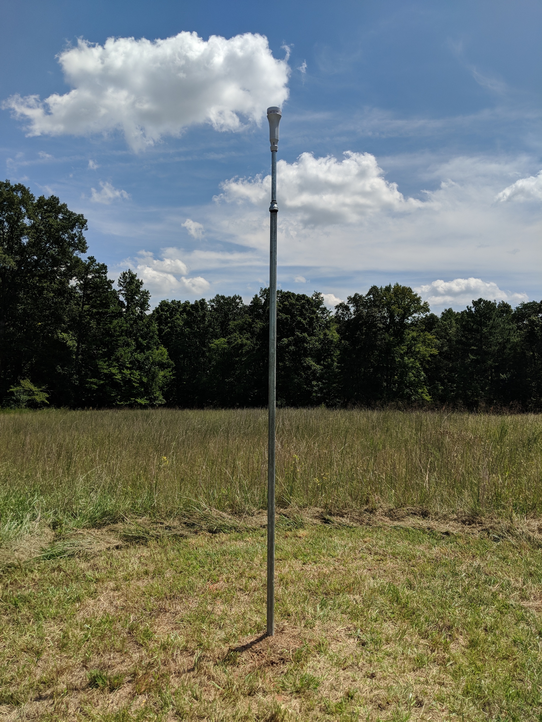

Sky: Mounted atop galvanized steel pole. 1.5 inch schedule 40. In the ground 2 feet, in concrete. 10 feet up, 1.5" to 1" reducer and another 18" of 1" schedule 40 galvanized. I did grind the tip down just a bit so the mounting bracket would fit nicely. Filled entire pole with play sand to eliminate any vibration. It’s 200 feet from the hub in clear line of sight.
What I have learned: Sky hates vibration. My first (temporary) mounting location was the side of my kids playset. Numerous false rain events, and I also noticed a higher variation in wind lull. I have only had one false rain event since mounting on galvanized. I suspect a small bird or insect, but I was not home to see it. Wind lull has stabilized on the permanent location. Also, there is a quirk on the Air and Sky both dropping from the hub and the hub turning blue (even though no app is connected via BLE). Reboot of hub fixes it. This has happened twice. There is a thread in community forum (several others experienced it as well). I also opened a support ticket, no word there yet.

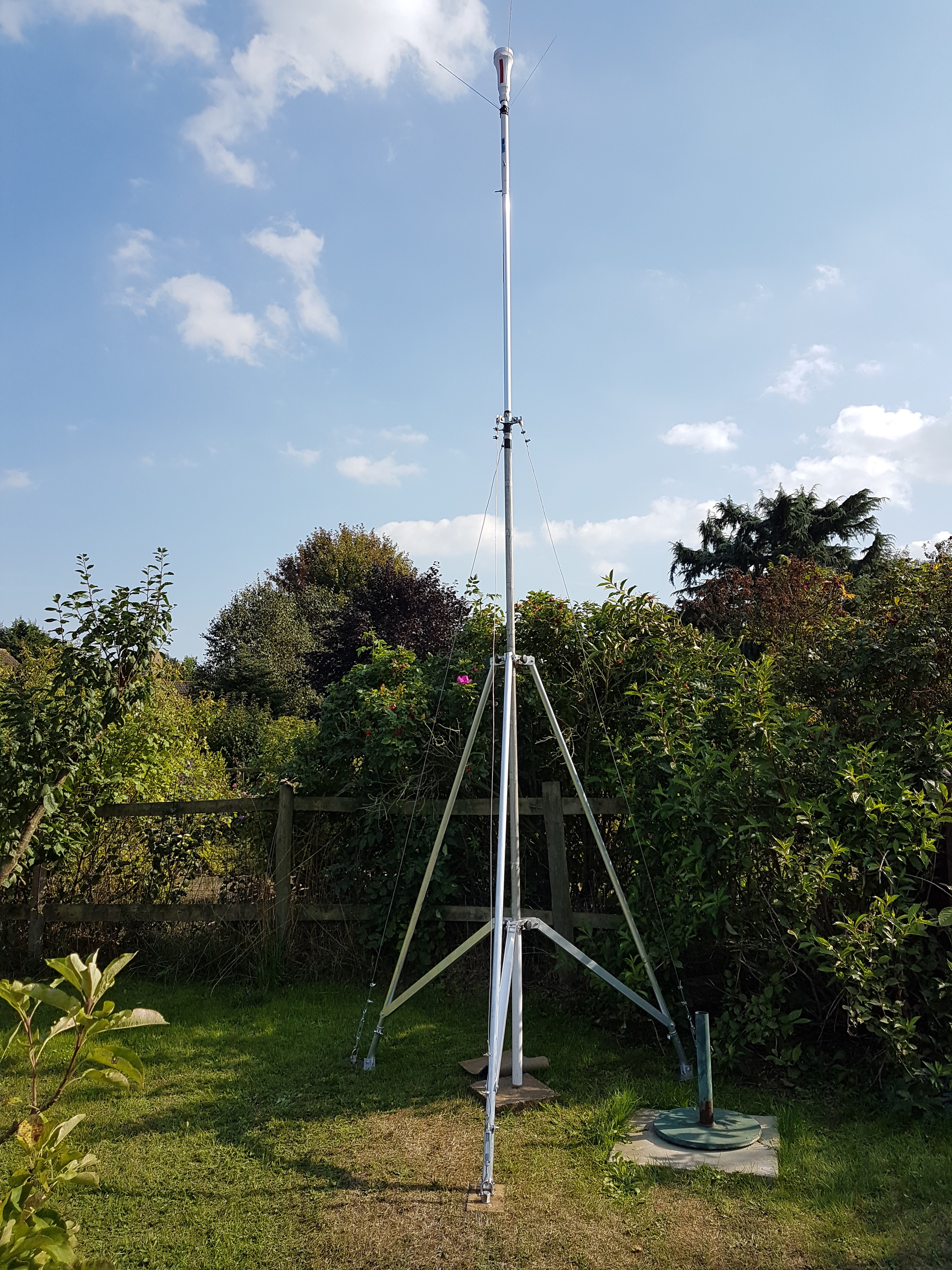

5m mast now finished and SKY appears to be rock steady. There is an air gap at the bottom of the aluminium pole so all the force is transmitted through the tripod legs. The top half of the mast above the guy wire clamp, aluminium and PVC, is filled with sand. Note the red tape marking North on SKY unit!

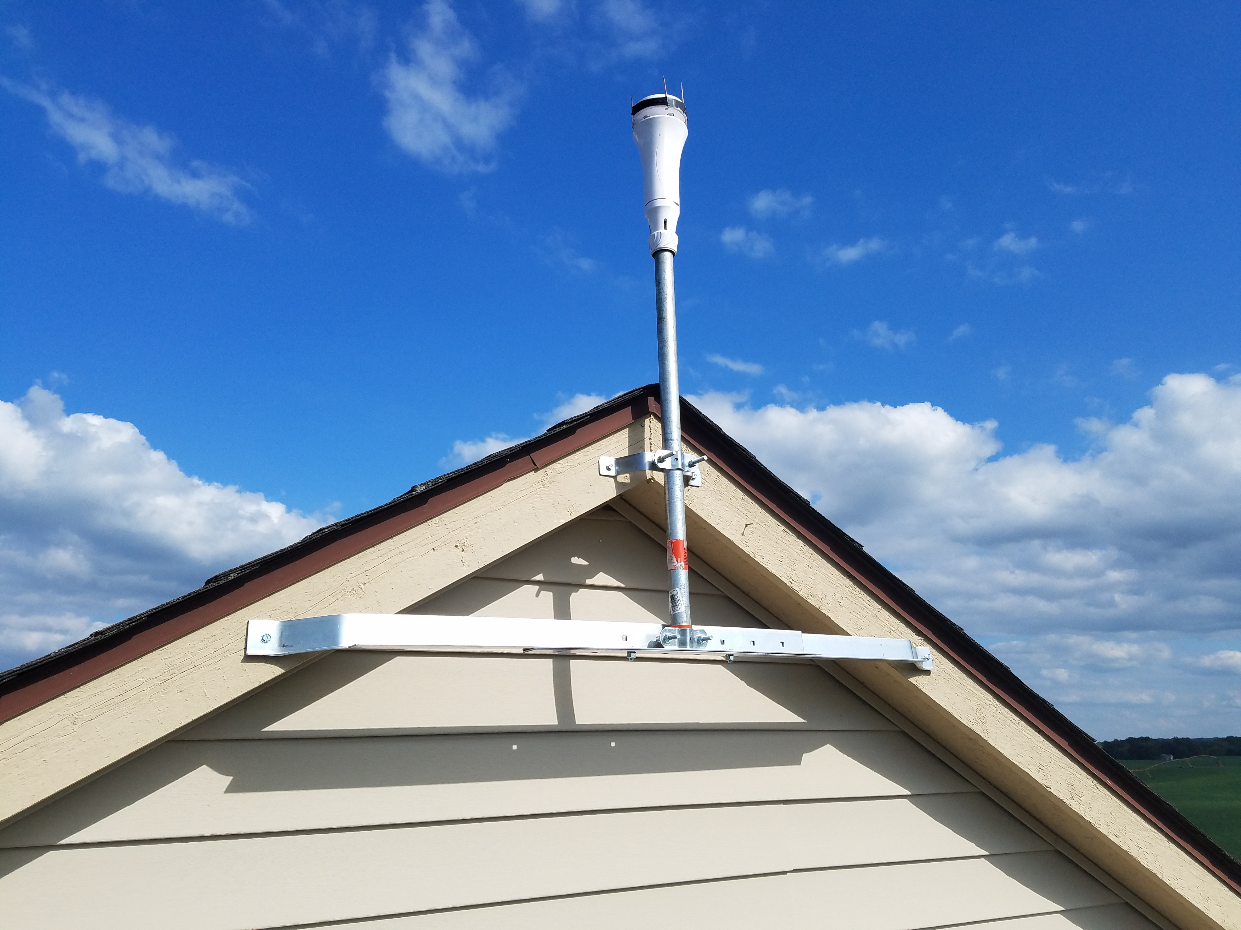

Gable mounted Sky. The roof that it is mounted on is at a high point in the area so unobstructed flow in all directions. Didn’t place it on a higher pole due to subdivision rules on antenna’s. etc.(Pole size 30 inches.) Found installing it harder than it looks having to hang over the edge of the roof. Still need to go back up and tighten one of the bolts and add some grounding protection. So far the wind readings seem to be okay but had an issue when a storm came by last evening. It appears to soak the wind sensor which dropped wind to almost nothing till it dried out. Conversely, got some really high wind gusts during the same storm as well that were fictitious.

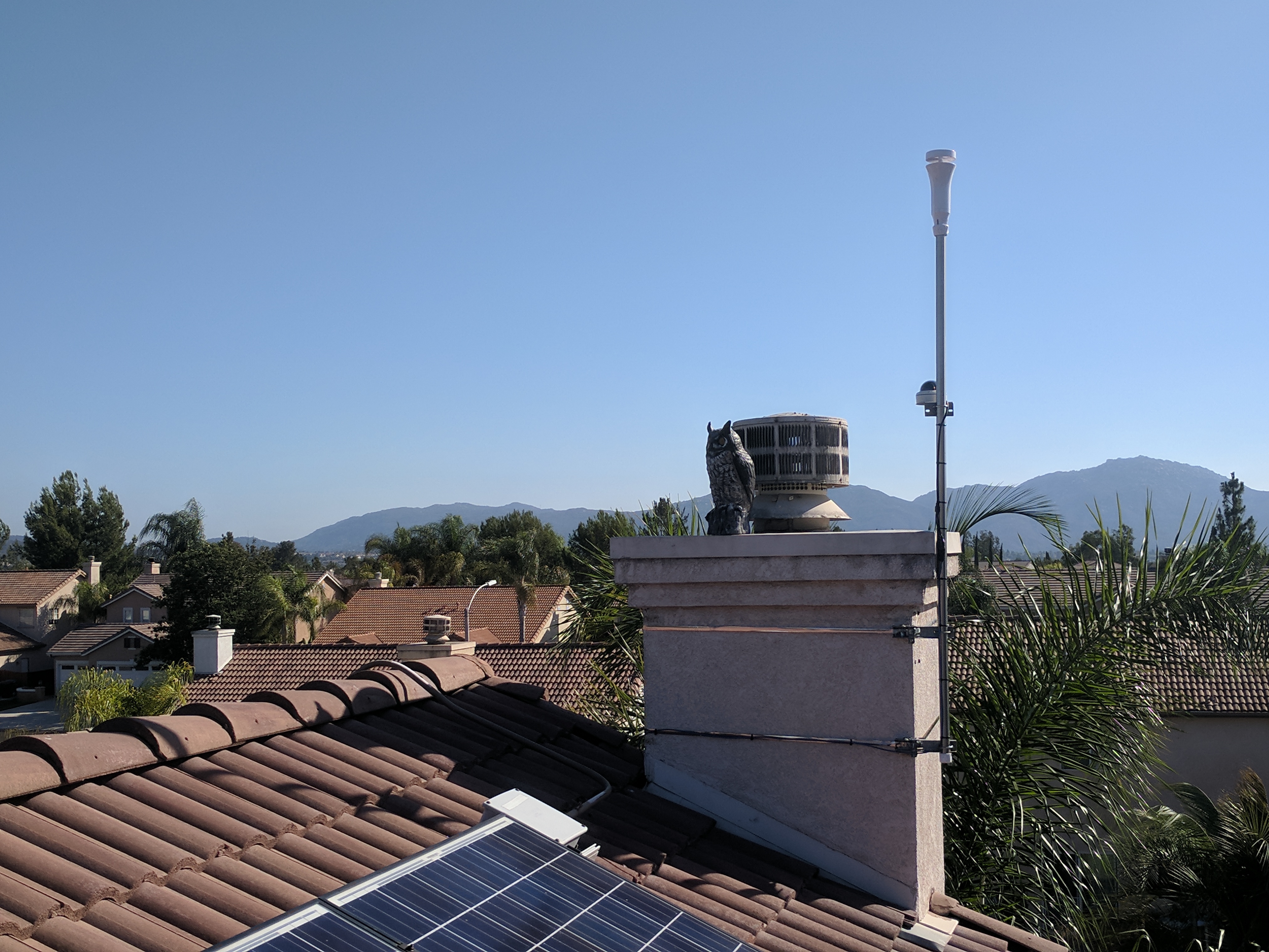

I just got done with mod 3 for my Sky mount. Initially I used a 10’ antenna mast and the antenna mounts were to the NE corner (left) and camera was mounted on roof gable.
With a 180° lens it picked up too much of the chimney so I moved it up onto the mast and shortened the mast to 7’ so I could get the Sky off for battery changes w/o taking mast down and put a bunch of CDs on top of chimney in hopes of deterring birds. Bird landings continue and the new length created vibrations in 18-20mph gusts that triggered false rain even though I also added neoprene between the mast and sky mount and the camera clamped to mast should also dampen vibrations.
Part of the reason for shortening the mast was to give the HOA less of a reason to have issue but moving to the NE corner would also make it appear to not stick up as high so I relocated the mounts. I also picked up a Nicole satin finish 6’ rod (they also had 8’ and chrome but I figured 6’ would be enough) thinking it would look nicer (HOA) and maybe help with birds (maybe chrome would be better). I filled it with glass bead (because I had it on hand and didn’t want to buy a bunch of sand with no other use) after finishing install I gave it a good tap and no false rain so looks good so far. I stuck a plastic owl up there to see if that will help with the birds.

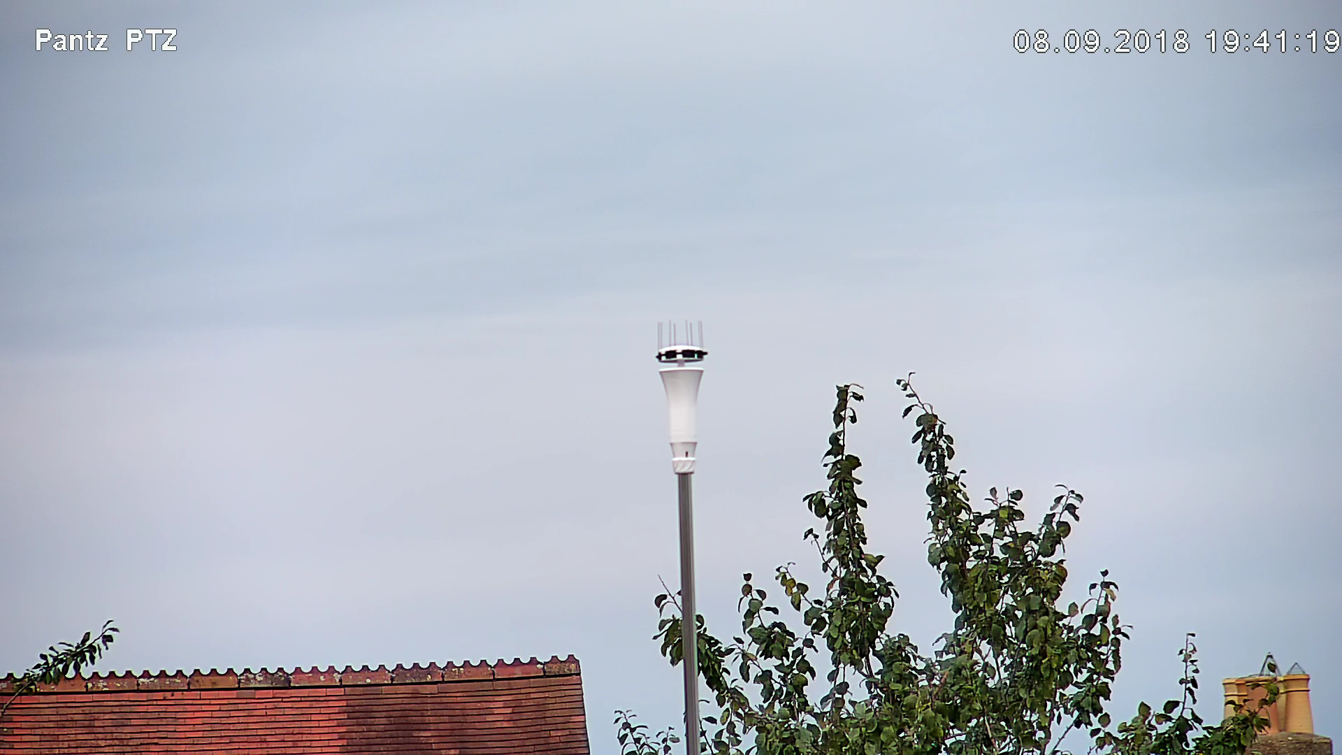

I’ve finally moved my Sky unit to my new pole - 5.5m above ground level now. I installed some Davis bird spikes to it, as I had a spare packet of them lying around.
I took the pic by zooming in on my PTZ camera. :smiley:
I recorded 106mm of rain whilst putting that up.
