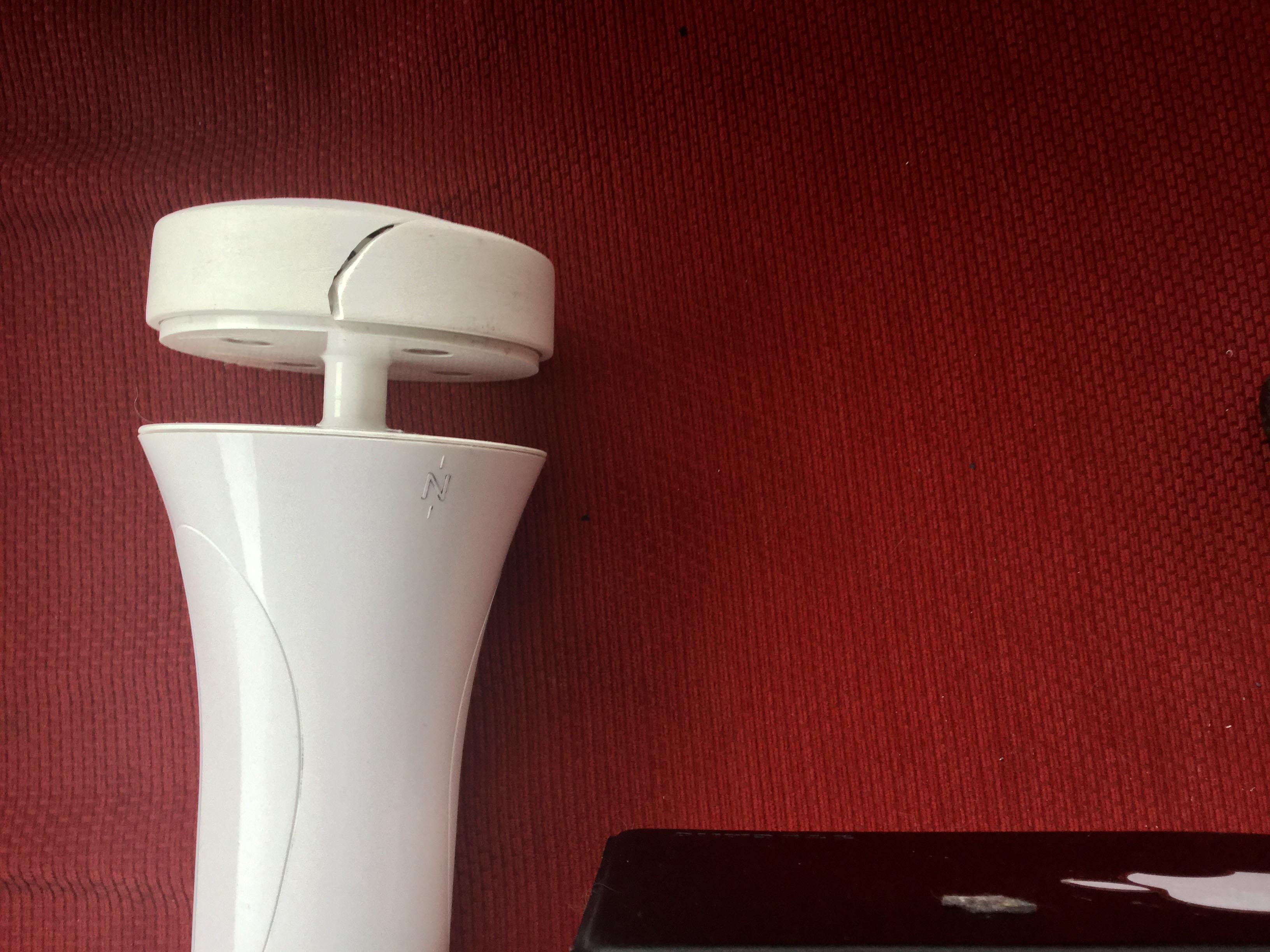

i lost my first sky unit version 1 in january which was a battery eater slipping on tiles changing batteries it fell 80ft into the car park and completely cracked the whole head unit . seen below
