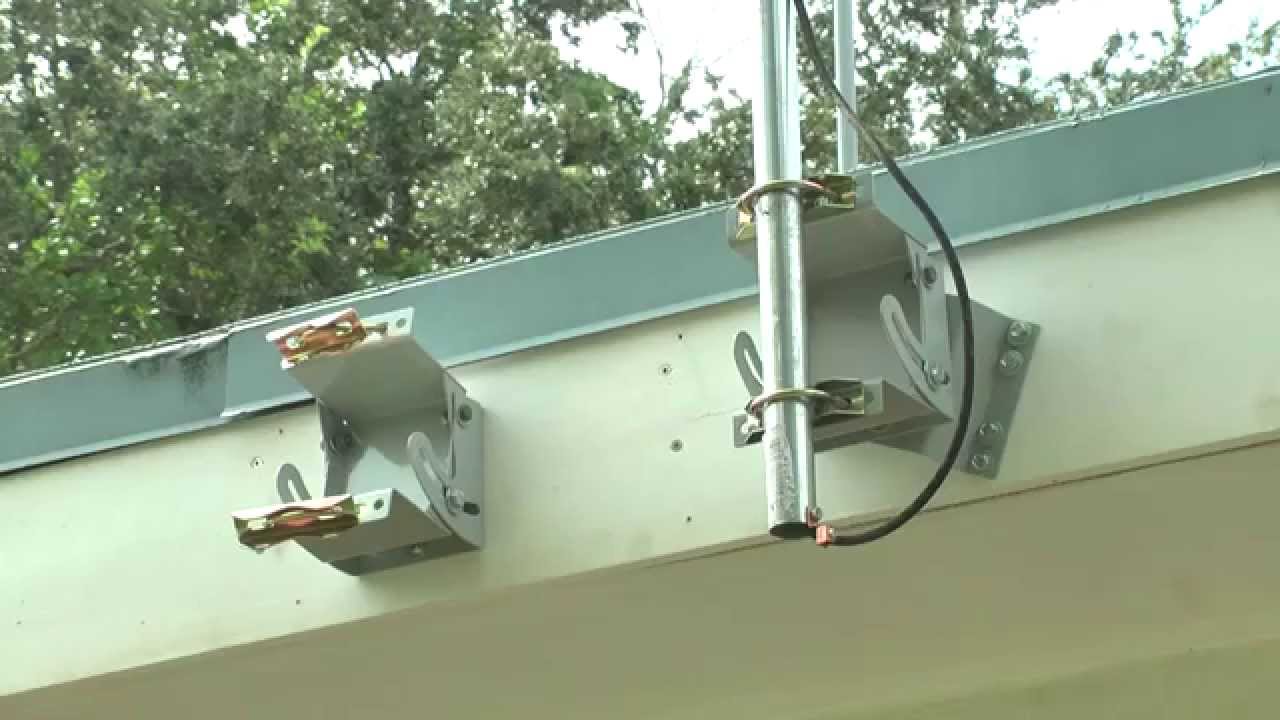

I’m certainly hoping something like that mount will do the trick, as attaching the pole to my fascia boards is just about the only real option I have. Do you think I’d have better luck with something like the item shown in this video?
