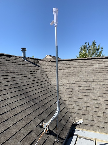

I have my Sky on a swingdown antenna mount on the edge of roof peak. https://www.amazon.com/Antenna-Mount-Adjustable-Universal-Installation/dp/B07PXK78MT
The little wire at the base of the pole has a slipknot that I put over the Sky before I service it to prevent (another) slide down the roof to an unyielding concrete driveway.

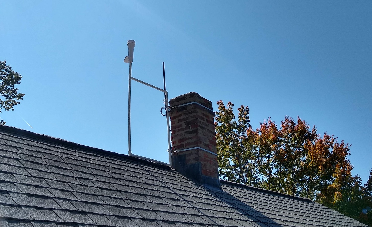

Secured to the chimney but also offset a couple feet to avoid exhaust interference. Added an ADS-B antenna while I was up there because I’m a dork about more than just weather. :slight_smile:
