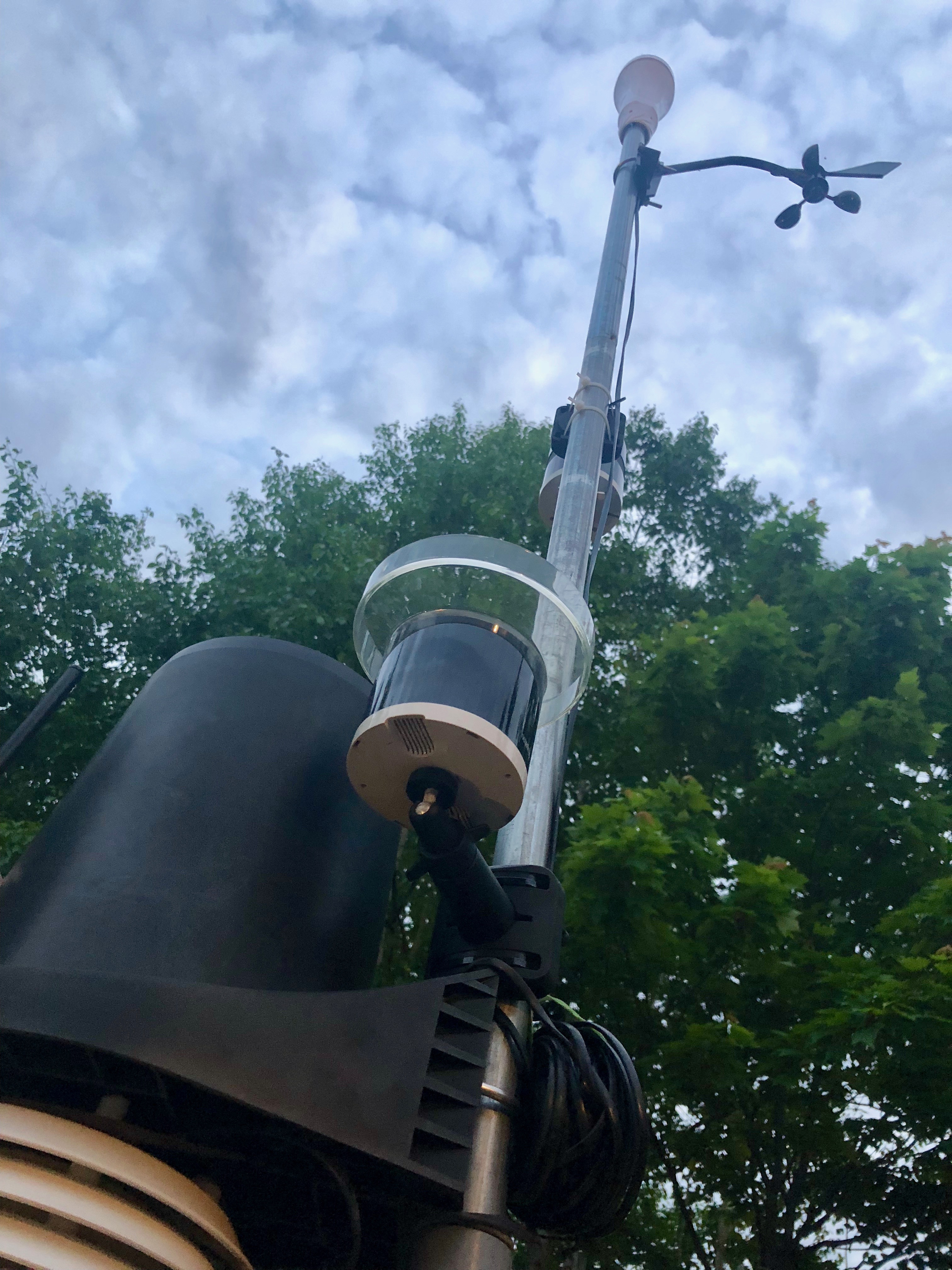

Multiple gens here. Old Davis equipment at bottom (still solid and working), iffy NetAtmo rain, and shiny new white Sky crowning the top. Gotta love WeatherFlow - style and precision. IMG_1096
Looks like you have everything covered! Can’t just have one station, I will have 3 when my WF gets here! Their kind of addicting! Thanks for the photo.
Wow sounds like you’re building a space station there lol.
@todayweather4, looks to me that he simply piggybacked a new pole for the Sky onto an existing antenna rig. Simple but effective. :slight_smile:

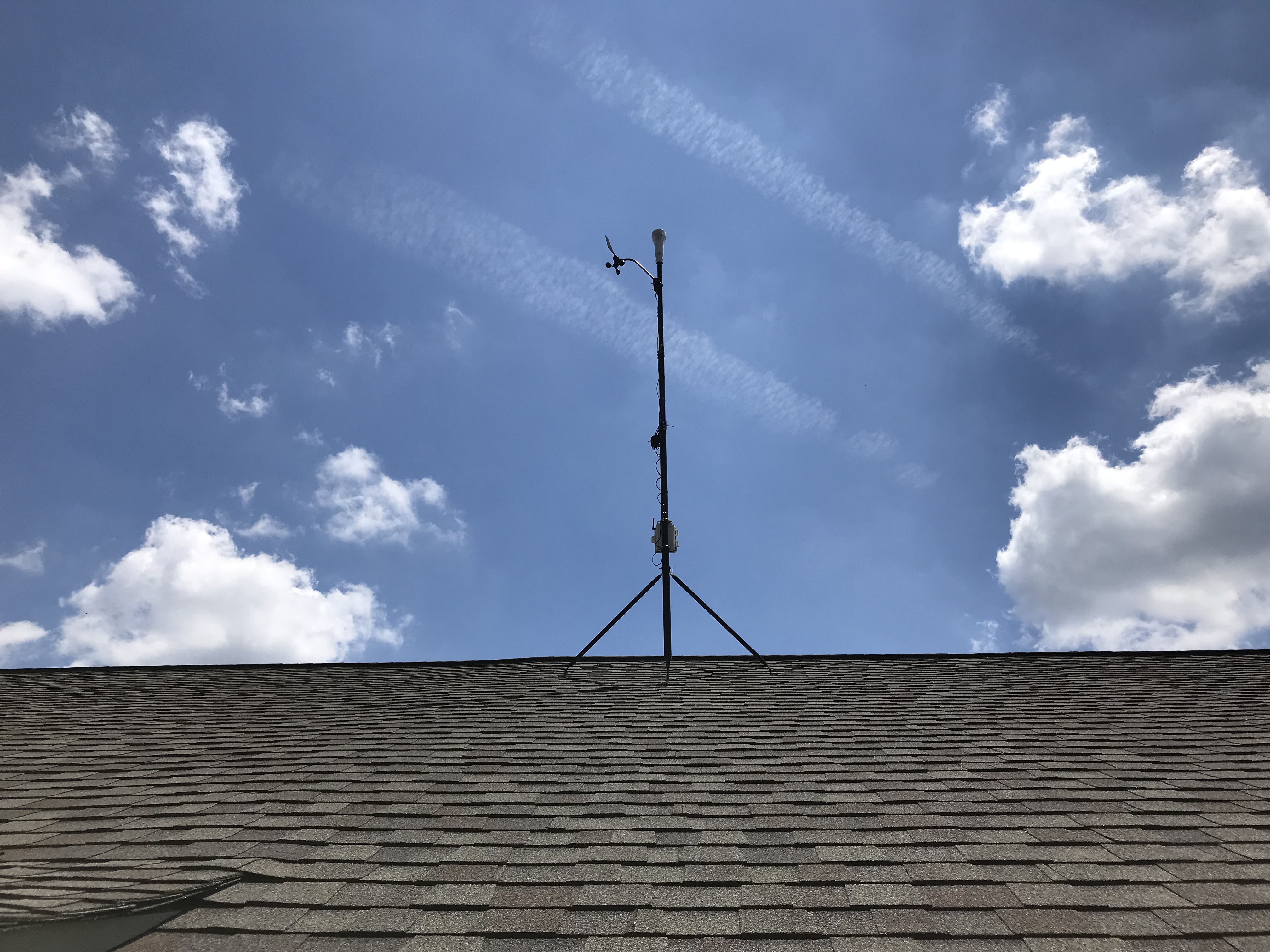

The sky is mounted on a straight pole, which in turn is mounted to my existing TV aerial. Existing aerial was a tripod mount. I’ve got a photo of the original tv aerial pre sky install earlier in the thread.

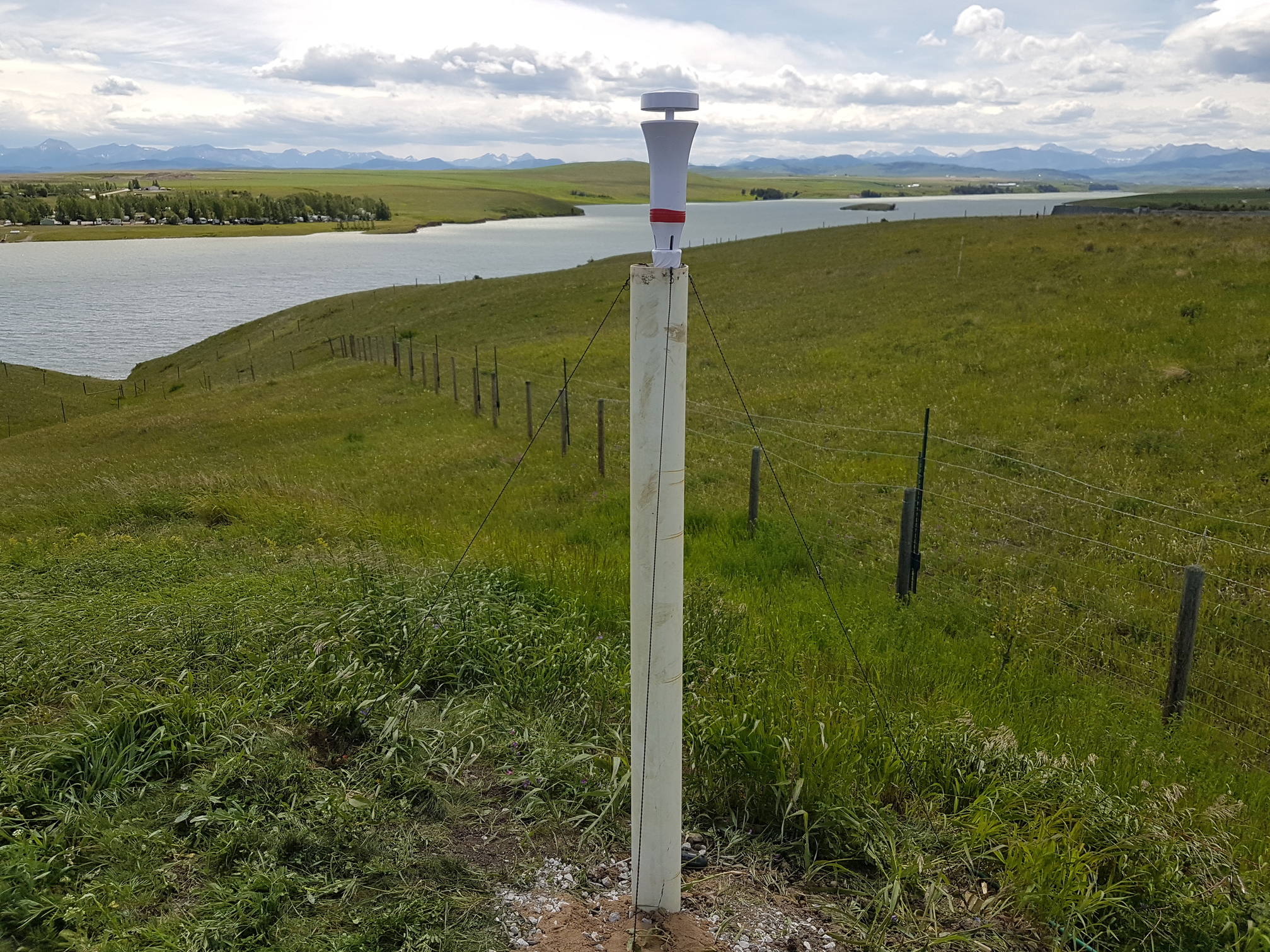

Well one week gone and things have run very smoothly, with a number of fronts rolling through. Although I haven’t double checked the volume of rain, it seems reasonable. As far as I can tell I’ve had no instances of false rain readings. In fact on a couple of occasions I received a message saying it had started raining and I needed to check that it had, very light drops had triggered the sensor.
@Weather34 mentioned filling the pipe with sand. I think I may have lucked out in that my steel pipe is thick walled and when I inserted my Sched 40 PVC I made sure that it was jammed down so that the base of the pipe was touching the curve in the pipe and the duct tape made a snug fit approx. 15" up the tube, which has resulted in no known false signals.
The next test will be with higher winds but may have to wait until the fall for this.
Overall very pleased with my Sky and Air (station ID 2202).
20180613_150845Here’s my install. Was having issues with false rain. It’s a ten foot 1 inch diameter steel pole driven into the ground encased by a 4 inch PVC tube. Each filled with sand and three guy wires. No issues so far with wind up to 60km. It is five feet above the hill and about twenty feet up above the property with the hill helping. It is sited on a spot that best matches the wind speed on the lake so I know when to go windsurfing.

@wadegrandoni do you really need the guy wires for such a low installation? I would think that guy wires would come in handy with something over 10’ or so, but 5’?
Great location, BTW.
it does not need a guy wires but it will be better if you provide it. more secure means more stability.
The false rain seems to have been fixed only with the addition of the guy wires.
