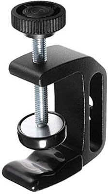

That part is the beam clamp, which could be substituted with any L bracket.
I’m afraid homedepot is localised and we can’t see in Europe the website.
@radex13
voilà donc l’image, c’est un clamp avec filetage
Dommage, la pièce est vraiment bien.
Merci pour toutes vos informations.
Il faut que je trouve l’équivalent pour la France
un truc dans ce style
It’s about 33". The top of the Tempest stands about 6 and a half feet from base of the mount.
The clamp part of that beam clamp isn’t needed, I’m just using it as an L bracket. This would work just as well:

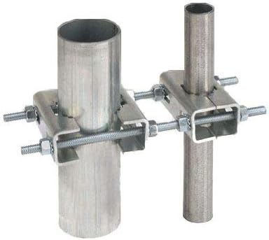

Anyone try one of these yet? Think its steady enough to work?
I have an existing flag pole. Any reason I couldn’t use something like this to mount my tempest. Two brackets and a pole about half the height up the flag pole?
I wouldn’t think the flag flying would create too much vibration. Thoughts?
even tapping the mast might introduce false lightning (at least that was the case with previous design). So I would avoid any construction that introduces vibration, but you could always try.
Edit: false rain, of course.
I would try that unless you require accurate rain readings in which case I would include a piece of rubber around both poles where the bracket clamps together and sand in the Tempest pole.
These comparisons are with Sky devices which do suffer more vibration issues compared to the Tempest because the Sky has less internal vibration resistance. The Tempest has an internal vibration barrier which the Sky does not.
