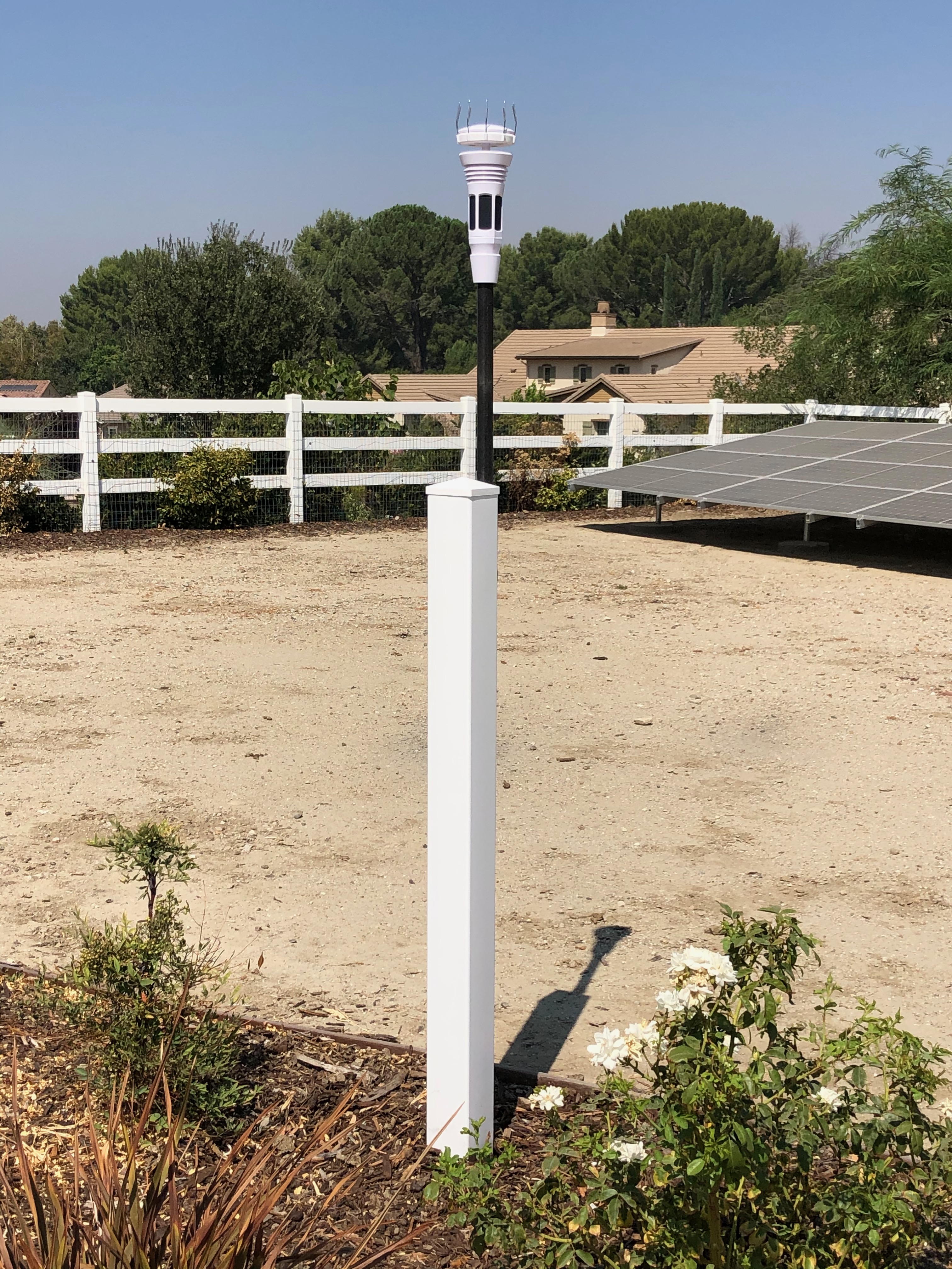

Concrete filled vinyl fence post with 1.3" OD carbon fiber tube. #2 1.25" electrical conduit standoff clamps are used to hold the tubing to the post. The top of the Tempest sit at just over 7’.
Backside view.
A simple installation that is effective, great looking, and a big plus is easy to get to for maintenance. Superb view!
