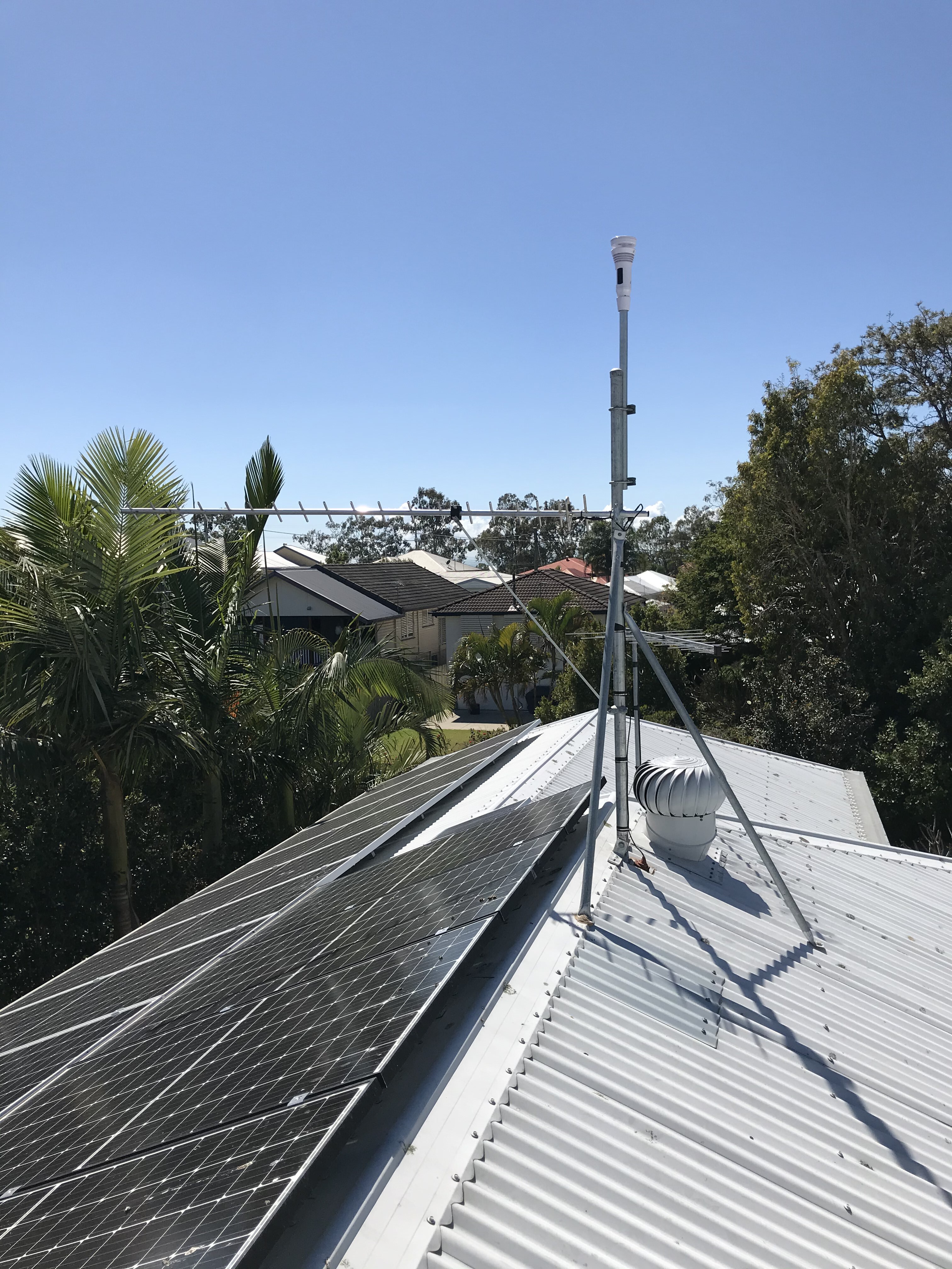

You need to have the Tempest higher 100%. Check the siting page, consider the ground your roof for your application.
This is my set up, bracing and sturdy pole and I have no vibration issues.

As much as I’d love to, I live in a complex and HOA will probably kill me if I put up an installation like yours.
BTW, love your solar panels.
