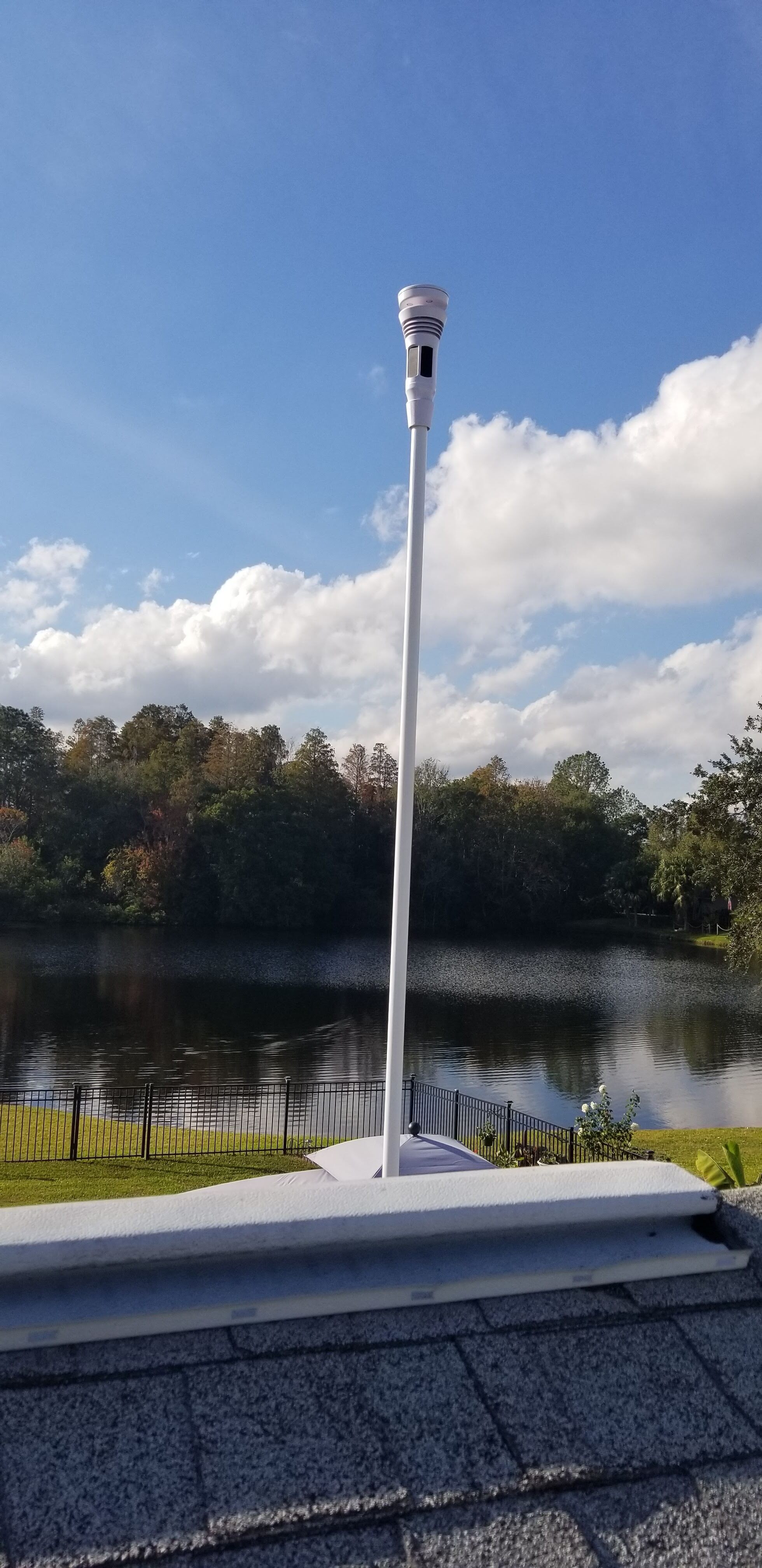

Received my Tempest on Monday Dec. 7th (Retirement & Christmas gift to myself!) :grinning: Finally got it installed this afternoon here in Tampa, FL… Set up was extremely easy & painless!! I went with the white closet rod from Lowe’s that has been mentioned here & mounted to the vent pipe…very sturdy. Here is my station link https://tempestwx.com/station/34786 Looks great…Thanks
