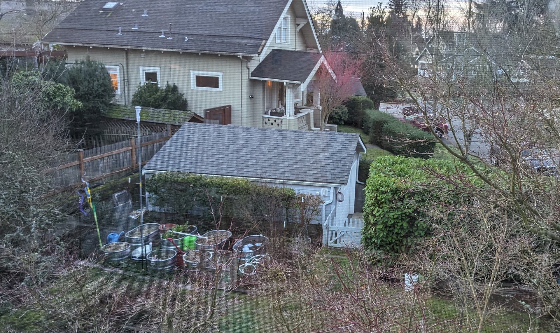

I moved my site this morning - nearby oak tree was beginning to impact both wind and rainfall. Here is the new location.

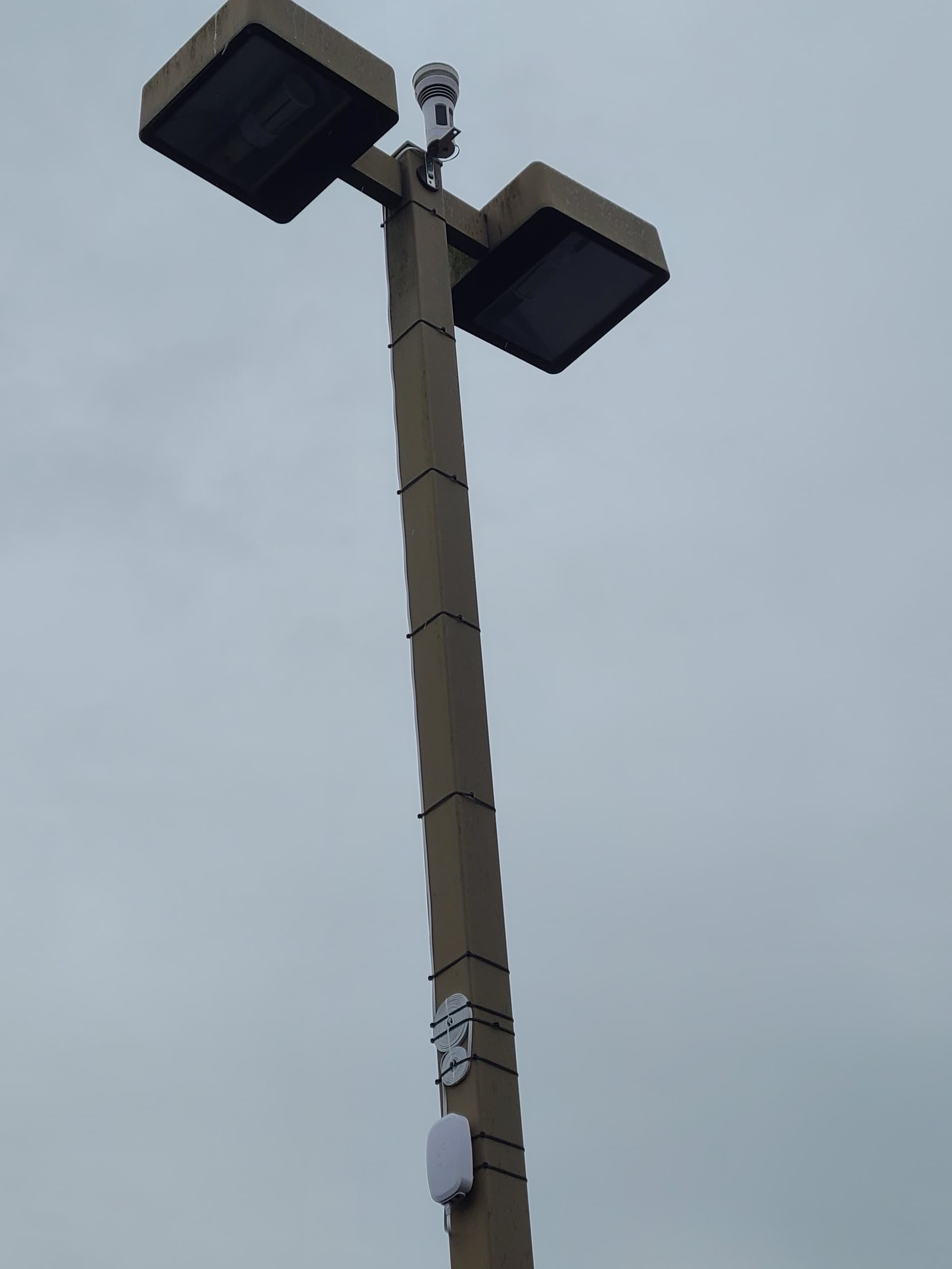

Here is one I just installed at my church.

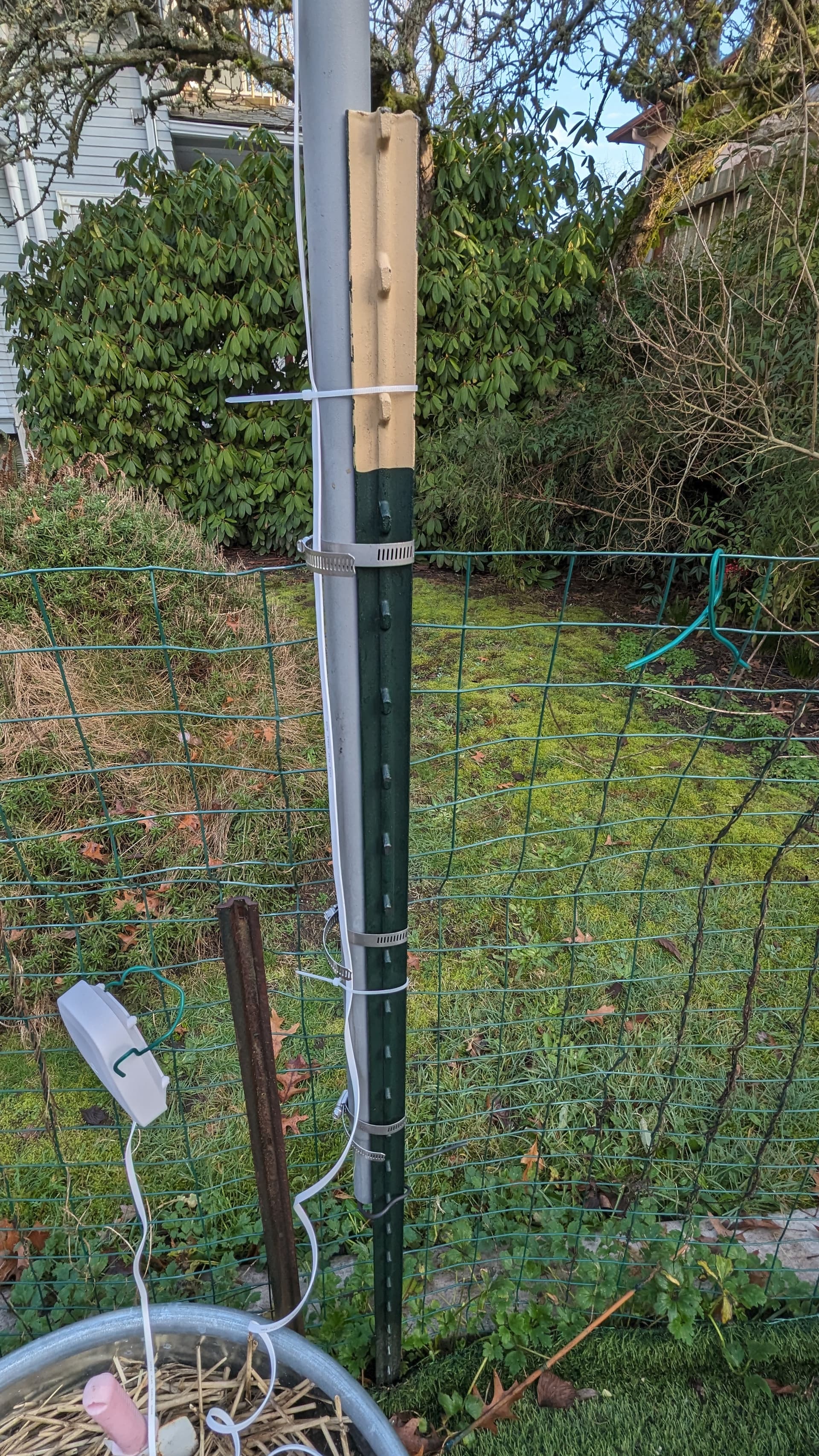

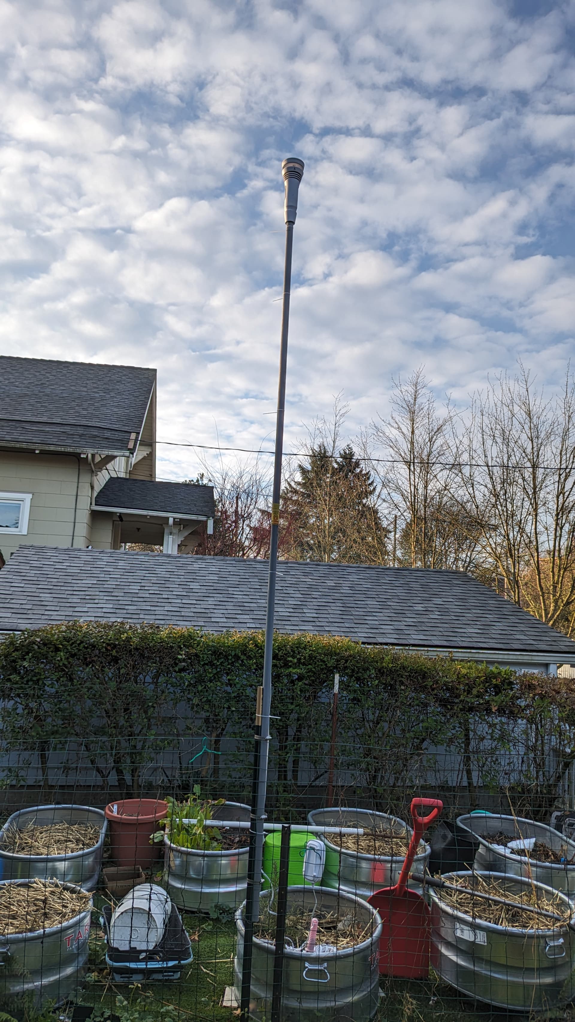

Okay, dielectric grease applied. Pole mounted - ten foot antenna mast i had just lying around.
But what have you folks done with all the extra wire from station to battery compartment? I probably have at least ten feet more than needed. Just coil it up?
Thanks.
Yes, just like I did in the photo I shared earlier. For a round pole, just zip tie the coil so it doesn’t fall apart and zip tie that to the pole. If you put the loop above the battery box, make sure there is a drip loop under it so water doesn’t just flow down to the connector.

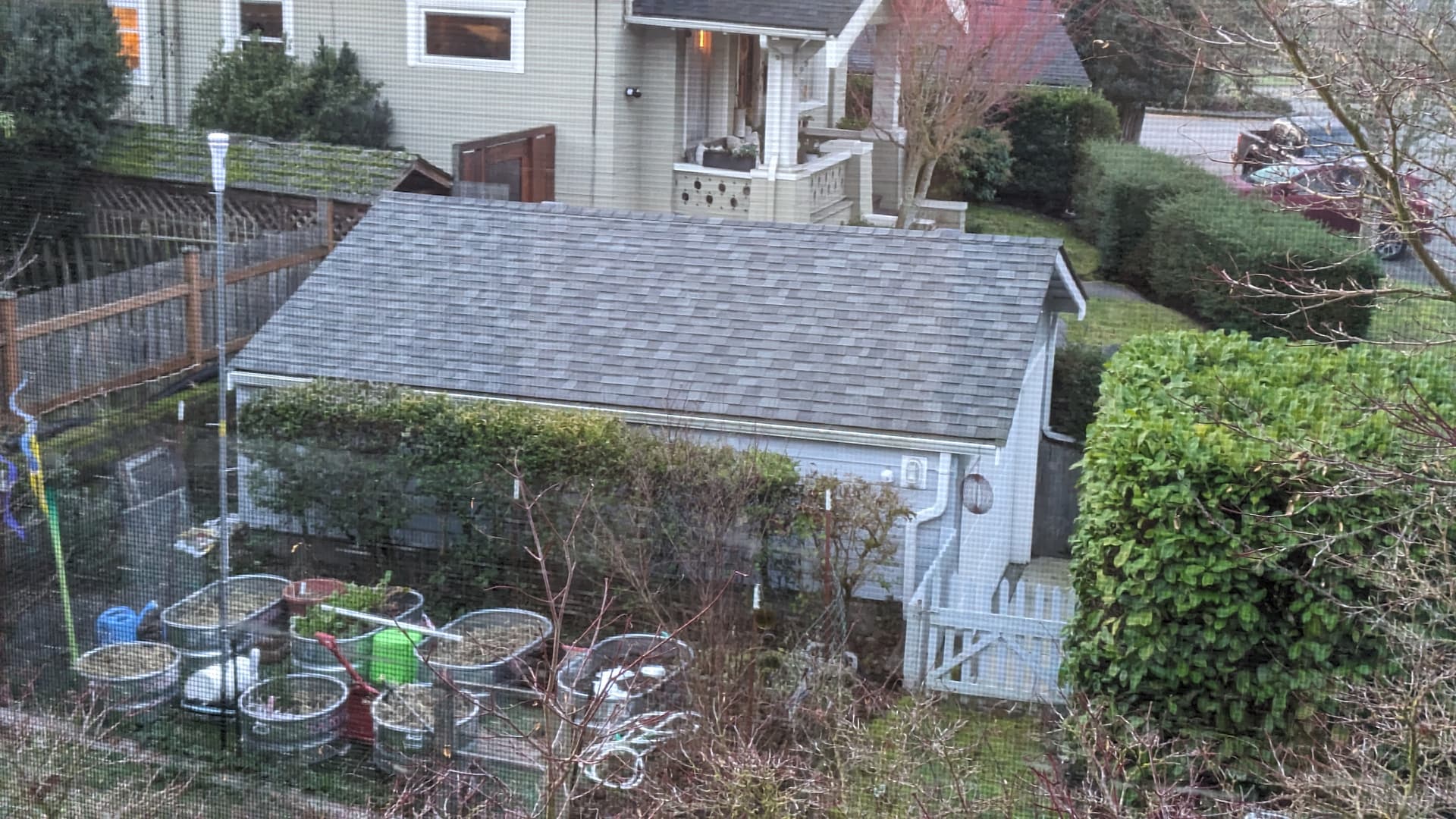

Thankfully, the pacific northWET is having some dry weather so I can tweak more tomorrow.
In any event I may have to take it down since I realized when coming back inside about an hour later, I forgot to install the Bird Dissuader! :rofl:

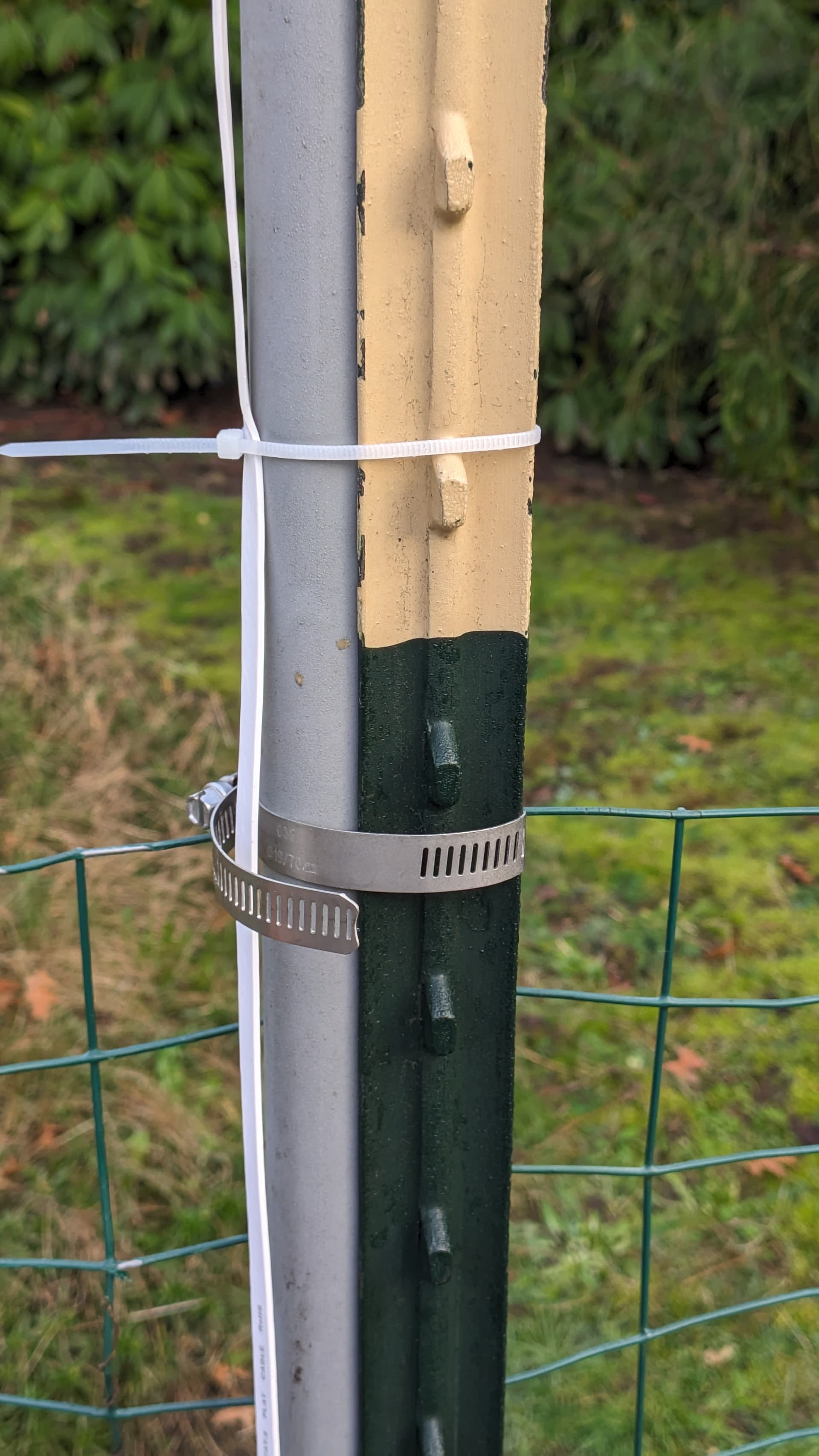

Here’s how I set up the Tempest in my yard. I used a fence post that has nubbins and then used hose clamps to attach an antenna mast to that fence post. Seems pretty sturdy. I did neglect to attach the bird deflector so might have to redo the setup. I still have to coil the wire and hang the battery compartment near the bottom.
