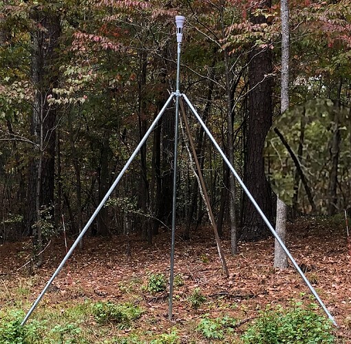

The best-kept secret in weather station masts, available in the fencing aisle at Home Depot:
https://www.homedepot.com/p/Everbilt-Chain-Link-Fence-1-3-8-in-Diameter-x-10-ft-Long-17-Gauge-Thick-Galvanized-Steel-Top-Rail-Post-328913DPTEB/312373065
If you buy 4 of them and some other miscellaneous fencing hardware, you can improvise a 10-foot tall semi-portable tripod in the middle of the woods with nothing more than two pairs of pliers and no digging:
my money is on a squirrel or ten :slight_smile:
The snakes eat them up…
