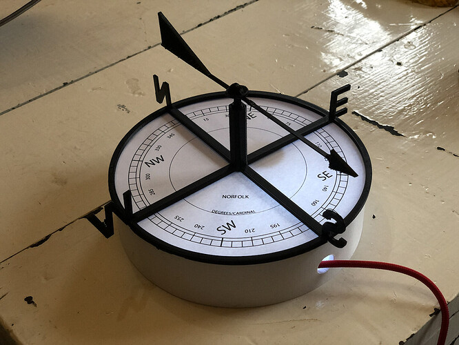

Adding in the 3D Printed Wind Vane…
Its just printing at the moment so this is a render - I thought it would be nice to have a physical wind vane indoors… (maybe its just me…)
Andy
You sure do have quite the Electronic talent! All of your instruments look Great!
I could see optional pointers that would sit vertically like real wind vanes. Horses, fish, eagles, carriages, roosters, etc. Time to fire up that 3D printer :slight_smile:
Here is the working version - i have made it so the pointers can be changed - horses, fish, eagles, rooster etc just testing it now but its the same movement as the dials so it should just work :slight_smile:
